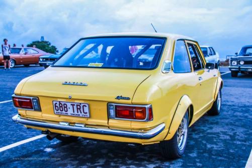

I recently aquired a 74 KE20 to use as my primary track car while I finish a few other projects.
It has already been extensively modified and mod plated for everything which is the reason I bought this particular car.
The build specs as I bought it were:
3TC Bored and Stroked close to 2L
TRD cam, twin webers, fixed timing dizzy
T50 with trd close ratio gearset
RX2 with mazworks LSD, 4 wheel discs, hydraulic handbrake
6 Point cage, seam welding, buckets and harnesses
Rays 3pc meshies
Mod plated for all of the above in QLD in '95

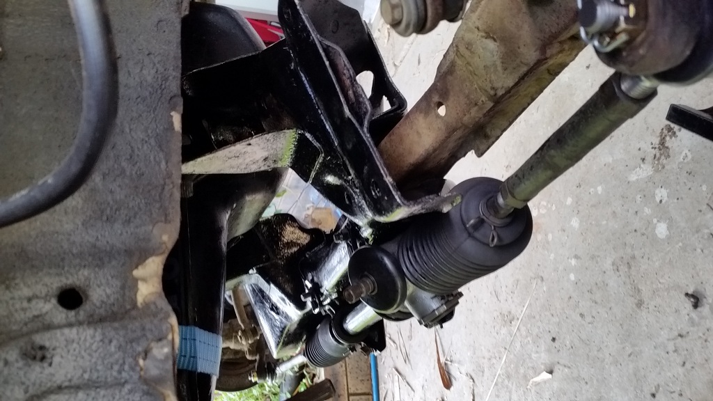

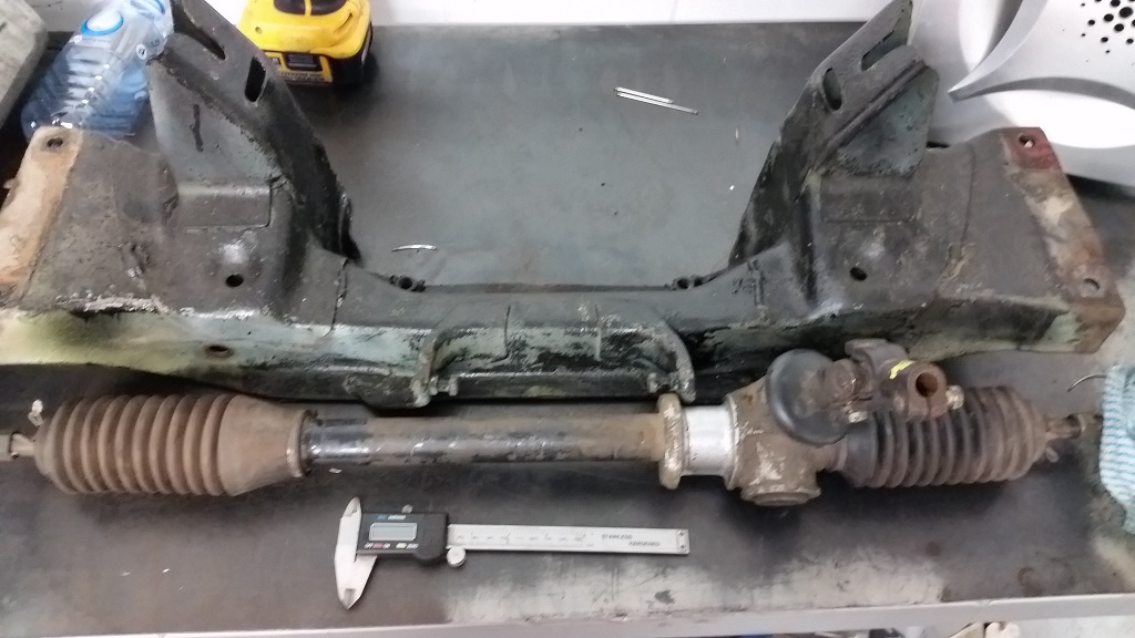

I replaced the whole steering setup with KE70 rack and pinion

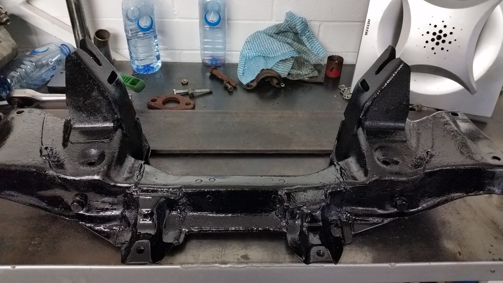

KE70 rack, KE20 crossmember:

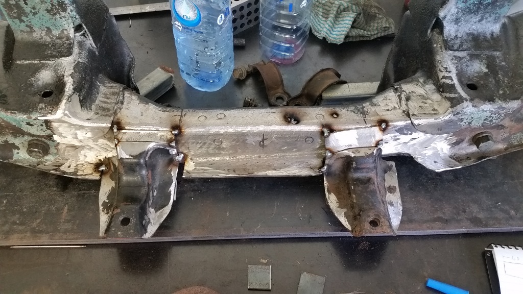

KE70 rack mounts grafted onto ke20 crossmember:
Finished:
KE70 rack mated to KE20 outter tierods and sleeves:

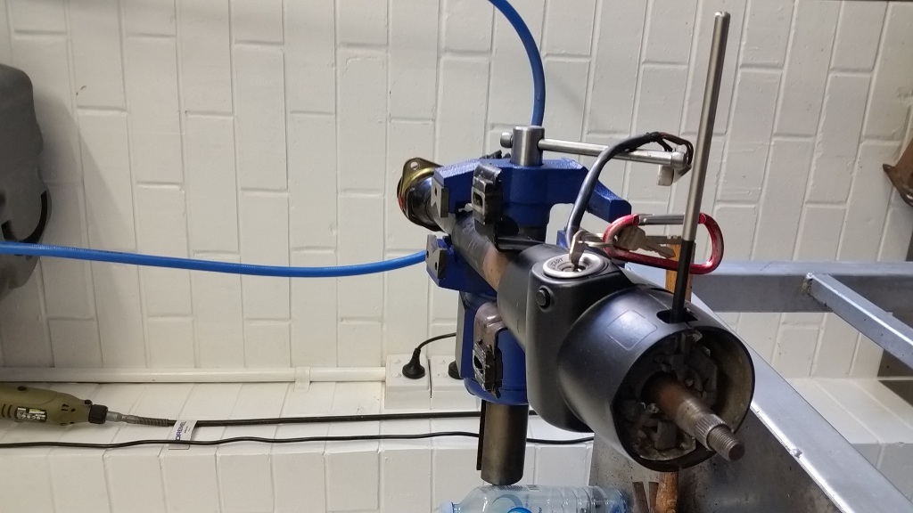

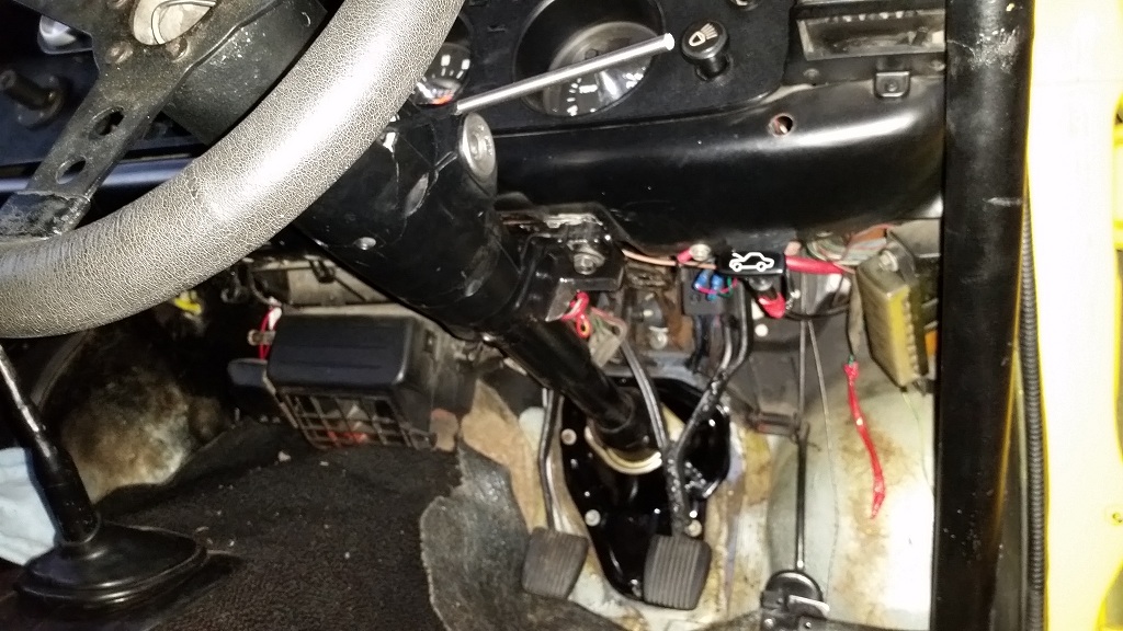

KE20 Ignition housing and steering shaft top bearing housing mated to ke70 column:
Grafted the 70s firewall mount to the 20, standard 70 column mounted directly to the 20s dash.
It does sit too much to tye left by about 1 - 1.5"

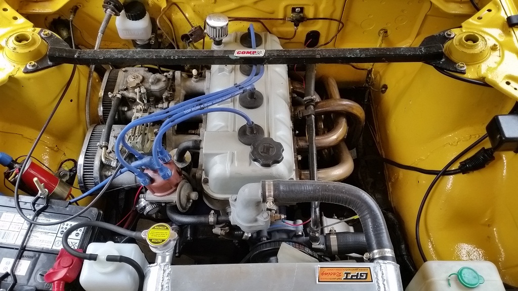

I bought the headers 2nd hand, apparently the manifold flange had been 'modified for clearance' for what I don't know. I chopped the outlet flange off and welded a V band on. I had to massage the floor pan for clearance. Modified my gbox xmember to allow a 2.5" pipe to pass through it. Trying to keep the exhaust tucked up high.
