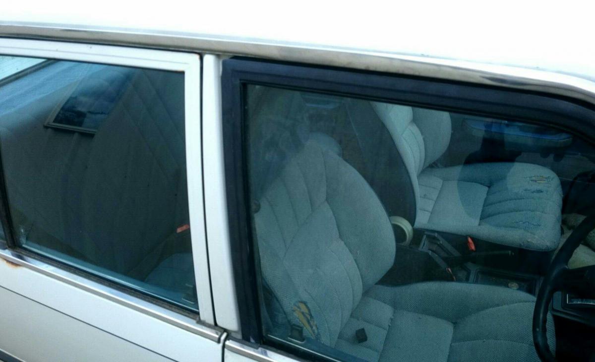

Interior: Vinyl Back seats, Front Cotton ripped so got sheep skin covers on them now has bucket seat for driver and AE86 ADM passenger seat

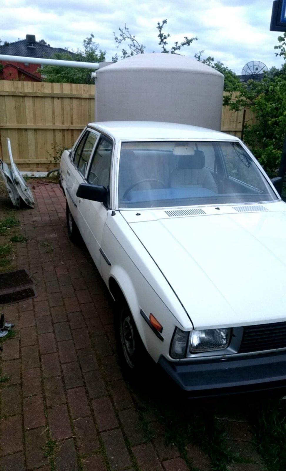

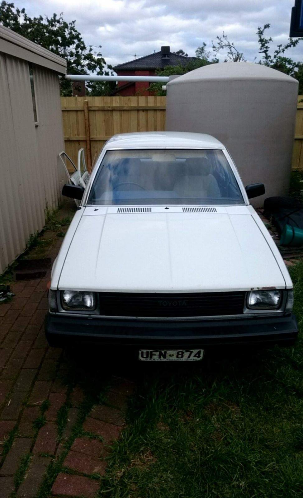

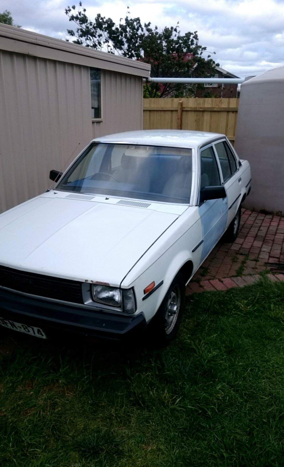

Body: got a lot of rust in the boot, and doors, swapped the front doors to AE71 doors , I think they look way better. it has only one of the original doors left

I swapped the drivers door today (right side for america XD) and put the new mirrors on both the doors now, it looks great, just need to paint them then they will look amazing.
also I took off the scuttle board a few days back and painted it white, because it had a lot of surface rust on it. so I sanded it back with a wire brush attachment for my electric drill, back to bare metal.
Then I painted it and baked it in the car, cause Australia and car means hot AF, so it cooked up nice.
Looks good too.
Got my mate Michael to help me with the door today, big tip if replacing door get a friend to hold door then you do the bolting of the hinges.

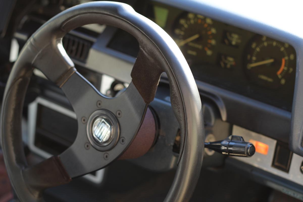

So I've done a few other things since last time, I've installed a new steering wheel, Nardi personal, I've replaced another door hahahahaha, only one of the original doors left now and I've installed a Tacho dash in replacement if the analog quartz clock, also put in a new racing seat for the driver as I think a cool racing seat look is awesome in this car. All of this stuff can me found on the YouTube channel if not in a video by itself then in a larger video.
here are some photos

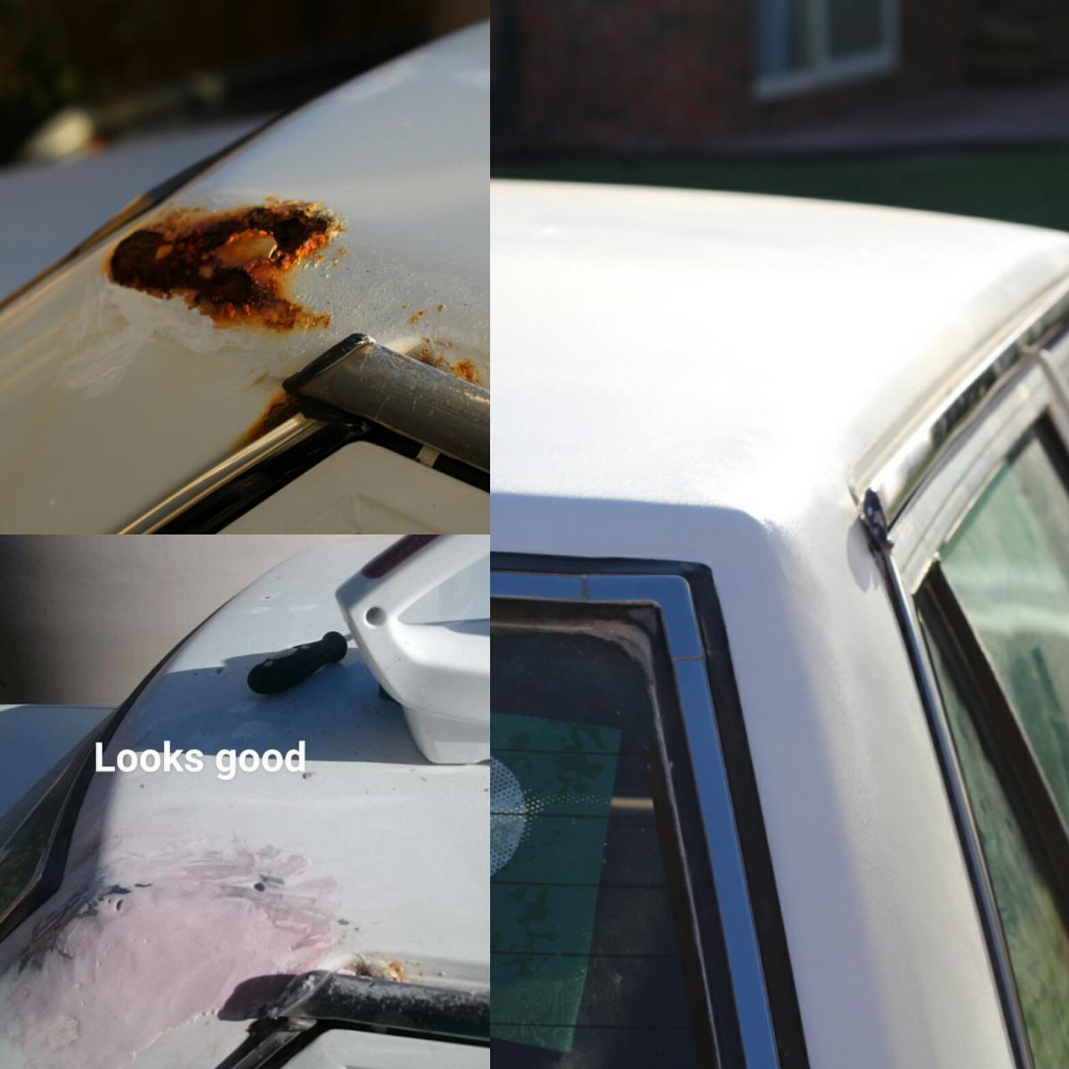

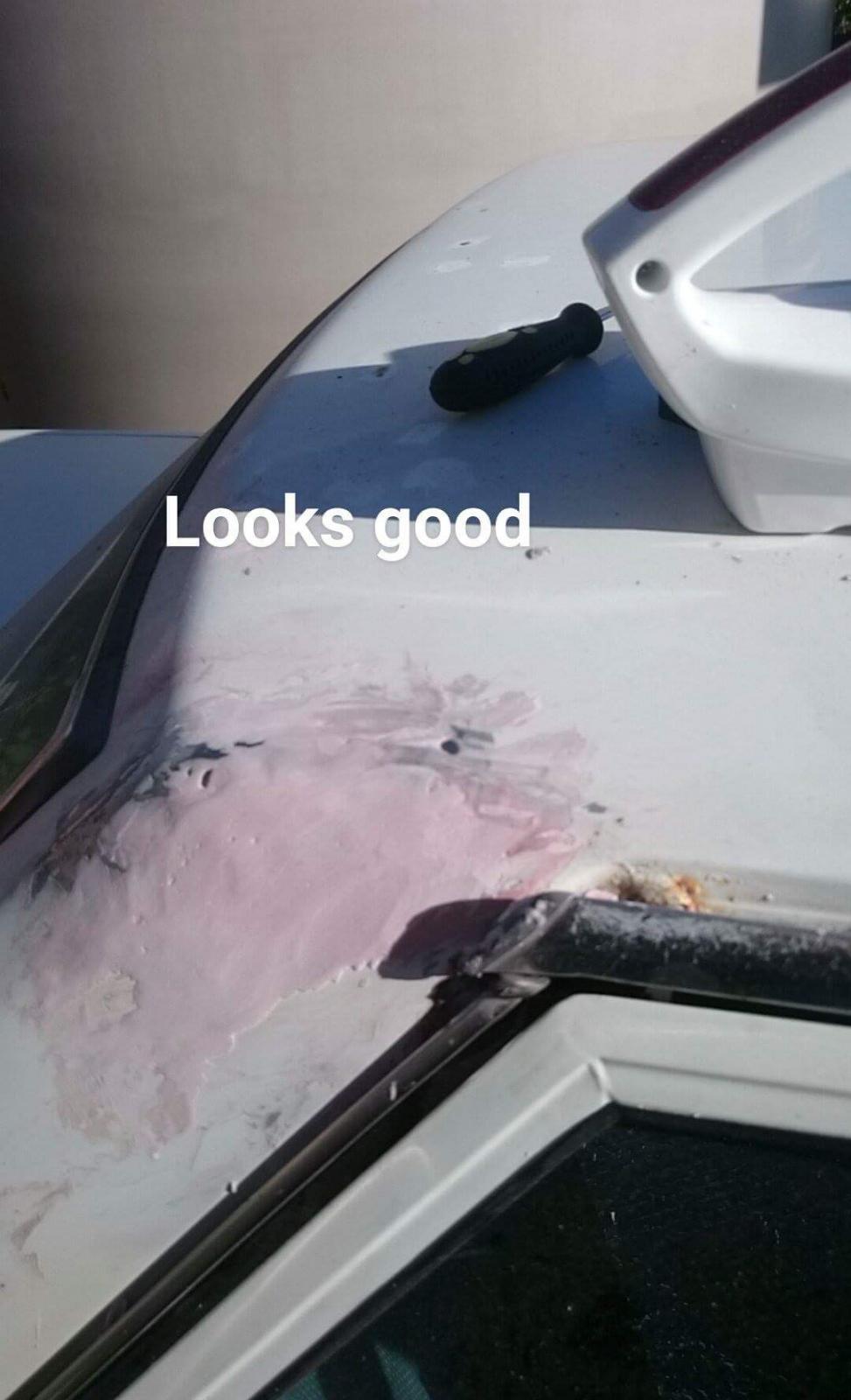

Hey everyone, big update, I'm doing a lot of stuff to the corolla atm, last month February 2017, I did some C pillar rust repair, as its my first time doing any major rust repair please don't judge me, I didn't cut out any metal that I could save with rust converter, because if I did cut it out I would have had a worse hole than I started with. I did some videos on it on my YouTube Channel, I'll link it at the bottom of the post. I didn't have to much knowledge going into it besides grind out thin weak metal and use rust converter to save the strong metal and paint the metal to seal it to stop it from rusting more, I forgot to paint it before I bogged it though so I hope it doesn't rust again.
The rust that was there looked like it had been bogged up before by the previous owners friend or something cause it was shit as.
I started by grinding the thing have and putting rust converter on it and let it dry before removing it with a rag dampened with metho.
(thumbnail from my youtube video haha)
then I covered it with body filler/bog, and sanded it smooth
post-24552-0-13179700-1488977726_thumb.jpeg post-24552-0-32958100-1488977729_thumb.jpg
then once I got it smooth I taped off the windows and area and using primmer white, I built up a few layers (4 coats) waiting for it to dry each time, then diamond topcoat, (2 coats), then clear coat, car looks shinny now in that area only hahahaha.
post-24552-0-37008600-1488977712_thumb.jpg post-24552-0-43488000-1488977716_thumb.jpg
from start to finish it took me 2 days, to get it done, I started late each day because of work.

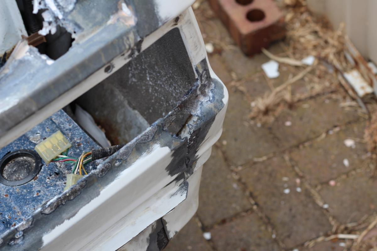

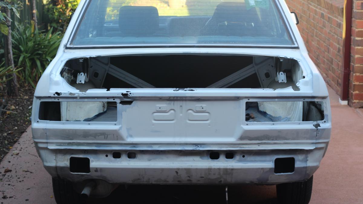

another update, same day as the last one above, I've started to attack the rear rust in the boot around the tail lights and the boot seal trim and the other areas of rust.

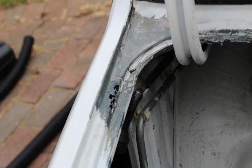

I got my good mate Michael to help me out, I've known him since primary school so long ass time. anyway I started on the work by removing the tail lights and the rear bumper bar, easy thing to remove the bumper bar, it is held on by 4 bolts but mine were seized and I had to remove it the more difficult way of 8 bolts cause I didn't have an impact gun (I do now), then the lights decided to have rust on the bolts that held them in so it took me 30 minutes to get them out.
then when Michael got there we started by using the wire brush drill attachments on the one electric drill I had, ( we have to but my Dad had taken the other one with him on a job that day) we got thinks back to bare metal, and no zinc or not rust coating was on the metal at all, or it was thin layer that we didn't see, as per usual Toyota Australia has done it again with shit metal prep on anti-rust coating back in the 1980s.
after grinding a lot of stuff back we then put rust converter on the metal, most of the rust was around small spot weld areas as you can see. I forgot to wipe the rust converter with a coating of metho spirits before I packed up for the night and I got a small coat of surface rust on the chemical reactioned areas, but because the rust converter was still on the metal, all I had to do is lightly grind it back with the wire brush attachment, took me 2 minutes and it was nice and shinny again.
after a lot of rust and rust converter, I realised that I had work for the next week and I needed to seal the car from any further rust so knowing where on the body needs work and that all of the rust that is left is not going to rust any further, I gave the car a can of white primmer.
its not a big seal but it was only meant to seal it from the weather for a week.
The rust that was there is now rust converted and all I have left to do is put metal in the areas that need it and do the body filler. so its soooooooo close to being done, I just need to get some thin metal sheeting to weld and braze into place. I also got some new wheels for the car as well the stock steal wheels are so much rusted that they are really only good for a spare wheel in the case of an emergency, or drift burners, but the ones I got where cheap and they look great on the car.

Looking good mate, thank god kes have some fairly linear metal around the lights and tis not as hard to repair and smooth them out. You might want to redo the roof pillar rust with a welded in plate as I could see some rot in the structure underneath, and there may be a distinct lack of strength should you roll over.
