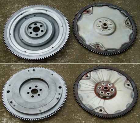

I wouldn't worry about conrods etc unless you are going to race it. Lighten the flywheel certainly, that does help acceleration. I don't know what they rev to, but the design is like the 18RG tractor motor we used to rally on, rather than the high-reving low torque 4AGE we use now. Design it to use the torque to pull cleanly from low down, rather than concentrate it all at the top end. So keep the carbs & exhaust smaller rather than larger. I'd settle for a 2.25" exhaust, as larger will get more noisey but not any more 'muscular.'

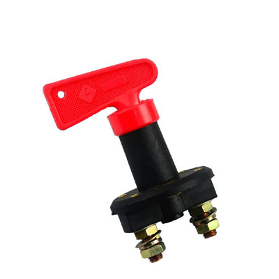

How about a motorsports kill switch on the battery & you take the key paddle with you?? Its cleaner than mucking around in an oily dizzy. You just have to make sure the wires can't be bridged, but I can't see car thieves taking time to disconnect your kill switch. Run the earth from down on the chassis up to the switch then to the battery. Cover the bare terminals in epoxy so they can't be bridged or unbolted, but then you will have that problem in the future.
Maybe painted black & mounted in the grill somewhere so you don't have to open the bonnet to get it. The problem there is some smart-arse might steal the kill switch paddle when you park anywhere, so don't make it noticeable.

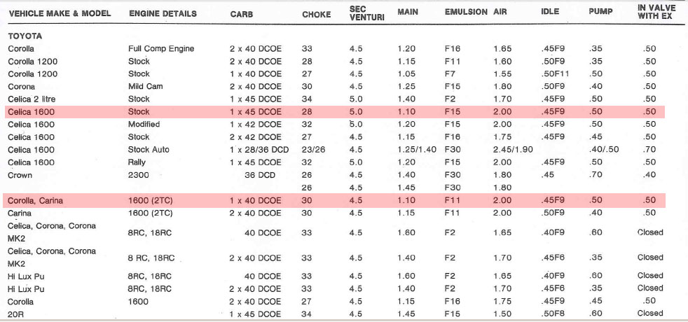

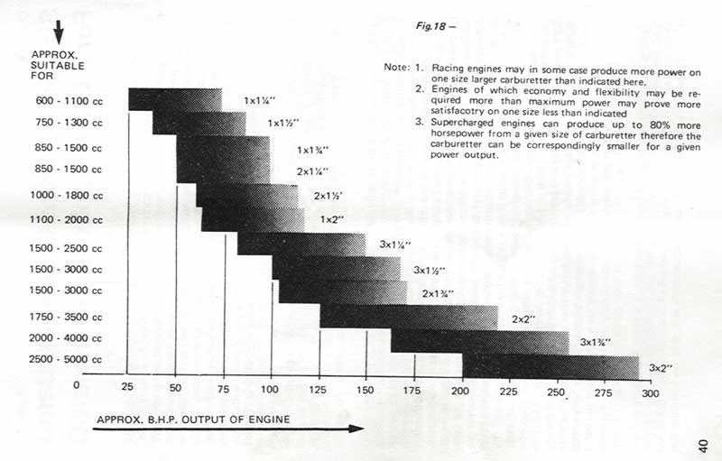

will be doing that ...what is the difference between 38 40 45 carb and best brand carb to get ?
will the cortina v6 carbs work and will i get power ?
weber and other brands ?
Probably the best carb is the newst one! Old worn carb bleed air in and get inefficient, but you have to use what you can find.
Twin Weber side-draught DCOE I reckon give most power, but will cost a fortune to buy and to run. Don't forget you will have to buy chokes and jets on top of the carb price to get it right. Great for racing or rallying.
A single DCOE will do the job just fine, as you can see from the image.
SUs are cheaper to run, as you can see from my build threads. I could make the car quicker with bigger carbs, but under 7L/100km is nice.
Newer carbs are on motorbikes, quads Mikuni or Kehins seem to work really well. Check out Tommys KE10.
Don't use a carb that is too big, they need a good flow velocity at low speed to mix the fuel correctly, and it is a pain to drive a car that bogs down every time you push the accelerator. Having great power over 5000rpm is no good if it dies down at 2000, which is where you take off from robots and stop signs.
The stock cams can help overcome the poor airflow at low revs, but if you re-cam it later then the bottom end gets really bad. The carb should be at maximum flow at your peak revs, and a lot of people have carbs that are probably only at 50% then. That means all the potential of the carb is wasted and they have lost a lot of performance in the low and mid range.

he says my ring gear is turning and it should turn the fan whilst car off but if he turns ring gear its turning but fan is not.
so he is saying i need to drop the motor to check? my motor could be gone is this true ?
