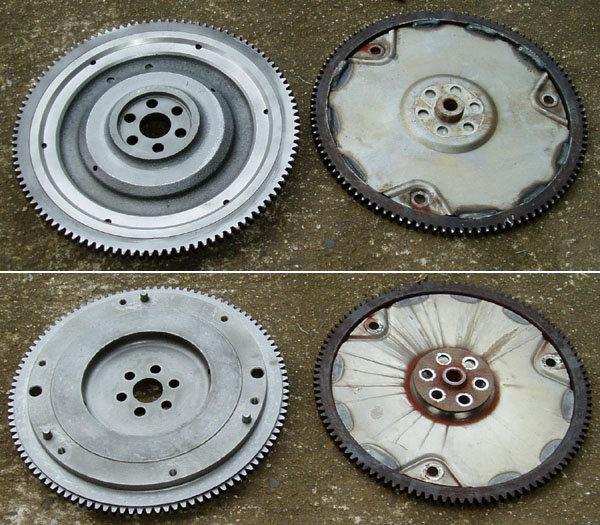

You can have a couple of Kg skimmed off on a lathe, its pretty common and makes a difference you can feel in the lower gears. This is mine after it was skimmed when we swapped out the auto box.

I don't know the weight of a 3T flywheel, but a 4K is about 8kg I think. I took a couple of kg off, which is pretty normal, as they are cast steel, not forged.
If you want to get below 6kg you'll be buying an aftermarket forged flywheel that is manufactured to be light. There is a limit as to how much you can take off a cast one without it flying to pieces, especially under the stress you are talking about.

just a follow up. I went to test my flywheel to determine why flywheel bolts keep coming off.
the reason is that my flywheel is warped? can an engineering place make this straight or do i need to get another flywheel?
That is very strange.
They should be able skim it straight and balance it, but it depends on how bent it is. Just ask a machine shop that does engine machining. They might have to make up a dummy crankshaft end to be sure the centre where it bolts on is the true center of balance. It depends on how it is warped. It might cost more than a new one, certainly another 2nd-hand one.
Still, nice to know why it was coming loose.
