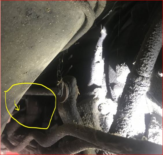

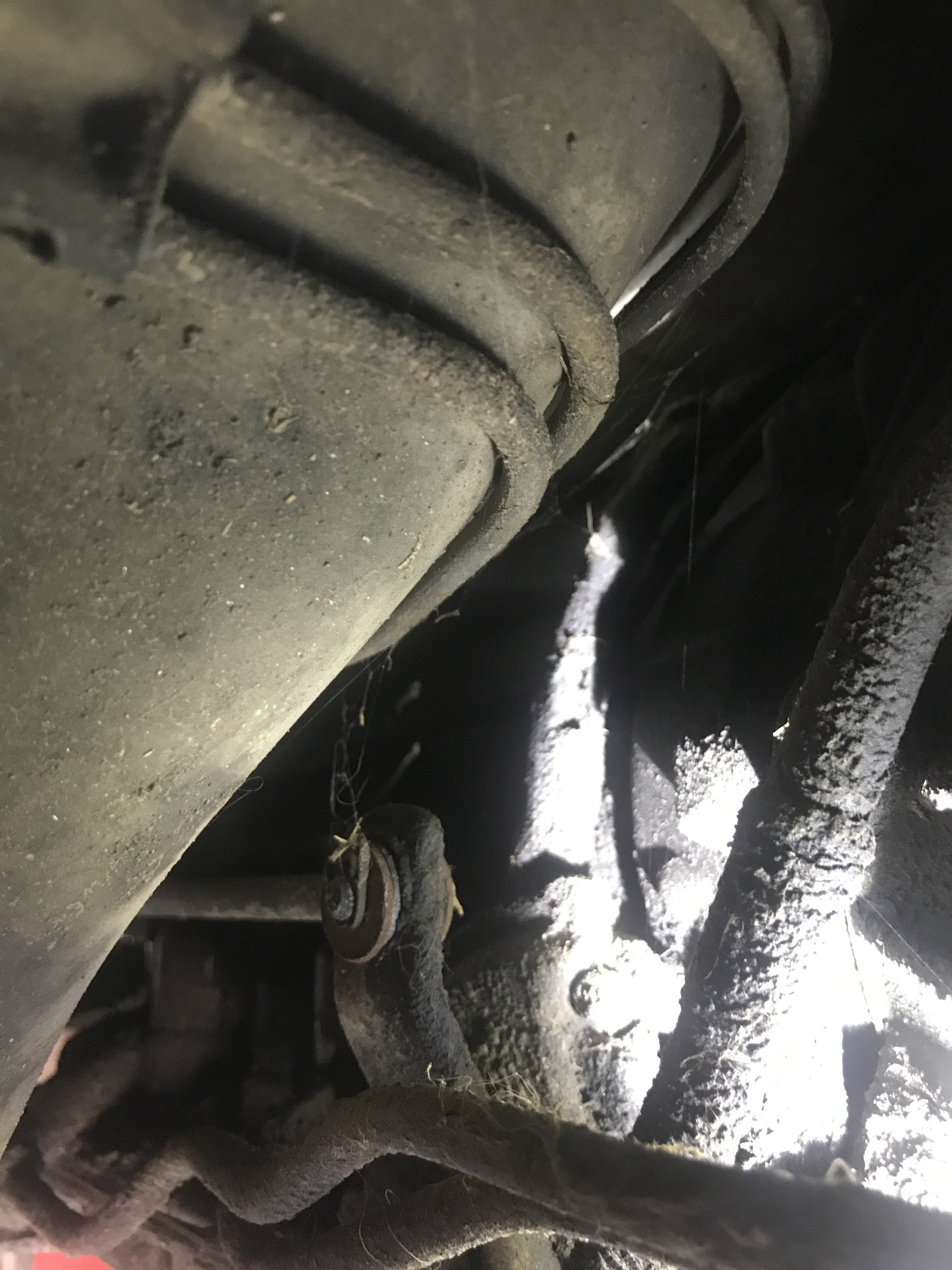

              Glad you've found it.  Is it the circled switch, lurking back there in the dark, with what looks like 2 wires on it.

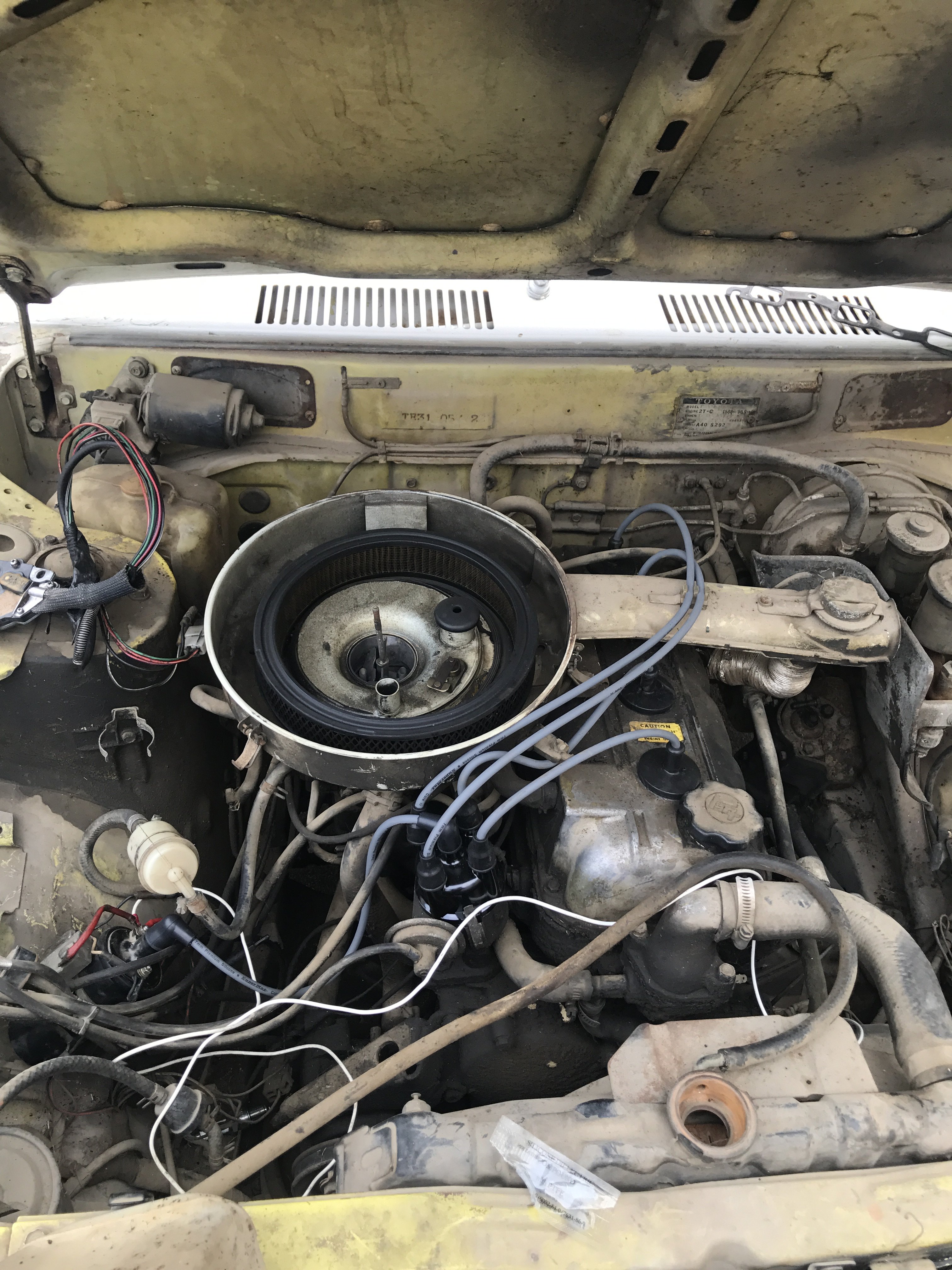

You have obviously got a complete different engine & auto box, in your KE55 USA, to what we have here in Australia.  Can you please take a photo under the bonnet, of the engine, so we can identify it.
Lets know how you go.  I won't be surprised if you find the switch is U/S.  That s not a good place to have an electrical component, with all the under floor rubbish all over it.

              My guess is, you've probably got a 2T-C  1.6L engine in your car, with a 4 speed auto. I tried to find a 4 speed auto gearbox pic on the net that might show this elusive neutral switch, but couldn't find one.
Does the engine under your bonnet, look a bit like this ?
Cheers Banjo
3 hours ago, Banjo said:
Hi Omar,
Cheers Banjo
Not as nice as the one in the picture but yes just like it.

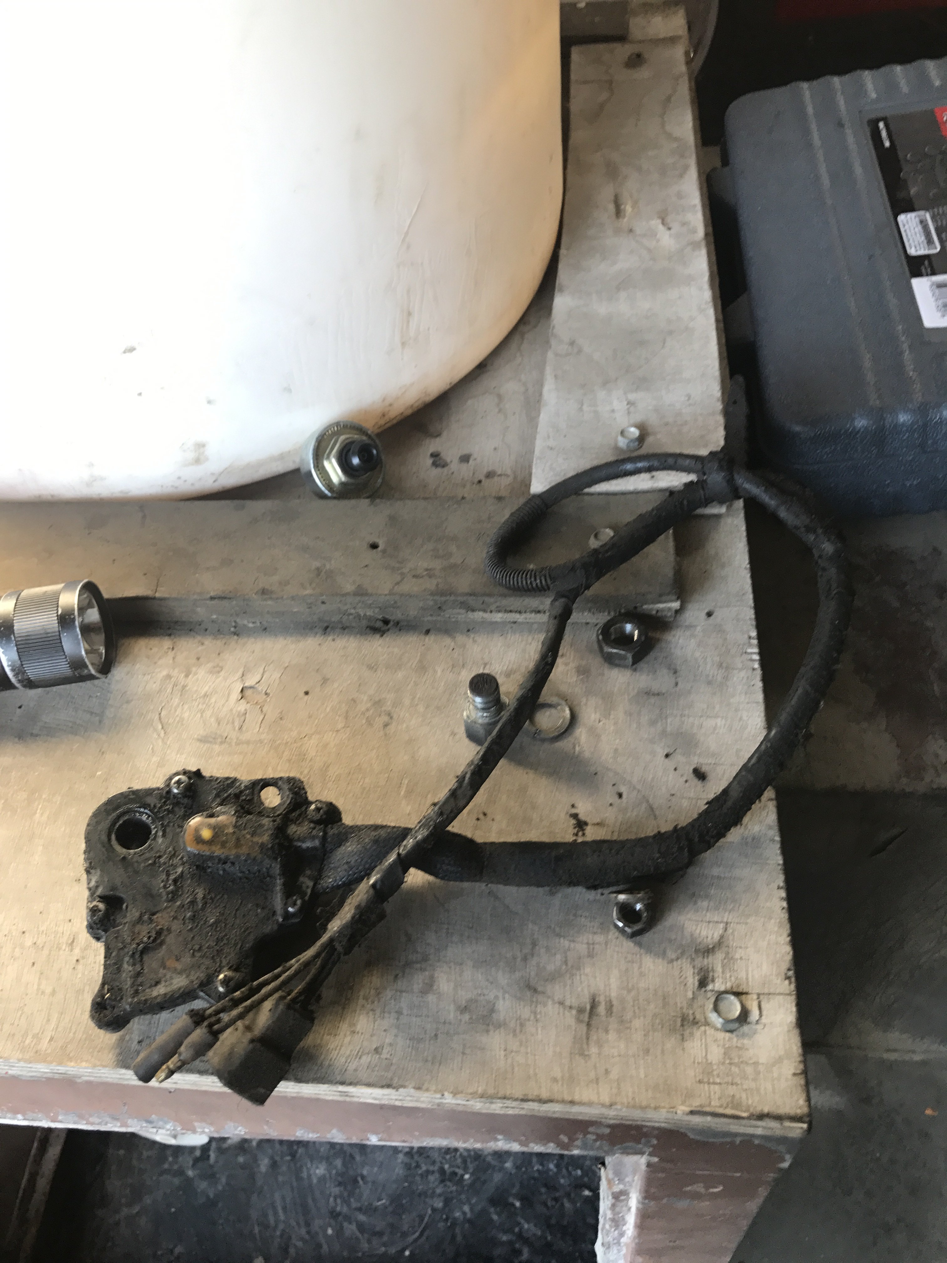

Found the switxh just need to find whwre where to buy it.
Aha!  That's a win!  Clean it up an see if it can be repaired. Is the problem in the wires on in the switch inside?? Does it come apart?
Hi Omar,
              This is like one of those serials on the TV, which goes on & on.  I just want to jump to the episode where the car starts, & everyone is happy.
OK, so the switch appears to have four (4) wires coming out of it.  My guess is the two (2) individual wires will be for the reversing lights, & the connector socket will be for the start circuit.
This should be pretty easy to test.  If you short the two individual wires on the loom, where those switch wires plugged into, the reversing lights should come on, when the ignition is on.
Likewise, if you short the corresponding two wires in the plug on the loom, you should be able to start the car !
Like Altezzaclub suggests; I'd be giving that switch a really good clean, & see what you find.  You might find its just full of road crud, and when it is all cleaned up inside, it might just work, so you don't have to go looking for a replacement one.

So I was able to clean it up and put it back together. I can hear a click( like relay)  when I turn the key but still no crank. Is there a starter relay on the right side kick panel?

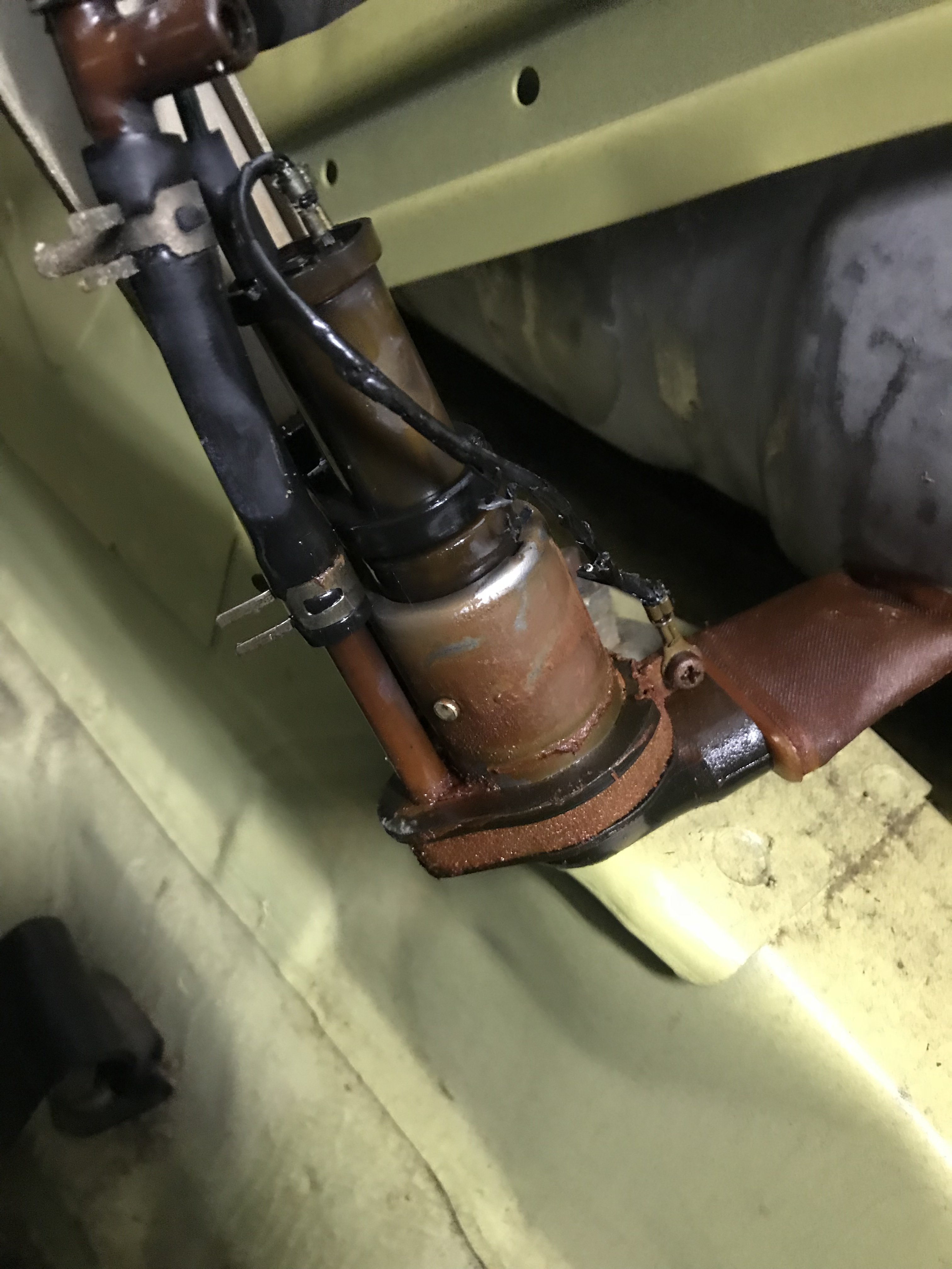

Well got it started. Switched to electronic ignition. That solved my spark issue. Had a fuel issue( no fuel to the filter). Found out my car has a electric in tank pump. Got a new one just needs to be installed.  Do the front brakes and I’ll be able to take it for a spin. So stoked.
