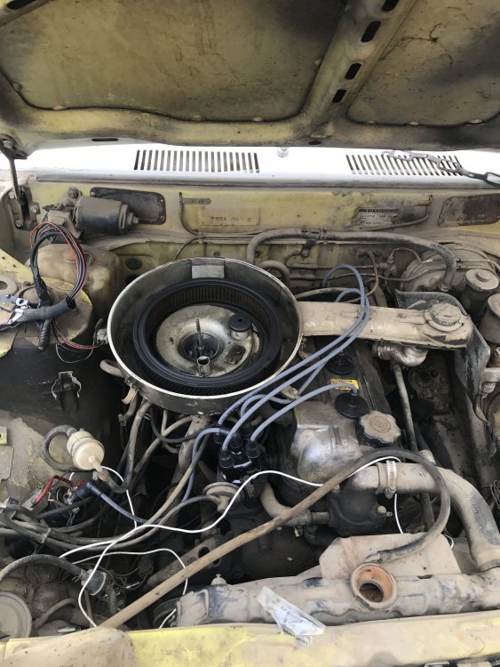

so i just recently acquired a 75 corolla automatic deluxe. Car hasn't been moved or started since 95, when original owner passed away. so far got a new starter and ignition coil. Starter was seized and coil didn't measure within specs. now for the issues, i can't get it to crank by turning the key i have to give power to the signal wire up by the battery, thinking that might be a issue with the no spark as well. any help or suggestions is greatly appreciated would like to hear this car run after sitting for 22yrs now. thanks in advanced for any help

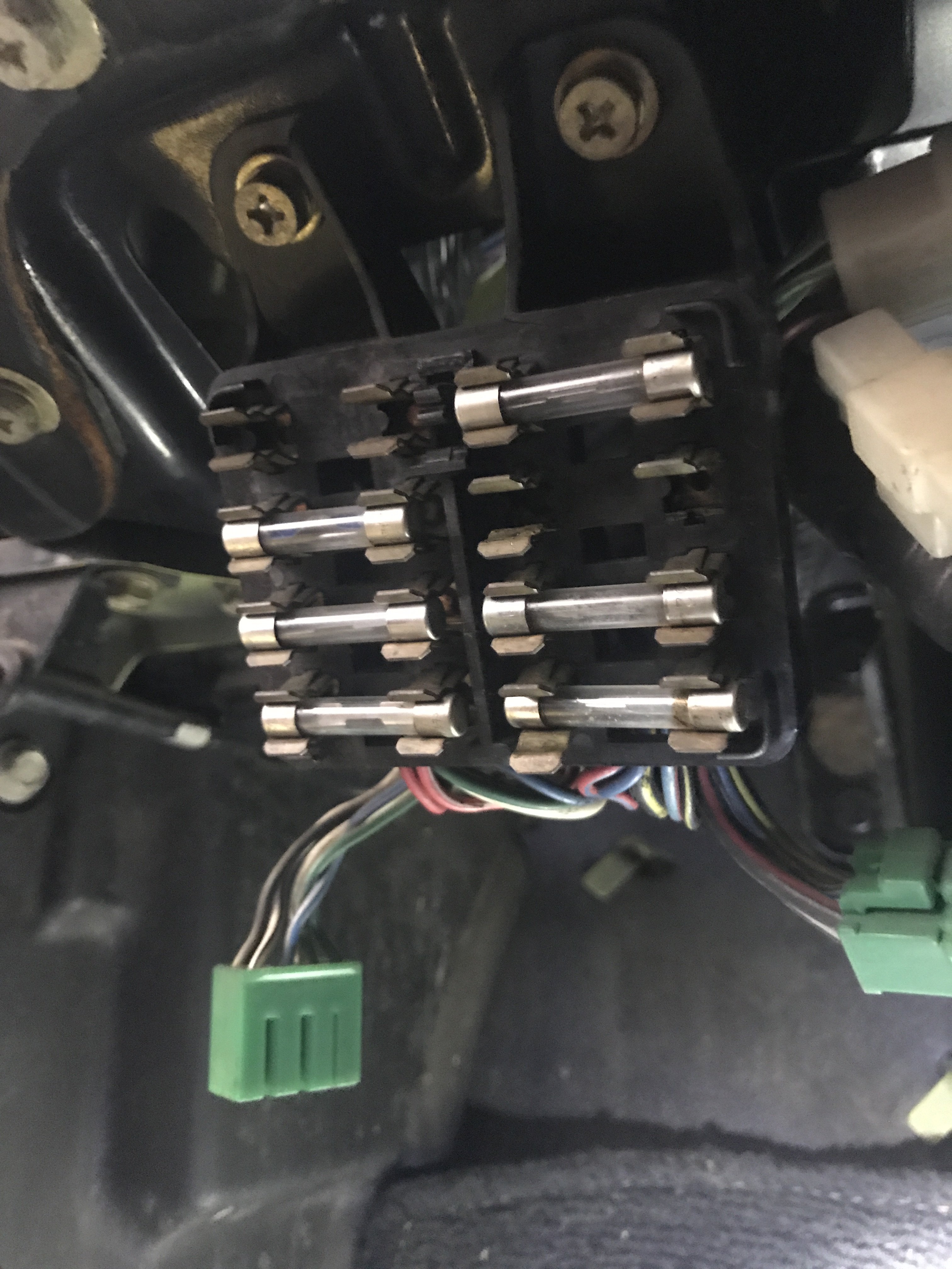

The problem will be either the ignition fuse, the ignition barrel itself, one of the electrical plugs & sockets at the base of the steering column, or possibly the transmission switch in the centre console, that only lets you start the car, when it is in neutral.

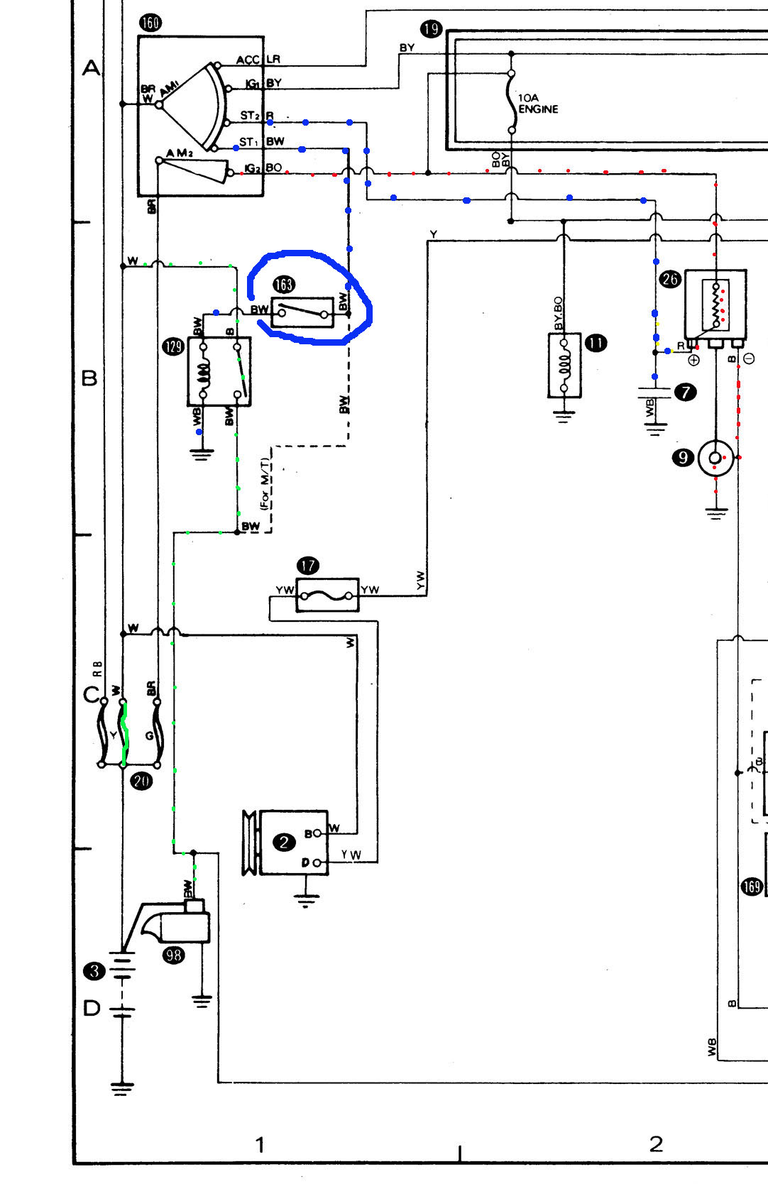

Here is the KE70 setup. The switch outlined in blue is the auto gear-lever lockout, the dotted line by-passing it is the manual circuit. The auto has a relay to carry the current, so starter solenoid power (green dots) goes from one of the battery fusible links through the starter relay and off to the solenoid. The relay control (blue dots) is via the ignition 'ST' position on the key and the neutral switch. That is a black & white wire leaving the ignition key setup.
I don't know if a KE30 has a ballast resistor, it might have been too early. The KE70s run a 9V coil & a resistor.  On the diagram you can see the ignition power at the key from ST for starting and also IG for running. The blue dots for starting by-pass the ballast resistor to feed power directly into the coil, whereas when you let the ignition key back to the 'run' position the power goes through the ballast to reduce it to 9V to suit the coil. They are a red wire for starting and a black-orange for run. You might only have one.
You could pull the wire junction apart at the ignition key barrel and feed 12V into the white wire going in. Then check what coloured wire does what as it comes back out. If you have a black/white, see if it goes live when you turn to 'start'. If there is a red, see if it goes live for 'ignition'. That would eliminate problems in the key barrel.
Either way, if the points are open and the key is on, you should get a voltage at the points arm.  If you do, then you just jump 12V into the starter solenoid wire to crank it and see if it runs. Then chase the wiring problem.

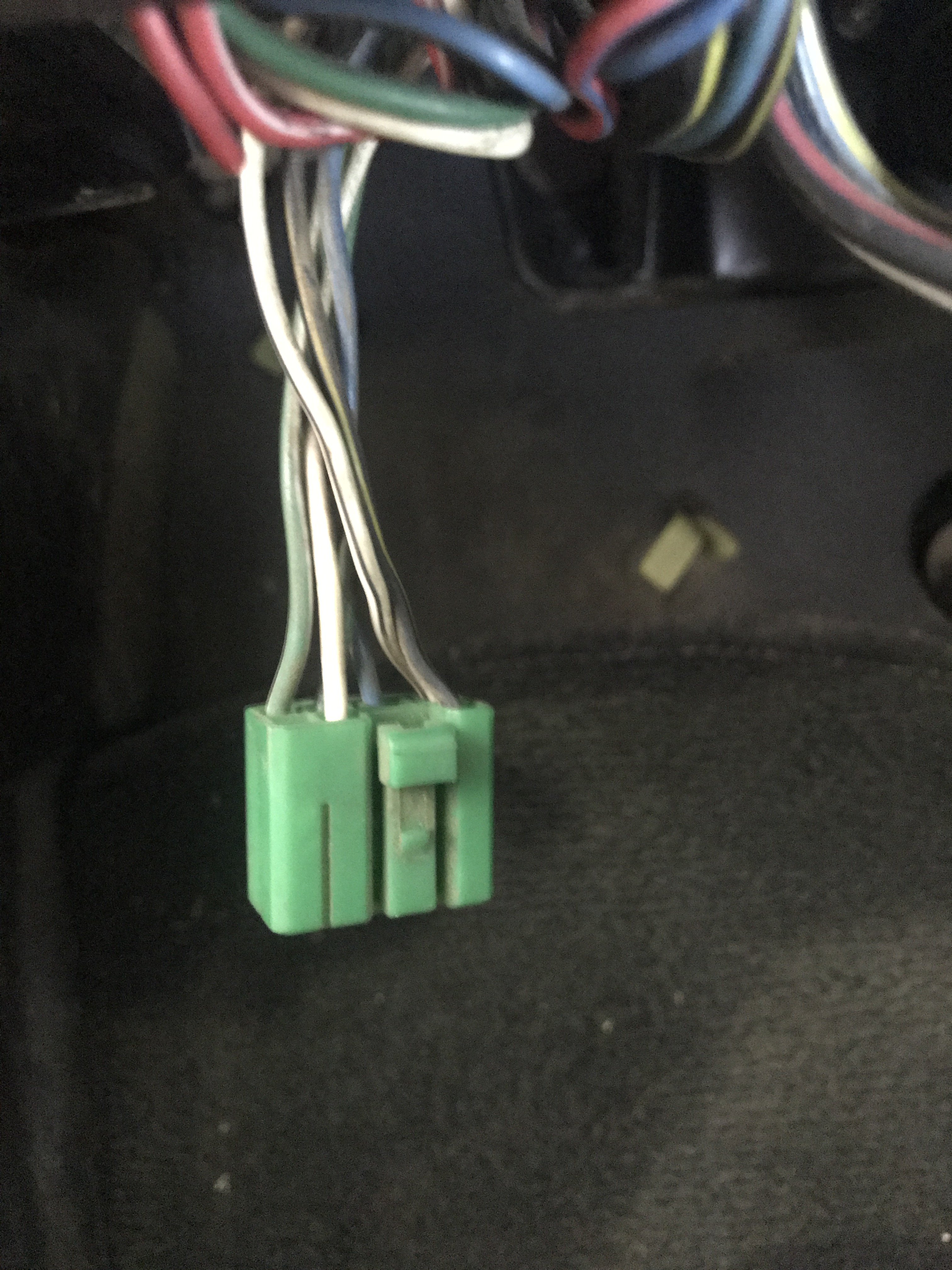

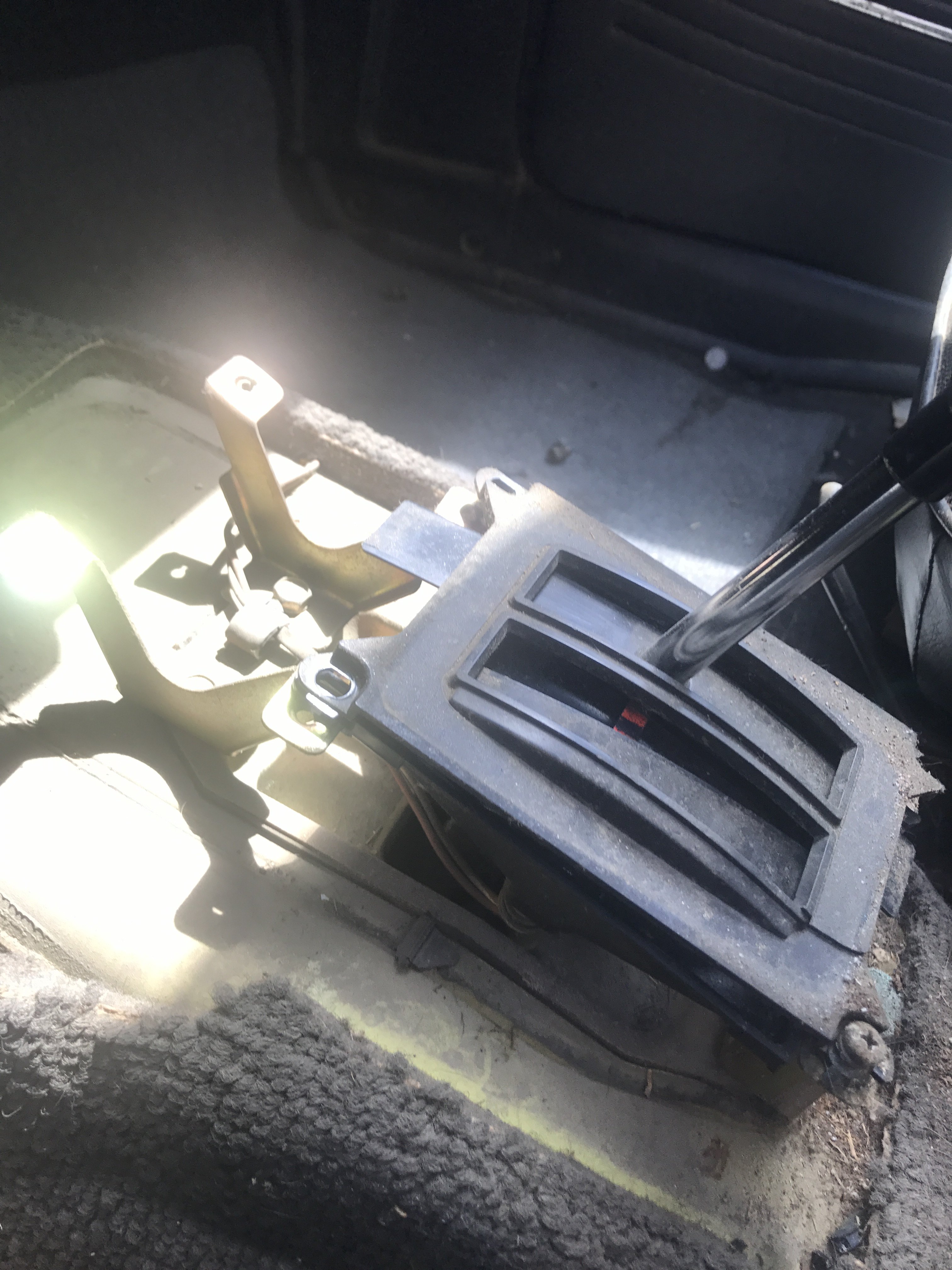

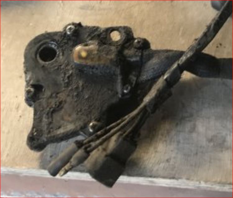

I went looking for an auto shifter I knew I had in the shed somewhere, that I removed from my KE30 when I did a manual changeover.  Altezzaclub's wiring diagram is how all auto Corollas were wired, with maybe small variations, or maybe different coloured wires.  I can't imagine that Toyota produced some autos with the neutral lock-out switch not incorporated into the auto shifter.  Your photos don't show the area under the plastic ware, where the switch is located.  You can clearly see the switch in the pictures below.  This switch is a combination switch.  It does two functions.  1. It has a N.O switch that only closes when the shifter is in neutral. This allows the starter relay to energise, only when in neutral.  This is as per Altezzaclubs diagram above. 2.  The second function of the combo switch is a N.O. switch which only closes when in reverse.  This turns the reversing lights on.
I just buzzed these out with the shifter I have here.
So there are a total of 6 wires, coming out of the auto shifter.  4 off those are in a plug, and the other two are single wires.
The plug contains the wires for the reversing & Neutral lockout switching.
Plug:   Red wire with White stripe & Red wire with Blue stripe are the reversing switch.
            Black Wire & Black Wire with White Stripe are the neutral lock-out switch.
The two loose wires . . . .  White wire with Black Stripe, & Red wire with Black Stripe are the illumination light, for the auto console, as Altezzaclub pointed out above.
From the photo, you can see that the plug lead is only 9 - 10 cm long, so the matching socket must be close somewhere behind the console. I know that's where I found mine, and just added a shorting link between the Black & Black with White stripe socket terminals.
P.S.  From memory, when I drove a few of these olde auto Corollas, the position of the auto shifter in neutral was quite critical, and you had to jiggle it a bit sometimes to get it to allow the starter circuit to work.  While holding the key in the hard clockwise start position, jiggle the auto shifter that is in neutral & see if that has any effect.
