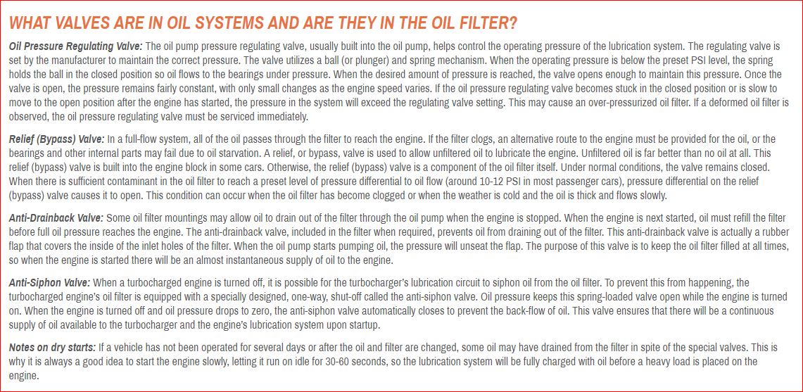

This is from the FRAM website, about the various valves in the lubrication system, & what each one does.

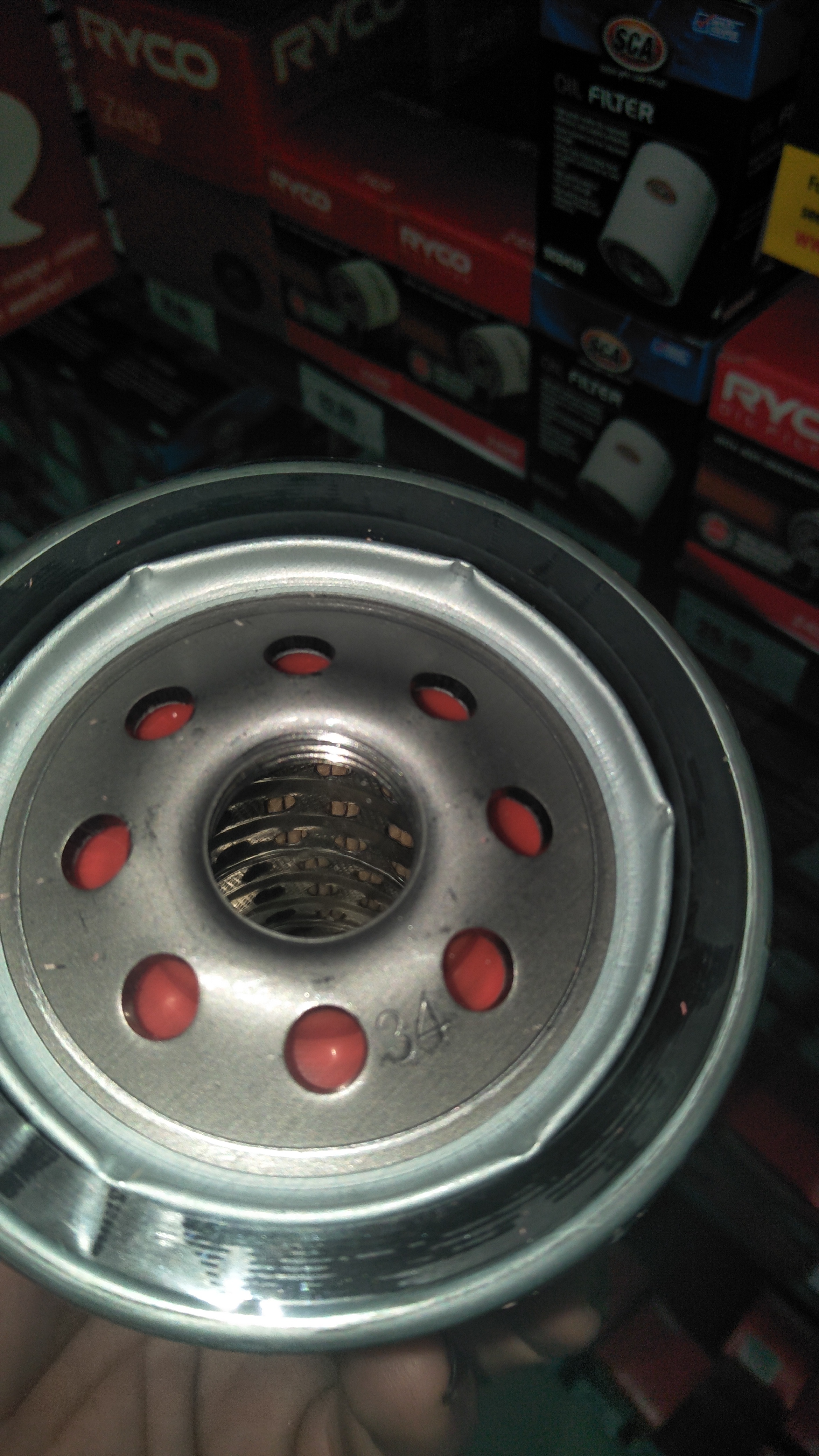

This is the std 4k one, Z68. (see pic)
U can see right through to the filter media. I suspect there is enough clearance in the crankshaft oil galleries for oil to just exit through the engine.
I will have to special order a Z421, but not until i hav confirmation that they really do have both valves.

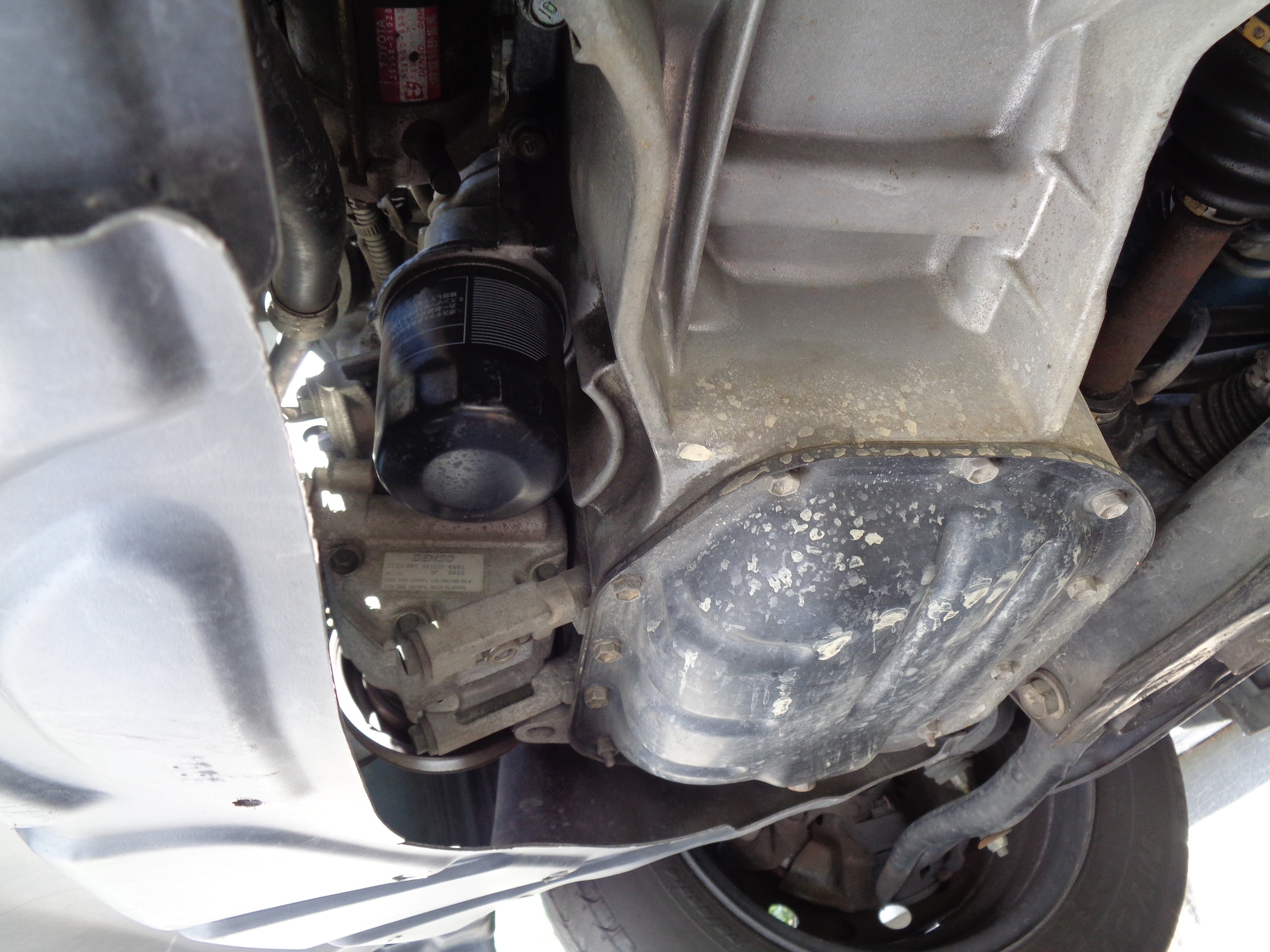

I had a new Ryco Z418 oil filter on the shelf in the garage, for my daughter's 2004 Echo.  I had a look down the outlet hole in the middle, & it doesn't  have an anti-syphoning valve, as you can see the inside of the filter element clearly.
However, on the 2004 Echo, the filter is mounted very very low on the motor, such that you have to lie under the car to fit it.  The outlet for the filter points upwards, (not inverted), so probably doesn't really need an anti-syphoning valve.
