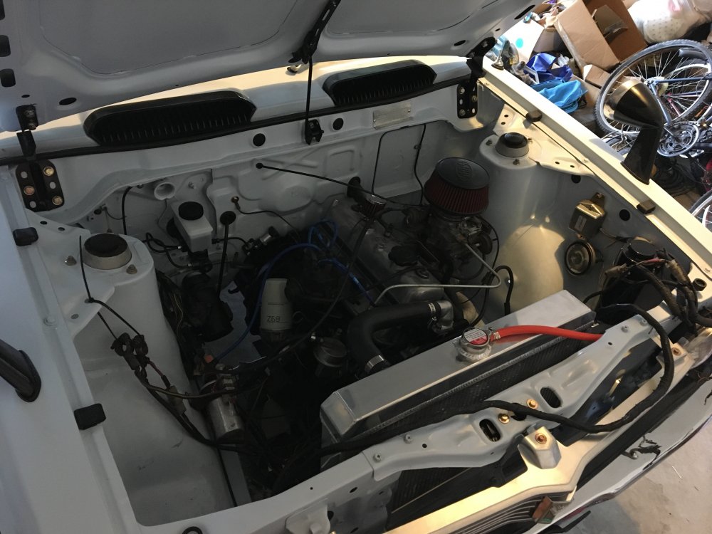

I'm trying to understand what purpose this fuel line serves. It leads from the tank to the engine bay then seems to terminate inside the chassis rail....? Is this correct or have I missed something?

The breather/overflow for the fuel tank, on the very early Rollas was fed into the channel rail at the rear of the car. On one Rolla coup I once saw, it passed right up into the roof area in a loop, (to prevent siphoning), before the end was directed into the rear floor/chassis channel.  I did not know they ever fitted fuel tank breather hose, which exited to the rail in the engine bay area.  Seems strange ?
My KE30 2 door has a fuel tank breather hose that comes to the engine bay, but enters the air filter via a non return plastic valve.  I'd do something similar with it if I was you.
That's the valve in the pic above attached to the steering box.  A tube from there goes up to the air filter.

Thanks Banjo,
That makes sense, the line loops up the fire wall at the steering box, across to the passenger side along the fire wall top seam then down to the chassis rail height again before termination inside the rail. Your comment about an anti siphoning measure fits... The loop would be higher than the tank at this point.
Strange Toyota has so many different methods to achieve the same result for such a simple item.
Thanks for the suggestion, I will look into a non return valve.

Hi Monk,
                If you get a fuel breather non return valve, from another later model KE Rolla, complete with bracket, you can mount it  under the bolt on the steering box.  I might even have one floating around in the garage. I'll take a look tomorrow.
Here's a pic of Brodie's great engine bay, (Rollaclub member in S.A.), clearly showing how he just ran a tube/hose from the non return valve up & over the rocker cover,  & into the induction system.
Cheers Banjo

I think I might leave it in its factory layout and just add an inline check valve. This at least positions the end of the line on the carb side of the engine bay to mitigate having a loose hose draped over the engine. Don’t go to any trouble finding the valve please mate, I have just ordered one on eBay.
