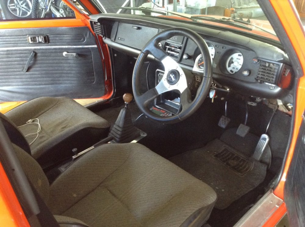

So heres the setup,
1974 ke20
ca18det with t28 turbo. water to air intercooler (rad support still intact)
hilux diff
r31 brakes front and rear.
image33-2.jpg.cb280b23319e1ab285dc37a6bf630206.jpgimage55-2.thumb.jpg.bc9281ecb8719d12e04d8f0542586b93.jpgimage1515.thumb.jpg.e9feb3083fabcd4be43d27df33137d86.jpg
