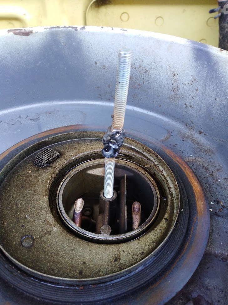

    Minor progress today. Seeing as its close to being usable on the road I made a few fixes - the main one is the threaded rod that retains the filter lid. I had lost mine during work on the engine and needed a replacement - I had two bolts but they weren't quite long enough so I welded them together head-to-head with a nut in between to give a bit of extra length. Perfect! After that I took pity on the boot and vacuumed it out. Nowhere near as bad as the interior, it cleaned up nicely. I gave the spare a clean up and a lick of paint, too, as it was developing surface rust. Now I just need a small scissor jack and a retainer for the spare. Cheers - boingk

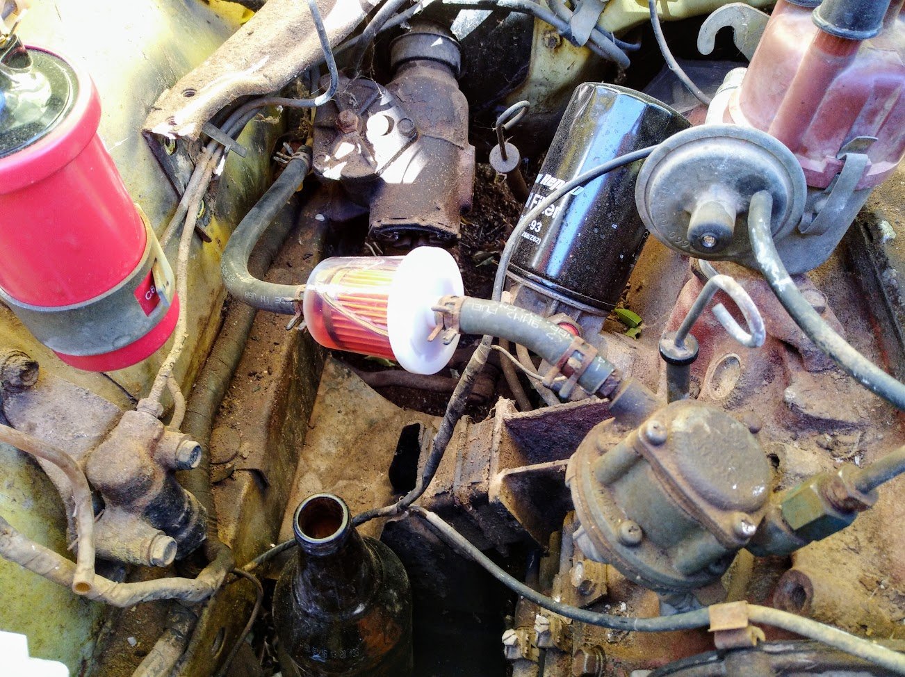

    Today I got stuck into the fuel system. The stock pump is working fine so it is staying, but the rubber line and filter before it were horrible. I replaced them with a clear filter and new line, much better now and you can see the condition of the filter as well. Before I connected the new line and filter to the pump I ran all the old fuel out with a small electric pump, then put 10L of fresh fuel into the tank and used the same pump to draw it through. There was only about 6 litres or so in the old tank but it was pretty brown and off-looking. I'll see if it runs in the lawnmower (it runs pretty much anything) and failing that I'll take it out to the chemical disposal site at the local dump. With the new hose and filter connected and fresh fuel in the tank she runs nicely. All up a successful day.
