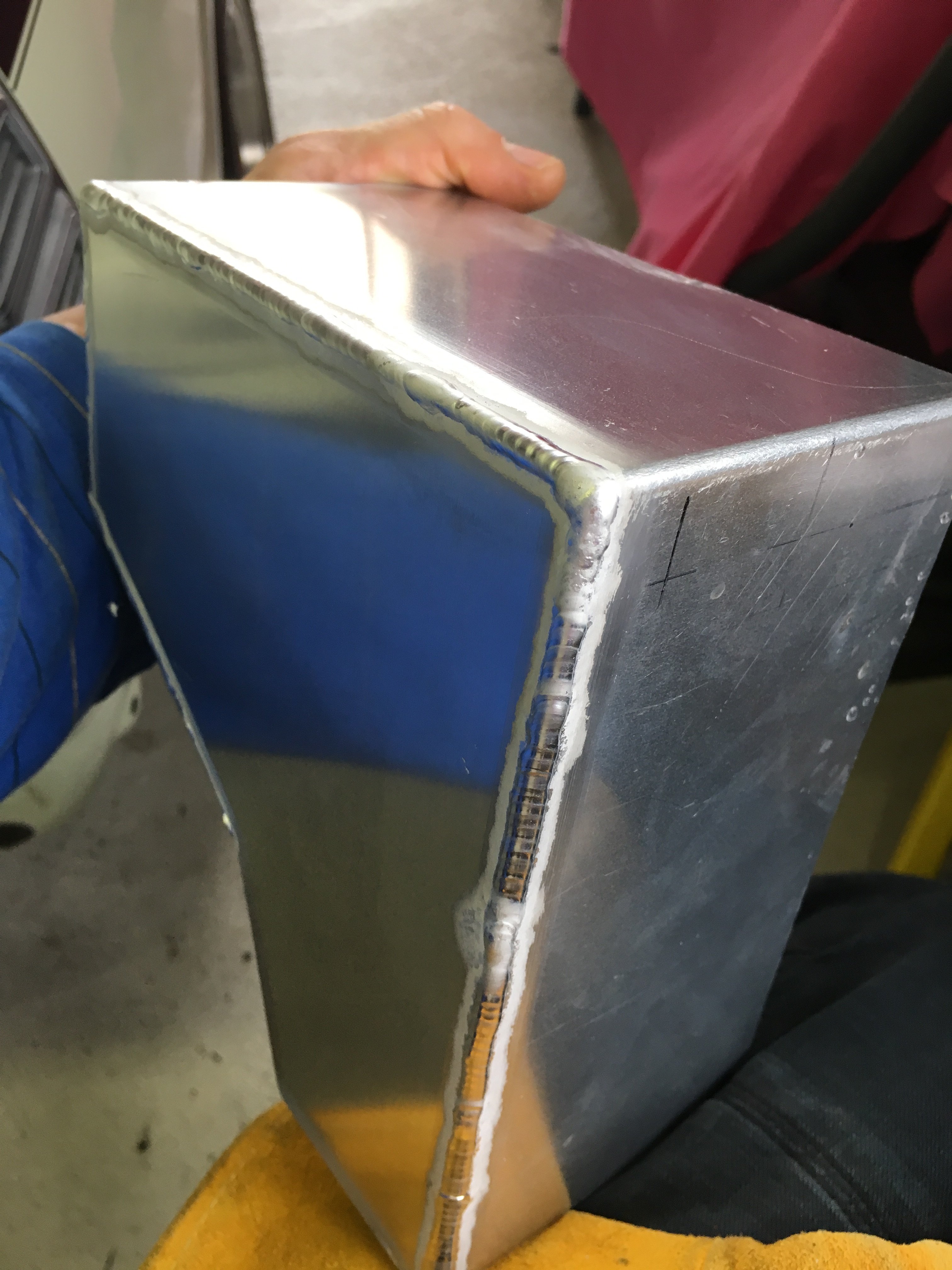

Once each side had a tack on it and I was happy with the positioning I started to weld it up, I welded about 3 inches at a time alternating sides. Ally gets hot really quickly and retains heat a lot more than steel and I don't have foot pedal to able to adjust the amps on the fly.

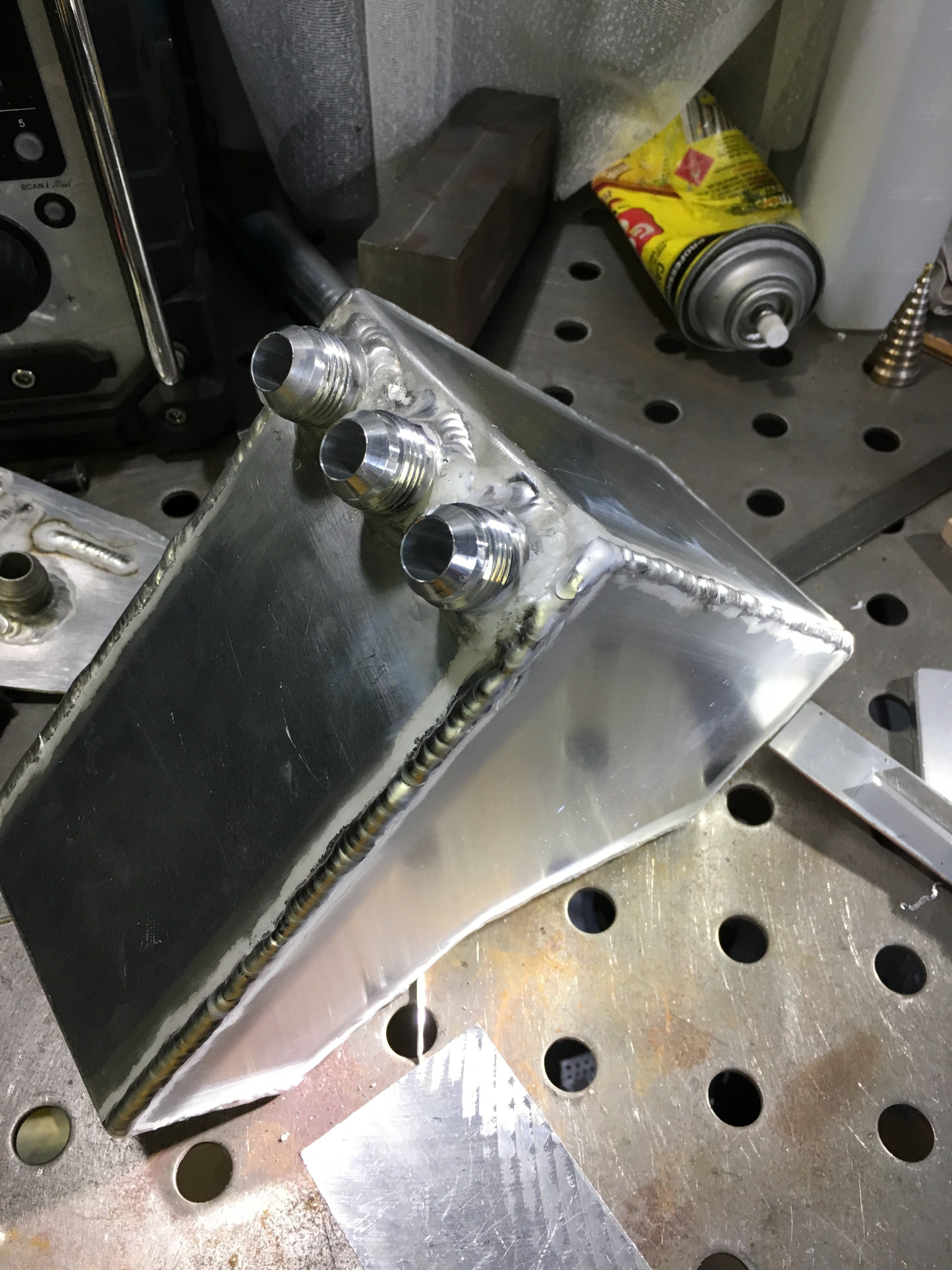

One side completely welded.

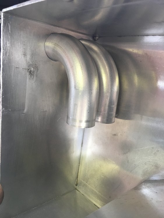

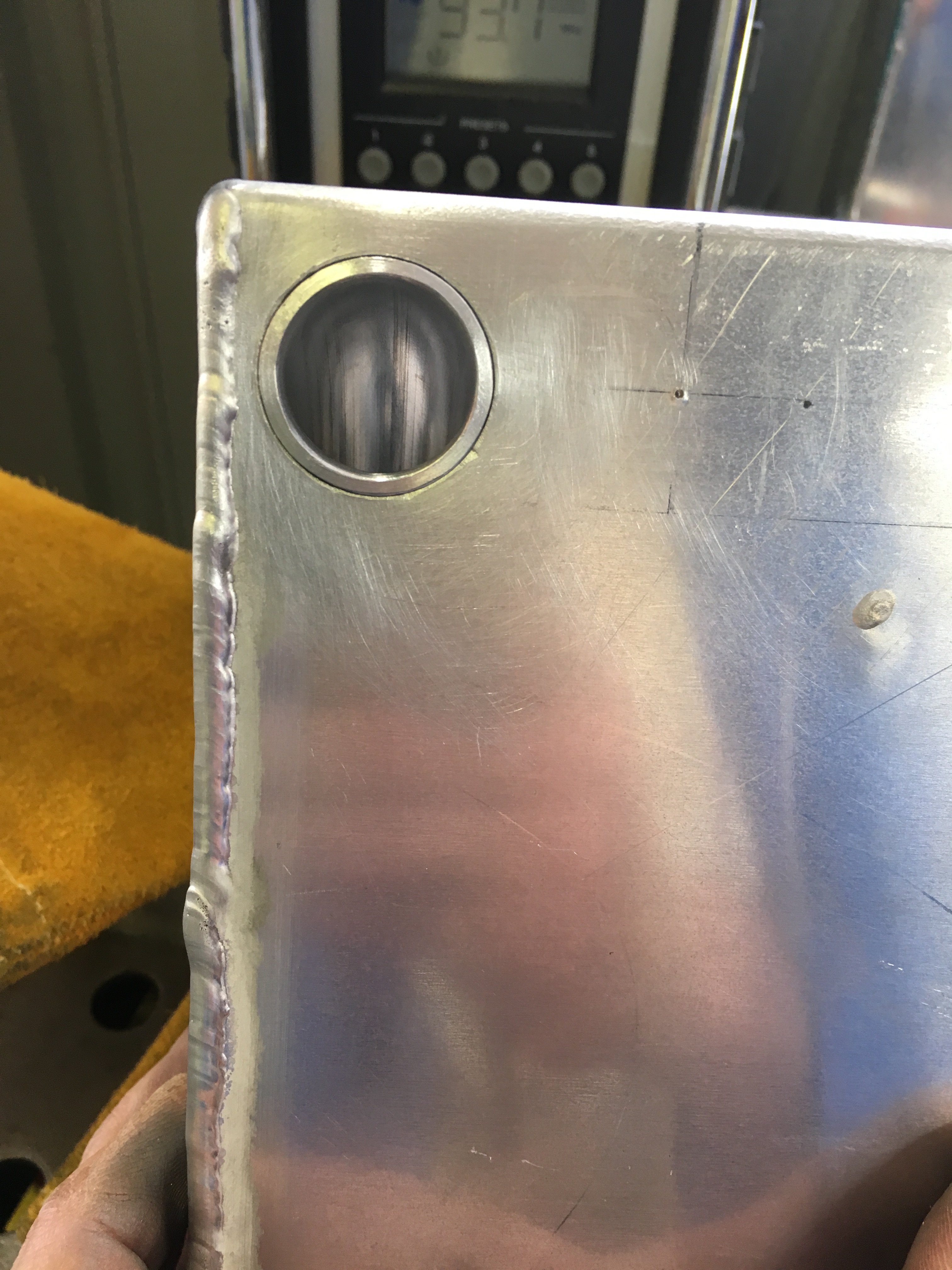

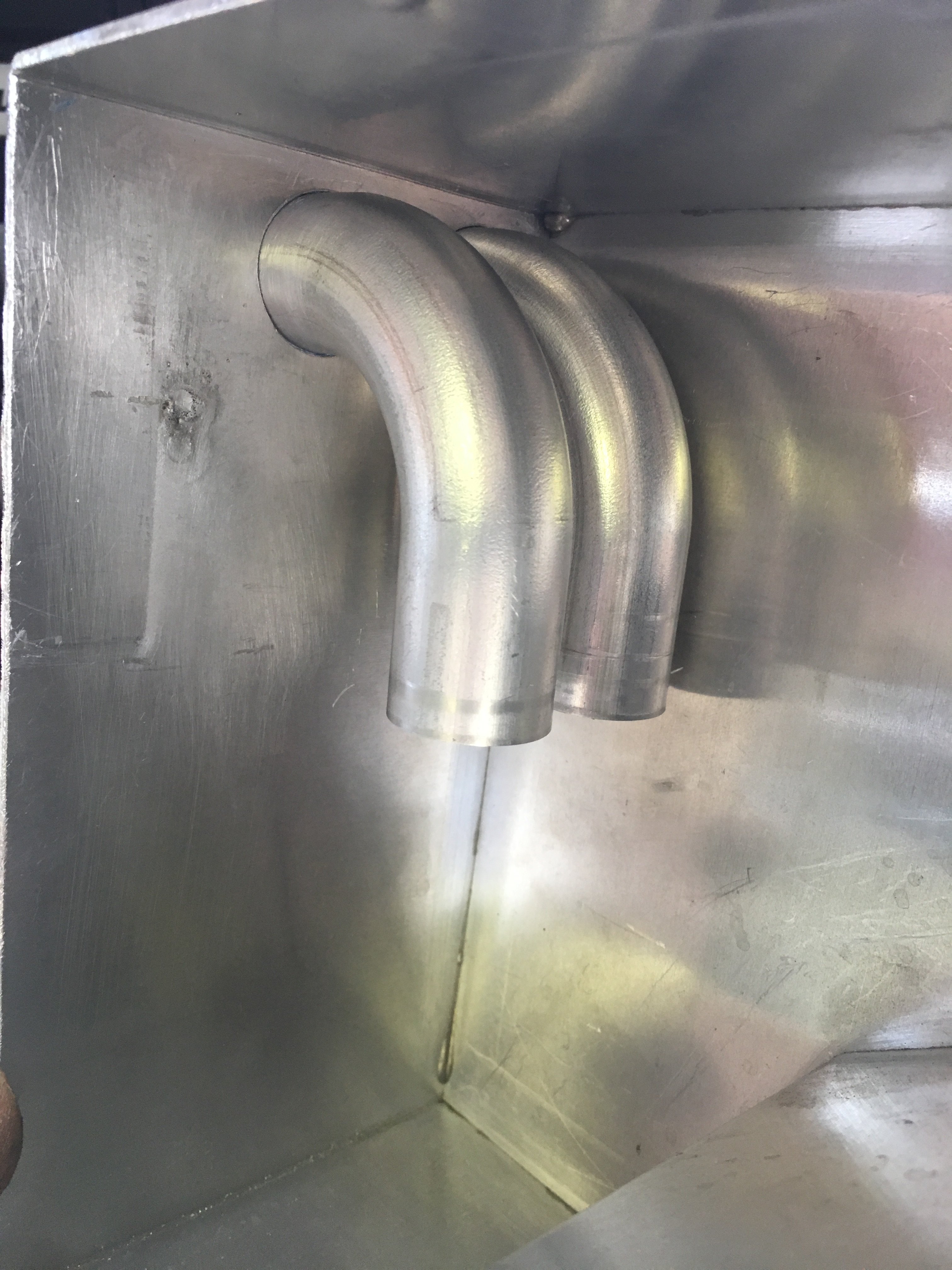

I wanted 2 inlets initially but then ended up with needing 3, I bought some 1" mandrel bends to direct the oily fumes directly to the bottom of the tank and welded them in place.

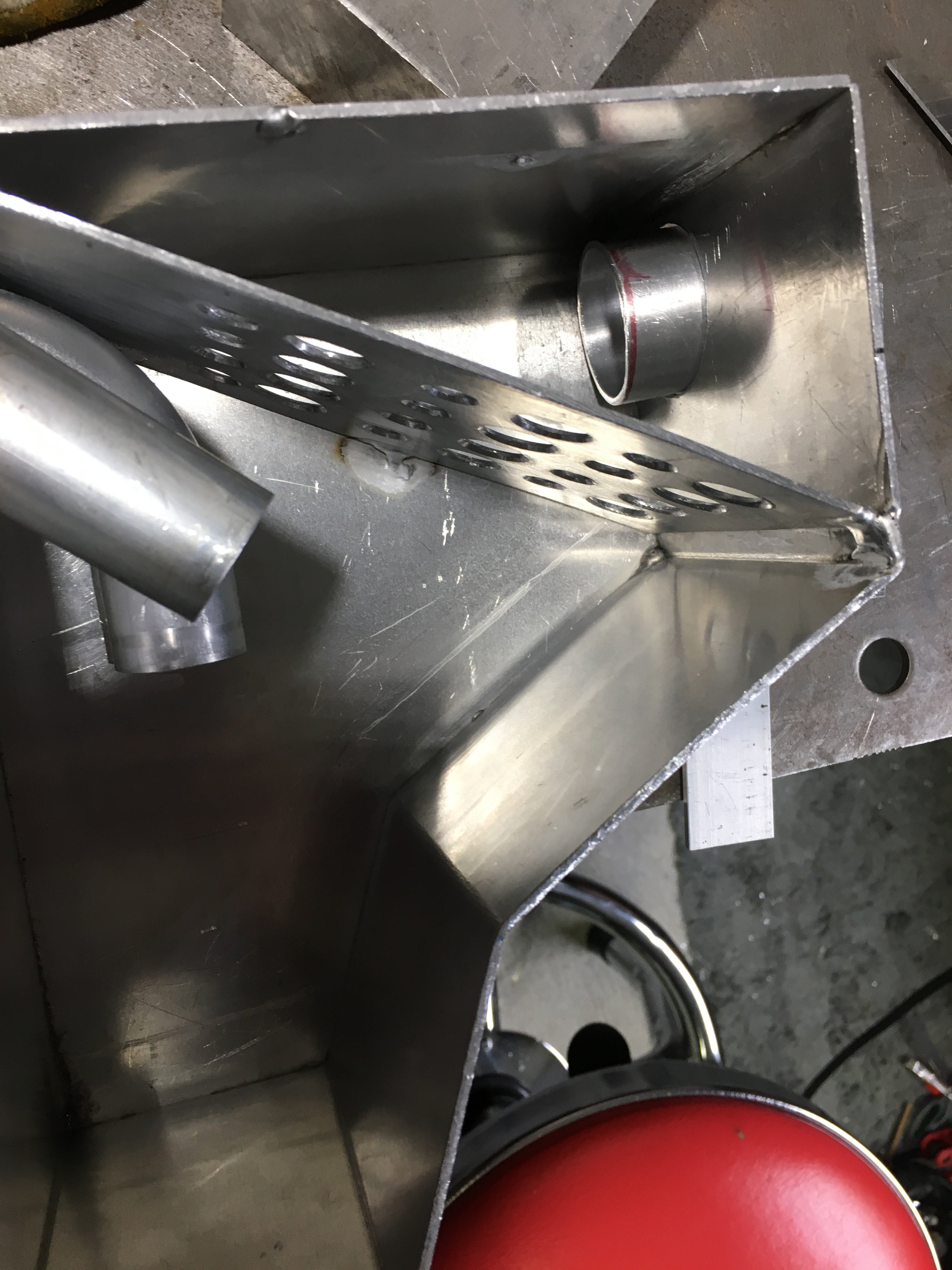

Next I added a plate to help separate the oil from the air evacuating from the tank via 1.5" outlet, I have drilled a heap of holes in this plate and will also have some Stainless Steel Wool sitting on top to further help separation. It got super tricking getting the Tig torch inside the tank to weld this but I got some good welds in order to keep it in place. I only bought two 90 degree bends for the inlets, so I cut a piece of tube at a 45 for the last inlet, not ideal but it will do.
image.thumb.jpeg.3a4c1b219215a9dc313e3c4666fa2573.jpegI

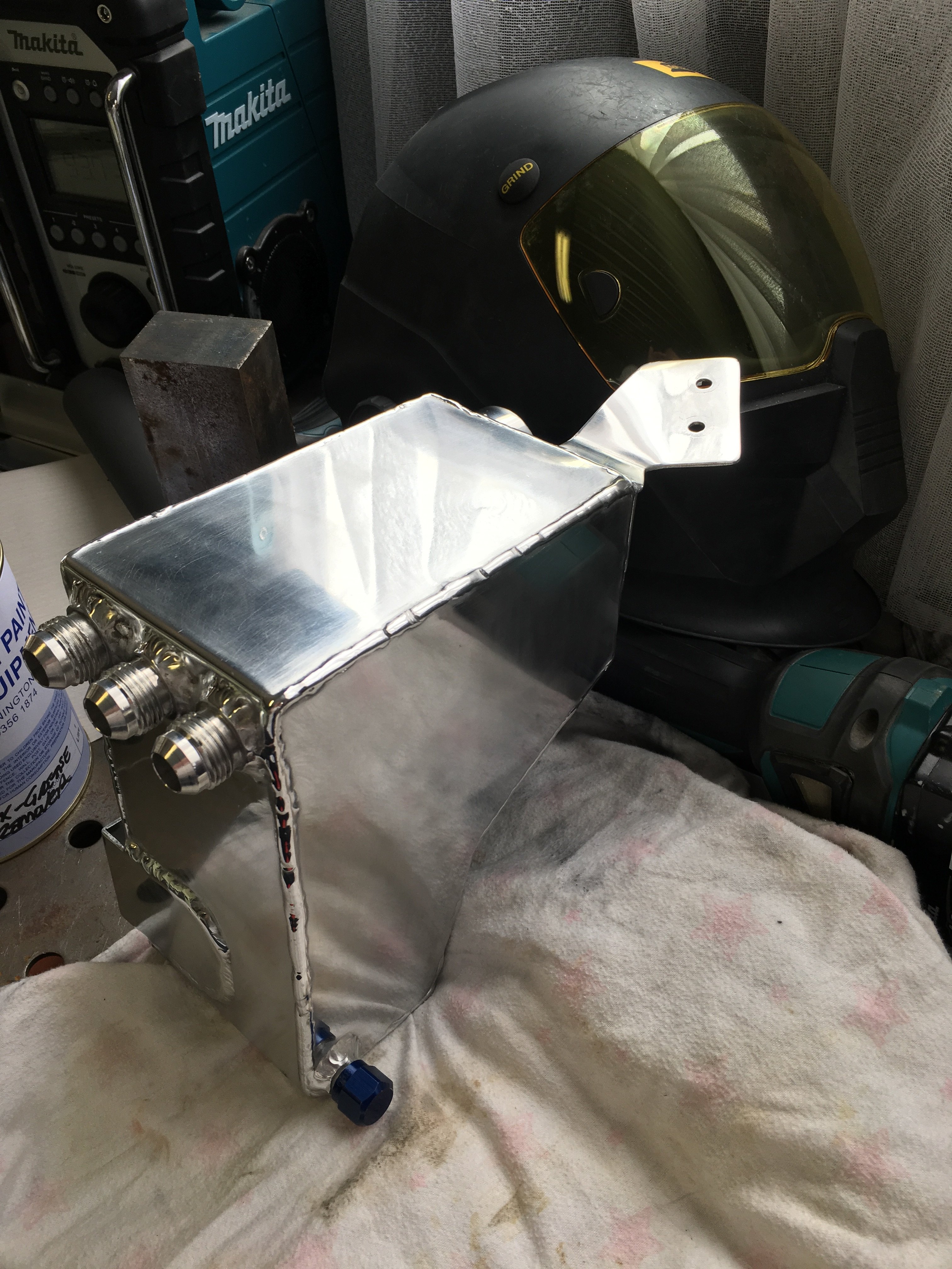

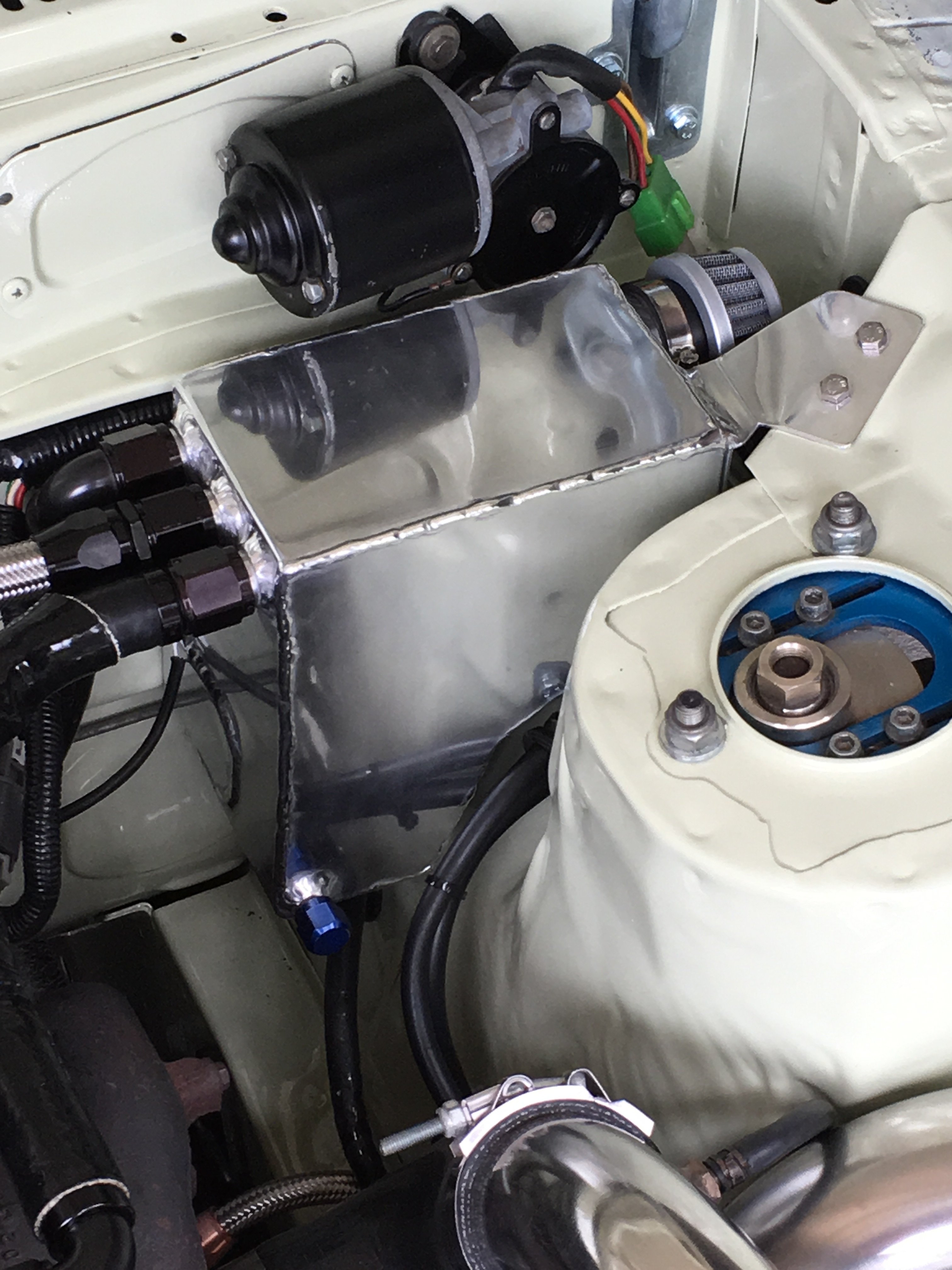

welded the last side on, also the 3 -10 an inlet fittings and the outlet, all that left is the drain, brackets to attach it to the car and a quick clean up and polish.
Great work!
Drill the inner guard and put a hose on the filter so its out of the engine bay, they always make a mess.

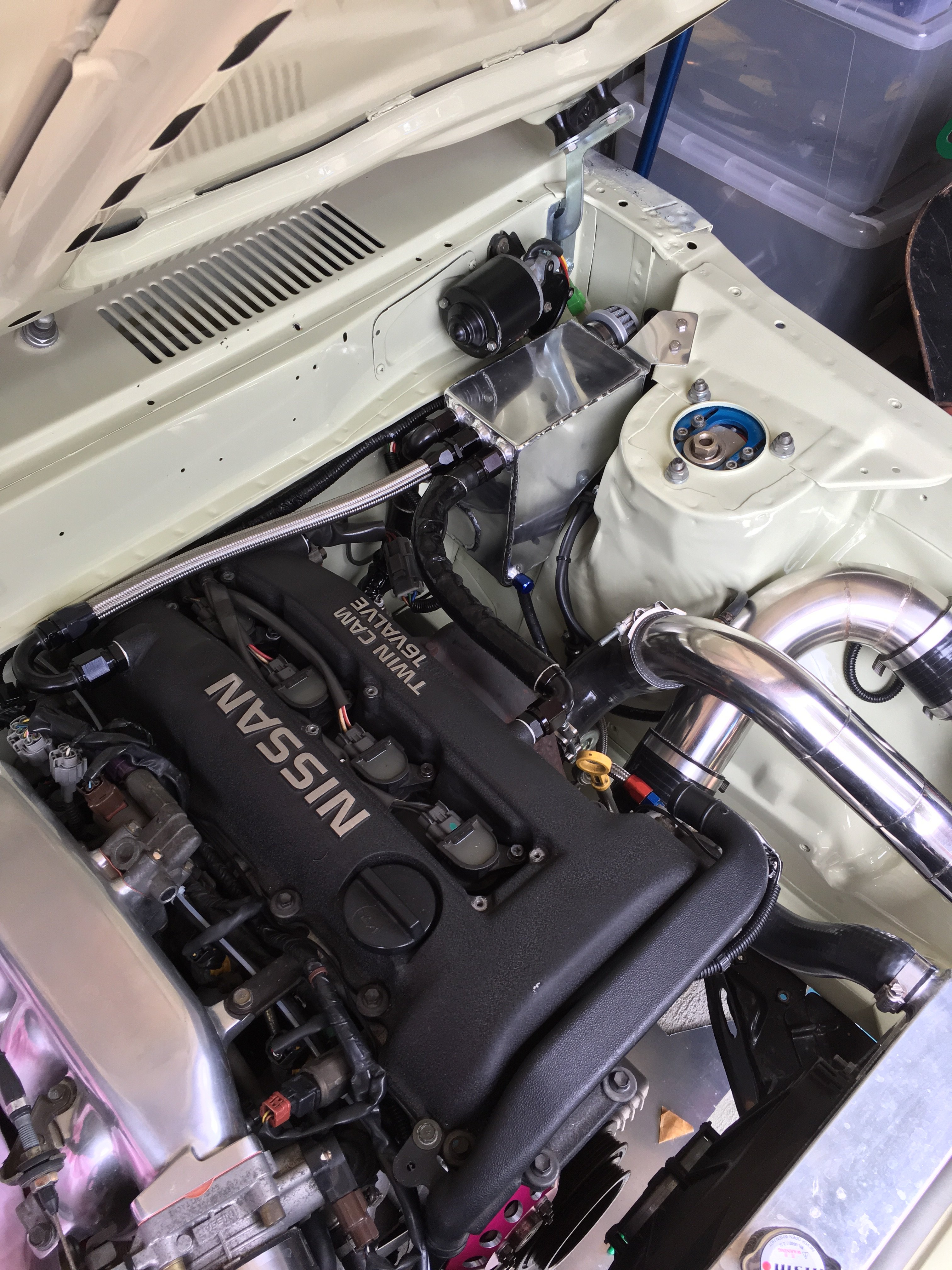

Excellent work !  Ideal placement up in that back RH corner, but then with the Nissan in the bay, there ain't too many other places you could put it.  I put my commercial aluminium catch can in a similar area.  Works well !
Nik of "Project Binky" would be proud of you.  Did you make a cardboard cut out, & use it as a test box, to make sure it fitted in the space OK ?  That's what Project Binky do all the time.
