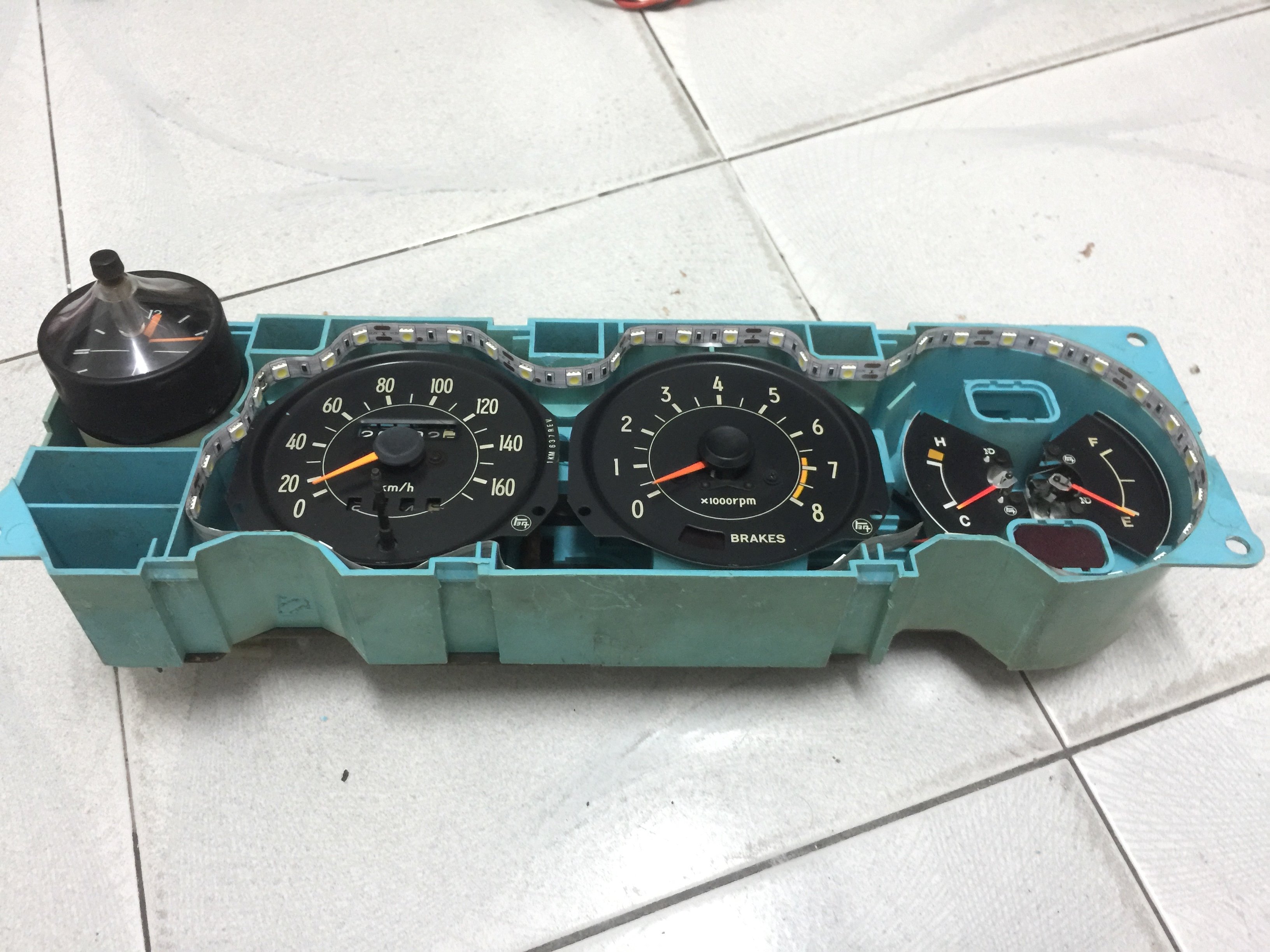

October 24, 20188 yr comment_715745 hello guys , been wondering on how to add led light in the meter cluster like the attached picture , i got this picture from fb but forgot whos the owner of this picture. if you guys have done this modification or have any ideas , please share . thanks in advance . ano Report

October 26, 20188 yr Author comment_715763 On 10/25/2018 at 10:43 AM, Banjo said: Here's a link to one I remember recently. https://www.rollaclub.com/board/topic/73225-smarten-up-your-dash/?tab=comments#comment-708509 Here is another . . . https://www.rollaclub.com/board/topic/51690-rosie-the-ke55-rolla/?page=4&tab=comments#comment-540580 Just Search Rollaclub above field for LED or T10, & a few will come up. Cheers Banjo thanks for your help @Banjo , the 2nd link is nice idea!! never thought about it , just lay the led strip inside the meter cluster. thanks for your help @banjo and @parrot Report

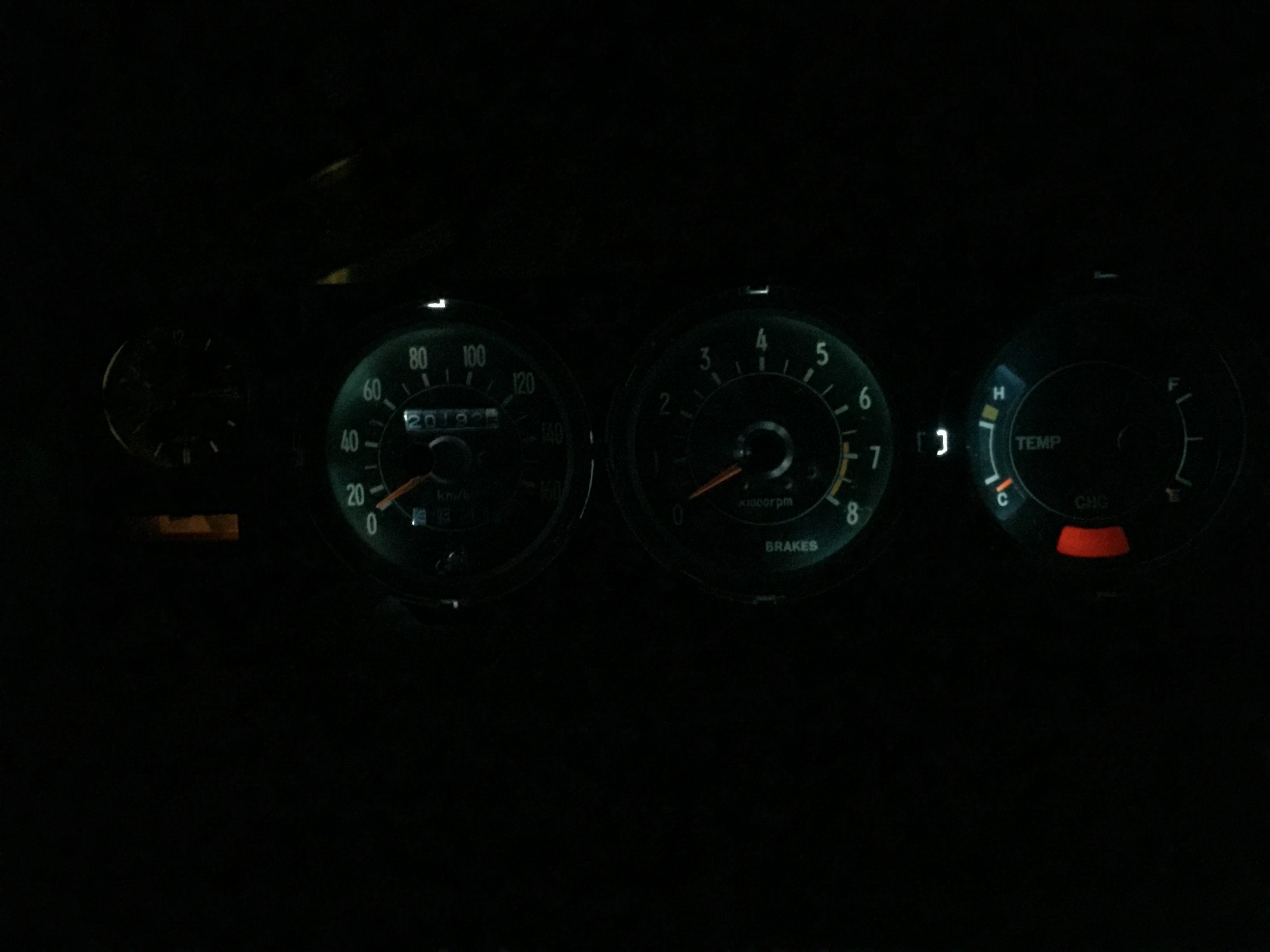

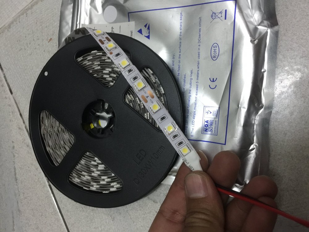

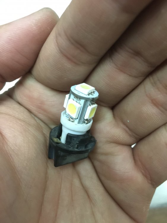

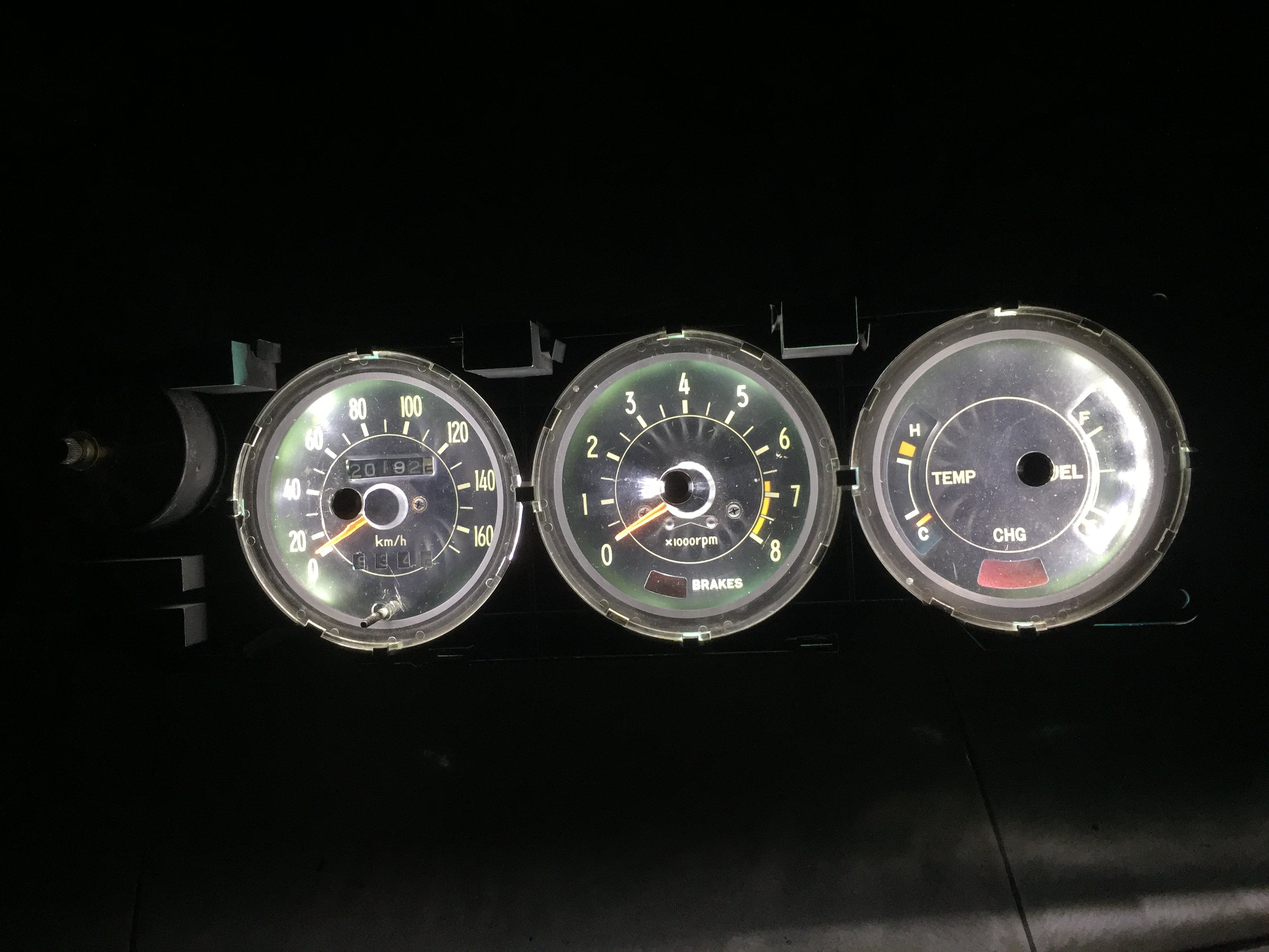

October 26, 20188 yr Author comment_715767 just want to share my upgraded meter cluster to led , thanks for the idea guys . bought the led strip from local store , here's the sample picture at first i planned just to lay the led down like the link you shared but i just stick the led strip all around the corner since it has a little bit of space which it fit perfectly. for the wiring , i just soldered it directly at the t10 bulb socket (red wire to positive side and black to the grounding side) and that's it . here is the before and after before, with t10 led after, with led strip ( the colour slightly off maybe because of my camera effect , actually its pretty nice in reality , you get the idea) hopefully this thread will be helpful to those who wanted to upgrade their meter cluster light . thanks for the idea @Banjo Edited October 27, 20188 yr by saif317 Report
October 30, 20188 yr comment_715780 That's brilliant ! Probably a little bit too bright. I got a roll of those LEDs. They are great. Use them for various lighting requirements. You can build a simple dimmer for LEDs, using a variable Pulse Width control. Plenty of circuits on the net. https://www.youtube.com/watch?v=n48GemL7tsc Cheers Banjo Edited October 30, 20188 yr by Banjo Report
November 1, 20188 yr comment_715799 holy moly that looks bright. I reckon you might need to be Corey Hart to drive that at night. Report

November 3, 20187 yr Author comment_715819 On 10/30/2018 at 12:55 PM, Banjo said: That's brilliant ! Probably a little bit too bright. I got a roll of those LEDs. They are great. Use them for various lighting requirements. You can build a simple dimmer for LEDs, using a variable Pulse Width control. Plenty of circuits on the net. https://www.youtube.com/watch?v=n48GemL7tsc Cheers Banjo thanks for the tips bro , well actually it's not that really bright .. as mention before, maybe it's just the camera effect that made it looks pretty bright in picture. in reality , to me its not that bright. another tips for those who wanna reduce the bright , you might want to use less led compare to mine. Report
