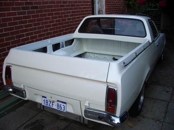

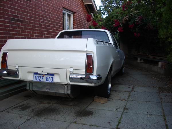

1) Custom drop tank. I've had this idea ever since I started getting into KE3x-5x models, I've always liked the idea of being able to improve the boot space and have the car looking tough as at the same time. Only problem with drop tanks that I've seen is if they are too deep, they end up looking like 'old-school rice'... in other words tacky. I've got a couple of pictures of a HK ute (dad's 'project' car, which isn't his, as confusing as that seems) thats right on the border of being too big. But its been custom fabricated, so heres proof it can be done; post-684-1150122185_thumb.jpg
It can be done by any competent fabricator, whether its legal or not....

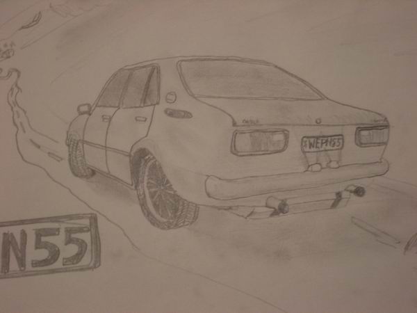

Sketch of the drop tank idea, note how far the tank goes underneath the car - KE55s have alot of room underneath once the spares been cut out...
I've got a KE55 Sedan thats had the spare wheel well cut out, i'll take some photos of just how much room there actually is underneath it
Haha f@$ked up on the sketch so i turned it into exhaust :thumbsup: weird, huh...
