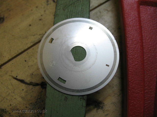

The simplest thing you can produce, if you need a distributor "degree wheel", with missing tooth, is build one yourself, using an old Corolla dizzy, & locking it up, & adding a Nissan degree disk.
Here's one I made a few years ago.
The trick is to use the Bosch dizzy, rather than the Denso dizzy.  The Bosch dizzy, fitted to many later K Series motors, was physically bigger in diameter, & can fairly easily squeeze in the mechanism, from a later model Nissan dizzy.  The Nissan dizzy, has an optical sensor, & a number of different stainless steel disks available, including missing tooth.
Here is another setup I found on the net, that someone was adapting to his engine.  Don't really know, from where it originates.  Mitsubishi ?  Nissan ?
Sometimes easier to mechanically adapt something, that already works, to your application.  Some one on here might recognise it ?
Really easy to lock up the Rolla dizzies, by taking out all the springs & bob weights etc.
There is a guy in Sydney somewhere, who can laser cut or punch out these disks, in any format you need or want.  I know Adrian (Nesta/Rollaclub) got one a few years ago, when he was playing around with 7K EFI systems.
I might have a couple of S.S. disks here lying around, if you want to have a go, at making one yourself.

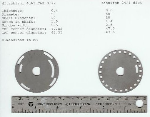

    I was also looking at something like this from yoshifab
https://yoshifab.com/store/billet-redblock-dsm-cas-adapter.html
It's a small/short Mitsubishi cas on top and so in theory they can adjust the adapter to suit any engine, I've emailed asking if it can be adapted for the mighty 3k engine and I'll let you know what they say

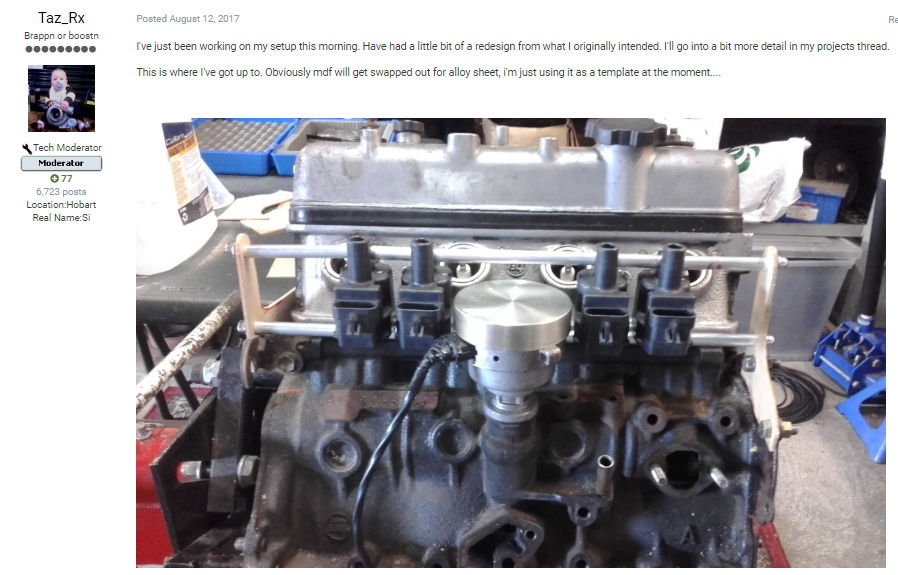

TAZ (Si) produced a Dizzy with a loverly spun aluminium cover a few years back, that I believe he might have fitted a Nissan CAS therein.
Drop him a PM, & find out what he used.

Hey Taz,
    thats awesome, and certainly great news that its reliable. I assume you fitted it to the bigger bosch diff housing? what ecu were you running? however i might see if i can grab the parts and hack up a new dizzy i bought off ebay and make it fit as yours looks like a nice solution.

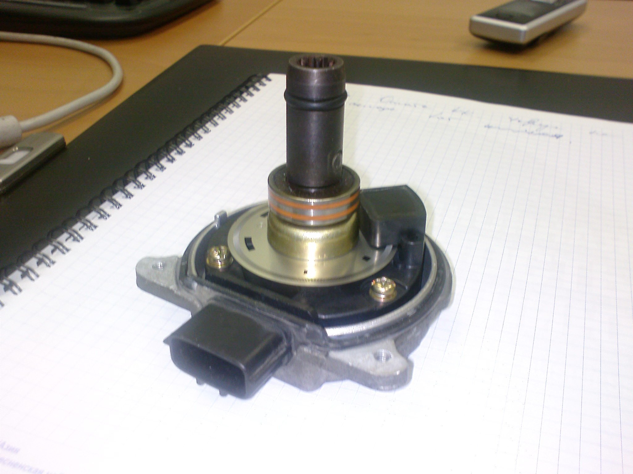

                I'm almost certain that TAZ used the Bosch dizzy housing, looking at his picture. None of those Tridon CAS modules would fit in the 3K/4K Denso dizzies, which were much smaller.
The CAS used was from a Nissan SR20 4 cylinder engine, which was very popular.

The CAS gives you one or two signals, depending on the type of disk used.
Some of the disks have many evenly spaced slots circled around the edge, plus a second single inner slot.
The inner single slot tells the ECU where the crankshaft is in its 720 deg rotation. The outer slots are then counted from that point onwards, to time everything.
There are some disks with only one circle of slots, but usually has 2 or 3 missing slots.  The ECU detects the ",missing slots", & uses this as the reference point on the crankshaft.
Most ECUs start counting from this point, & usually add the 2 or 3 missing slots to the count, to work out where the crankshaft is.

P.S. If you purchase a SR20 CAS, it will probably not come with the plug for the external wiring.  You'll have to source these on-line some where.  eBay has a good selection.

Yes it was the bigger Bosch housing and I'm running a Wolf 3D v4. But old and antiquated but it does the job.
My triggering is set up as dual pulse. The stock SR20 disc has 4 slots in it, which get bigger as it goes through a rotation. My ECU uses the leading edge of these slots (So it doesn't vary) with an additional hole I drilled in the disc at #1. That gives the ECU it's 'home' signal.
Remember when using CAS/ camshaft trigger it's only 360°.
