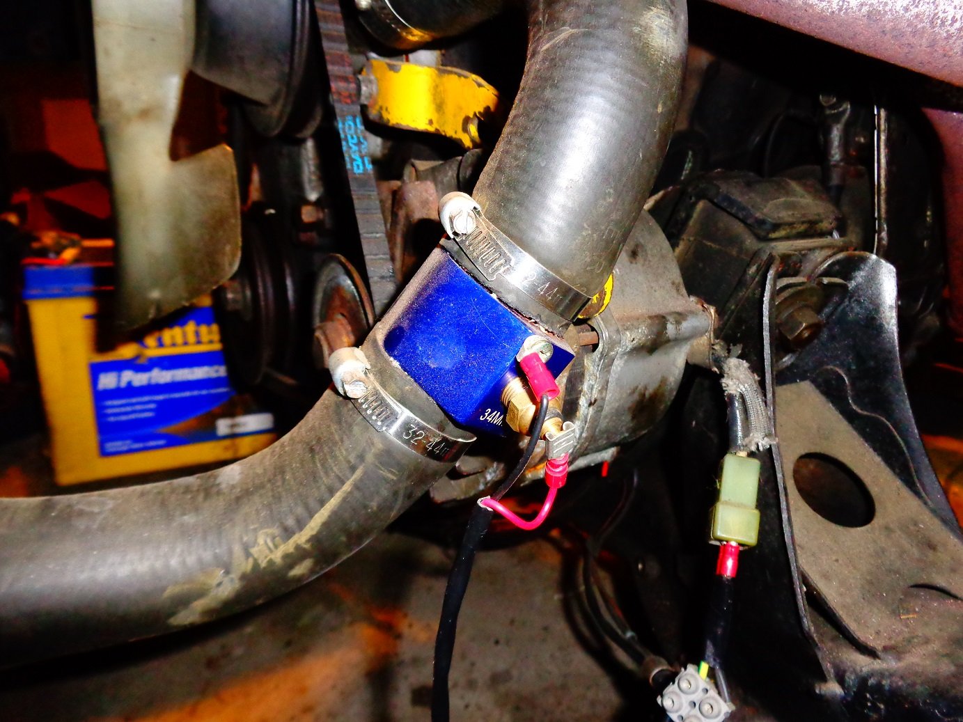

I used one to measure the temperature drop across the radiator, on my engine on the test stand.
I already had a sensor at the top of the radiator, near the thermostat, so just needed a point on the lower outlet side of the radiator, so just cut the hose as shown.
I think the one to suit your application is the 34mm one.  Pretty sure the top & bottom hoses are both the exact same size.   Remove top hose & check before ordering.
I think the Tridon 90-95 deg switch has two (2) insulated terminals, & won't be an issue.  However, when using these "hose adaptors" to mount a temperature sensor, you have to be aware that the adaptor itself, is one connection, but it is isolated from the chassis earth/ground, as it is insulated by a piece of rubber hose on both ends.  Hence why there is a black wire in the pic above, to ground the aluminium adaptor to the chassis.

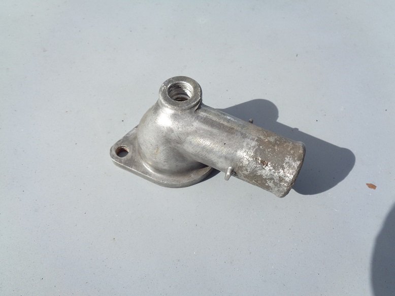

Another even cheaper, & maybe easier way to fit the Tridon switch to control your thermo-fan, would be to simply drill a hole in the top of the existing aluminium thermostat cover, where the top hose attaches, & thread it, to take the Tridon switch directly.
I did this on my 4K engine, as depicted below, & it has been working perfectly for years.

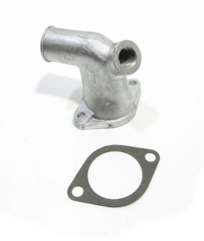

There is even a K Series thermostat cover, that has a threaded hole in the top of this cover, for a sensor or valve, but I've only ever seen one, in all my years playing with Rollas.
There is a Toyota thermostat housing cover from an 18R motor, which were fitted to Celica RA23s through to RA40s, which had a threaded hole.  I've never seen one of these in the flesh, to see if it would fit the K series motor, or whether, the spout would point in the approximately required direction.

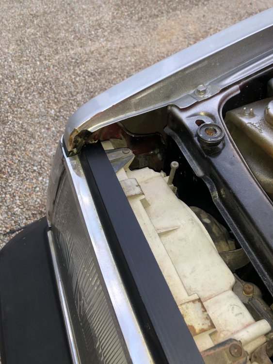

Secondly, was hoping someone new if i could buy this part on ebay or something (below photo, slant front). Ive tried to search ke70 slant front corner light bracket / housing but can't find it. Maybe theres a proper name?. i messaged a wrecker hoping they can ship one over, just waiting on a reply.
I tried to edit a line in, but apparently it comes off. Its the red black thing in the corner, left side of the headlight. (connects to the corner light and headlight)

I can't figure out what you want for the headlight, I had a look at my slanty and it looks like that one in the photo but without the dent! Maybe another photo..

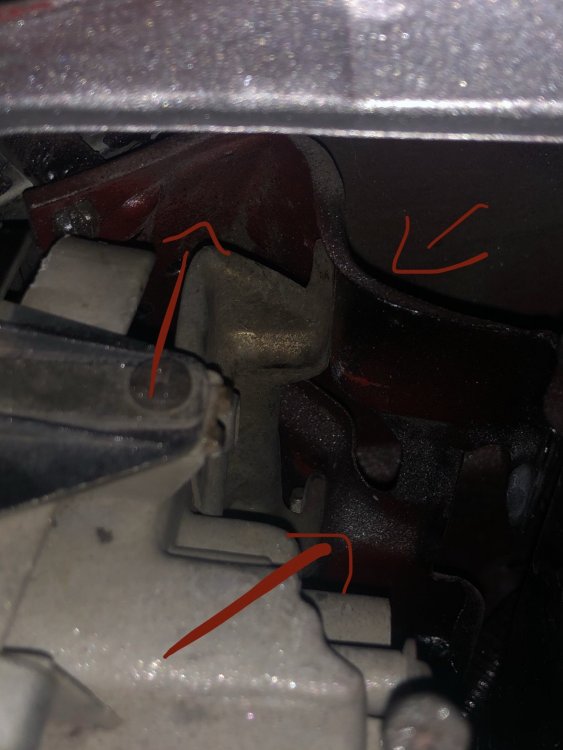

Had a feeling it was a bit vague of a photo but wanted to show the location, here’s a close up. My left hand corner light has nothing and was glued on, is now zip tied on.

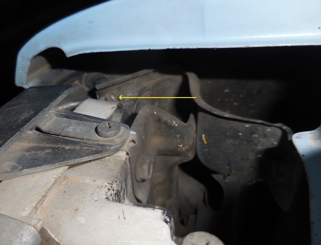

OK, it should be screwed from the front, right through the light and into the frame behind. The end of the screw is shown by the yellow arrow. Of course the moment you have a little crash, that's the end of that corner..  See what you have in that spot.
