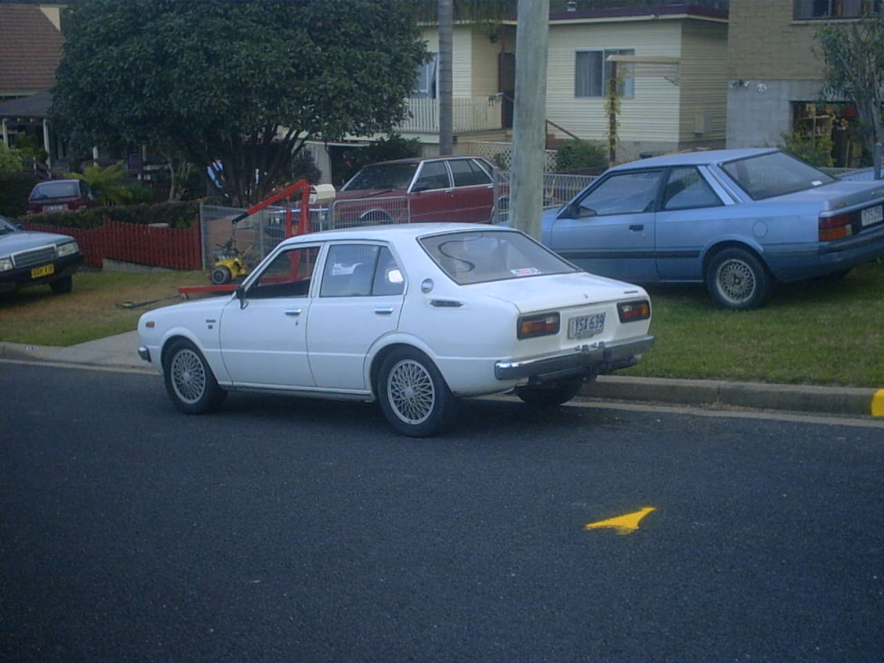

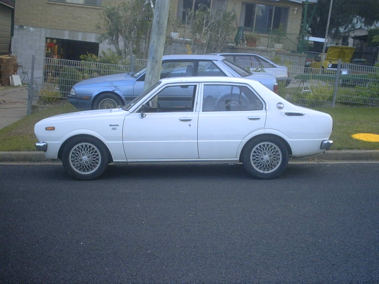

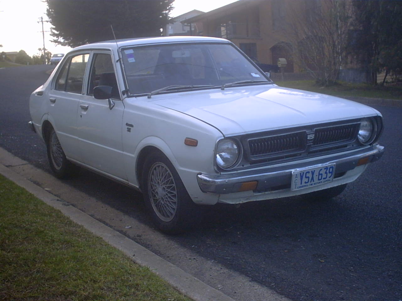

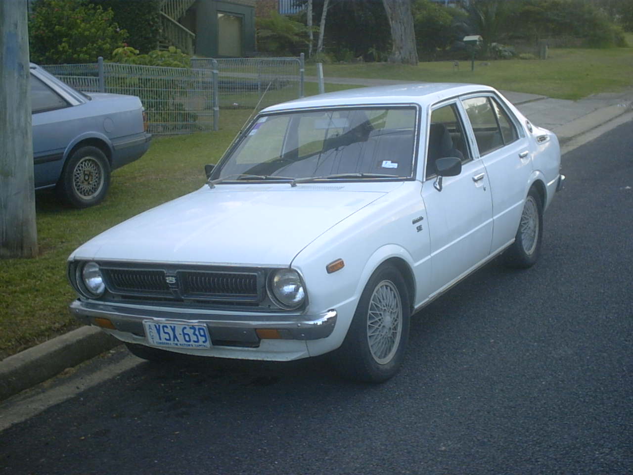

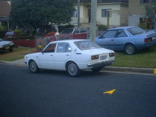

I was just stumbling around my hard drive and thought I would post up some pics of my old KE30

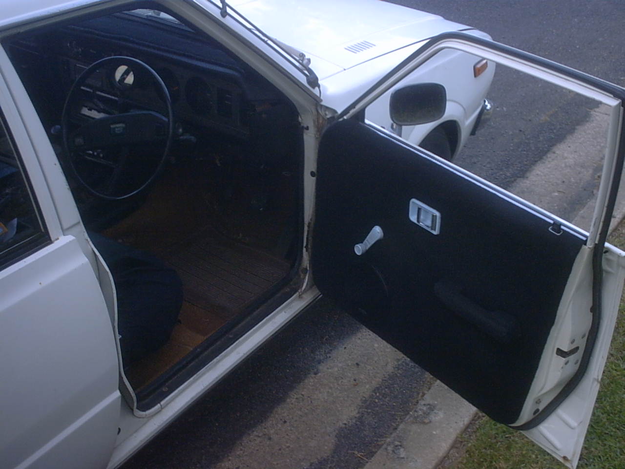

:faq: Neat little ride there. KE55 door skins??
Abit off topic but what years did the front apron come out plain, and what years did it come out where it flated out in the front like your white corolla there??
Edited by JiP_01
No idea, and yeah they are late model square headlight model door trims, I took them out of my old one. They are HEAPS better :faq:
yeah, i agree with the door trims.....you get third degree burns if you rest your arm on the hot metal after its been in the sun for 6 hours..... :D
yeah, and when you're repainting you don't have to worry about the inside :faq:
Nice looking ride, are they the same TRX rims you got now?

:faq: I kinda like the KE30 door trims. Hell if i'm gonna get burnt its not gonna be from the strip of metal on the door but from the vinal seats. (Ouch!!)

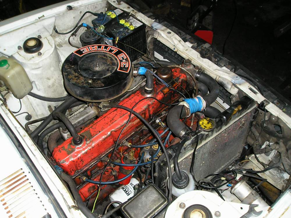

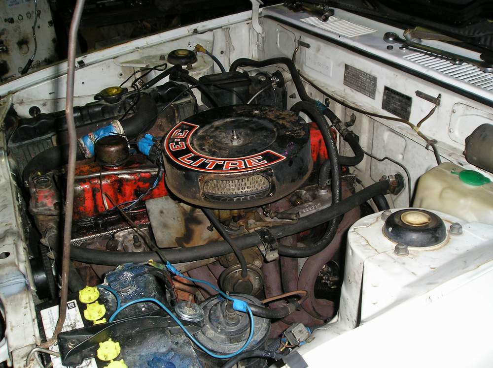

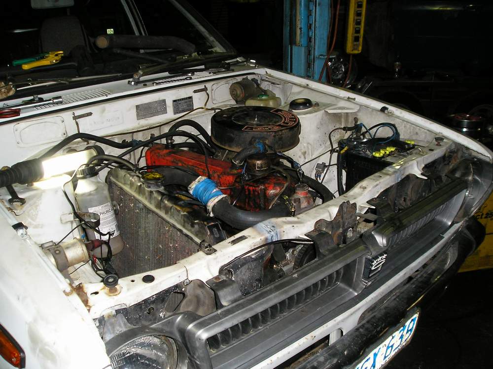

Twas just a shitter, paid $600 with 10 months rego and 4 brand new tyres, new starter, new ignition, new front struts.
I just drove it for 2 years, then this happened.....
Nice one :faq: did you have any cooling issues with the radiator being mounted sideways?
All was fine....then suddenly it started running hot...so we put a commodore radiator out in the front of the car, and it ran hot still....So the problem ended up being the "new" water pump's impella had fallen to pieces, so old water pump back on...corolla radiator sideways back in the engine bay...all good again.
