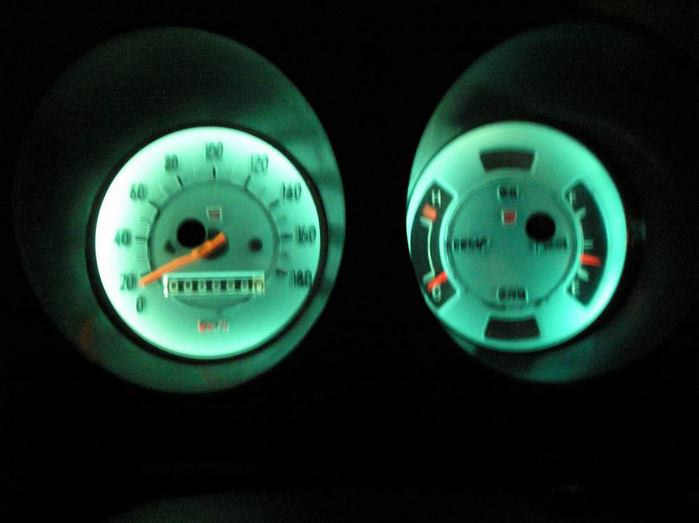

With the raised lettered KE55 cluster, I just took it all apart, spray painted the faces of the gauges, and then went over the needles, and the letters and the numbers with a tiny paint brush. It was a pain in the ass, but well worth it.
I then bought more powerful globes for the dash, and blue "socks" for the globes, and at night it looks unreal (I will get a night pic soon)
I painted my faces sky blue, as that was the colour of my old Square headlight KE55, and had spare paint left over. White would look just as good.
These came out looking really green in this pic, I can assure you they don't in real life
hay rola boy that gauge cluster is awsum!!! i might have to have a go at doing that myself!!!,
