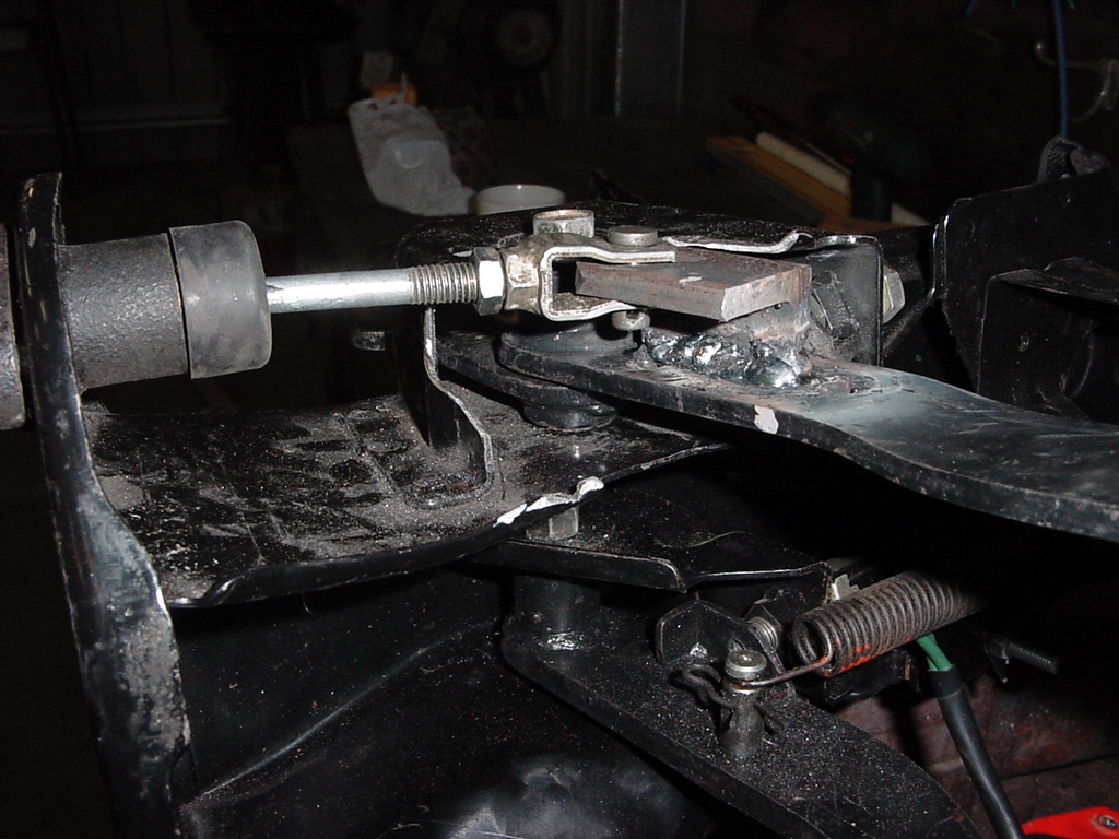

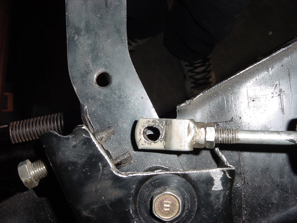

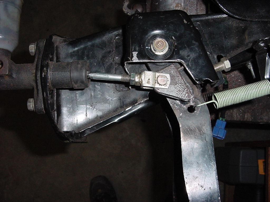

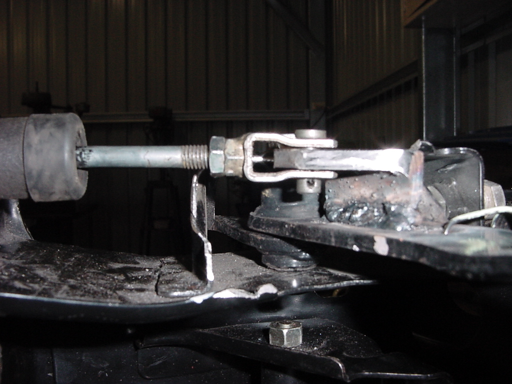

ke30king Posted July 24, 2006 Report Posted July 24, 2006 you need to use a hydraulic clutch. is your rolla auto or manual if its auto you will need a manual pedal box and you will need to modify the engine mounts to move the motor forward about 20-25mm if you have any questions on modifying your pedal box just pm me for some pics. cheers Quote

ke30king Posted July 25, 2006 Report Posted July 25, 2006 you can't use the corolla engine mounts because they wont bolt on but you can use the ta22 ones in the rolla x-member. i will post some pics up in a minute. i used a celica clutch master cylinder and fluid lines. Quote
styler Posted July 25, 2006 Report Posted July 25, 2006 (edited) you will need ta22 mounts like ke30king said, from rarespares.com.au or americanautorubber.com.au or possibly repco.com.au the engine can bolt in but it will be too far back and on a slight tilt. yeah look at jonnys site for how to modify it correctly. and for the clutch, its most common to use a ta22 manual pedal box and use the clutch pedal section on the corolla pedal box, weld on i would imagine. or as above modify the corolla pedal box - havent seen that one before! Edited July 25, 2006 by styler Quote
