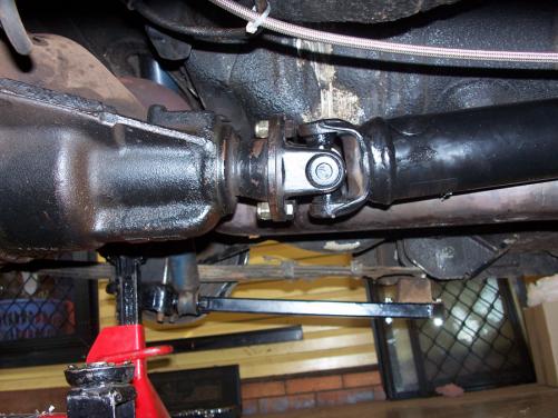

traction has improved alot with the fitment of some good tyre's since i have now opted for a street slick,
as for axle tramp i have only experienced it once at the drags with a bit of a clutchy launch.....
but nothing on the street.

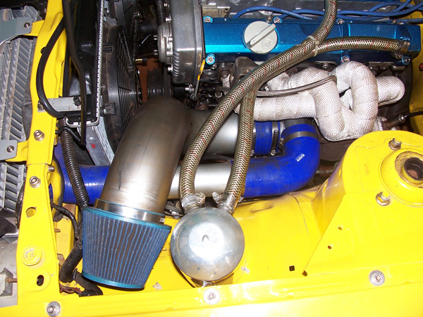

here are a couple of more pics

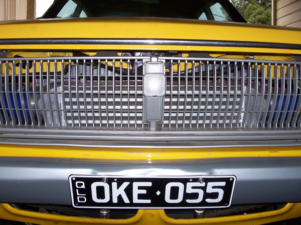

the cooler
and a new filter pipe (still to be painted)
next mods will include an air box with cool air feed

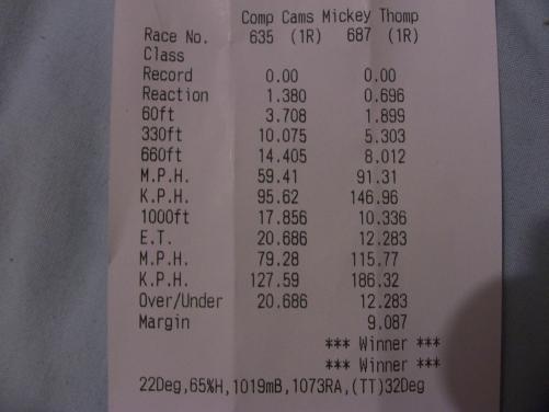

was the 12.857 with the use of nitrous or without?
without the nitrous.. the nitrous hasn't been run yet it will be getting tuned with the gas on the 18th of this month and that time was with 213.7hp at the wheels

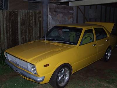

I also own a KE55 Corolla just with a lot less mods than yours. I have though got hold of a 4AGE 16V and a celica box. I know that I need to upgrade the brajes but I don't know what to put in. I thought that the only way to put bigger brakes on was to replace the whole strut. So what have you done. Also here is a pic of my car

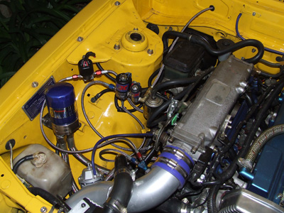

the nitrous is a fogger sytem only cost $700 has anything from 35 - 350hp
the car however will only be fit with a 35hp shot which will increase the power by around 20hp at the wheels
Here are the pic of the finished install
and a pic of KAZ purging nitrous (bottom)
