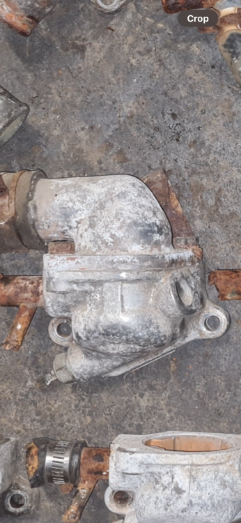

4k/5k head (Thermostat housing compatibility)
Thomas Dillon replied to Thomas Dillon's topic in General Discussion
Hey fellas, tezza - A twin cam 4k?! The f*ck. Some people are too smart ahaha! They’re bloody epic cars, this is my 5th one. All the ones I’ve had in the past have been built by others. Good to go ham on this one myself (and try to do things properly hahah) What do we think about a beams 3sge swap? Banjo - your efforts are outstanding! It’s such bastard ay. However on a positive note I tracked one down in just over 24 hours and it on its way hahah. Pic attached. Hopefully this does the trick I just need to have a fiddle with temp gauge sensors, I also need a port for the fan switch, may need to run a twin T fitting if there’s only one tapped port on the bottom of the housing. shes pretty ugly but a good scrub up with some scotch bright and she’ll be brand new haha ill touch base when she arrives felllars, cheers -
Banjo replied to Thomas Dillon's topic in General Discussion
Hi Thomas, As I expected; when You reverse the standard top hose spout cover over the thermostat, it leaves a small gap, for the coolant to pour out. However, on the opposite underside of the thermostat cover/spout; the gap is not very wide at all; but there still is a gap. Because the gaps are pretty small; You could possibily cut a piece of flat sheet metal, to cover these holes, with a big round hole in the middle. You'd also need to cut a appropriate gasket either side of the flat sheet metal plate, & use gasket cement, to make sure there are no leaks. Might be an easier solution, than trying to source one of those reverse spouts, that I didn't even know existed. Cheers Banjo - Today
Hi Thomas, Superb little project ! That last link, Attezzaclub posted goes back nearly a decade & a half. After reading it again, I'm starting to feel "olde" ! Keep up the good work; & keep posting pics thereof ! Cheers Banjo - Yesterday
The centre line between the two mounting holes, does not pass through the centre of the open area. It will probably bolt down OK, but will leave a slight gap on one or both sides, which will leak or blow, with minimal face to face, one or both sides. I'll try it tomorrow, & see. Cheers Banjo -
In theory, they visibly look like they are, (says He scratching his head), I'll have to go out ito the garage & try one. (too late in the day, is my excuse !) Cheers Banjo -
altezzaclub replied to Thomas Dillon's topic in General Discussion
Why don't you just turn the outlet around 180deg? Aren't they symmetrical? -
Banjo started following 4k/5k head (Thermostat housing compatibility)
Frankly, after all the K Series engines, I've seen on the net, & in real life; I can't remember ever seeing one with the top outlet spout, pointing towards the RHS. All the ones I've seen point towards the LHS; as on my 4K test bed engine below. That is definitely a 5K head. It was the only K Series head with two "knobs" in the casting under the end spark plug sockets, I'm led to believe. The crankshaft front pulley, looks as if it is 5K. The two sandwiched pulleies were common, as the 5K engines were used in Toyota forklifts & the like, & drove various pumps/compressors etc, off the additional pulley. However, the front camshaft sprocket cover, does not look 5K, as the timing chain marks are in the wrong place. Definitely get a top hose outlet, that points in the opposite direction. Will look so much better, in the engine bay. As far as I know, the bottom thermostat housings are all the same, as are the water pumps. Someone correct me, if I'm wrong. Have You had this engine running ? If the block is a 5K, then T.D.C. No 1, will be a bit out, if You line up the crank pulley timing nick, with the timing marks on the camshaft sprocket case. I covered this topic, in a post years ago, when I fitted a 5K crankshaft pully, onto a 4K engine. Cheers Banjo - Last week
Thomas Dillon started following 4k/5k head (Thermostat housing compatibility)
Hi team, Currently in the process of rebuilding a wee kp for summertime skids & coffee cruising. Bought the kp and have come to realise it’s got a dished piston bottom end and what I believe to be a 5k head and have confirm this with the previous owner but it’s all “apparently”. The head has got the two knobs under each spark tube at both ends. Anyway, I’ve turfed the facto radiator and electric fan and have gone for the Fenix ke70 ally rad/fan shroud kit for maximum coolage when abusing it over the takaka hill. Question being, are the entire top & bottom thermostat housings compatible across the range of 2k-5k heads? My current thermostat housing outlet is shooting off towards the right hand side of the bay if you’re looking at the motor. The Fenix top tank outlet is on the left hand side. Option 1: I run a 180 degree rad hose off the current set up, through a length of stainless and into the radiator. (Not the end of the world). Option 2: we tidy things up and put one of the other thermostat housings on that shoot the other way. basically just wanting to know if they bolt to the head all the same. Really appreciate ya help in advance, Cheers fellars
