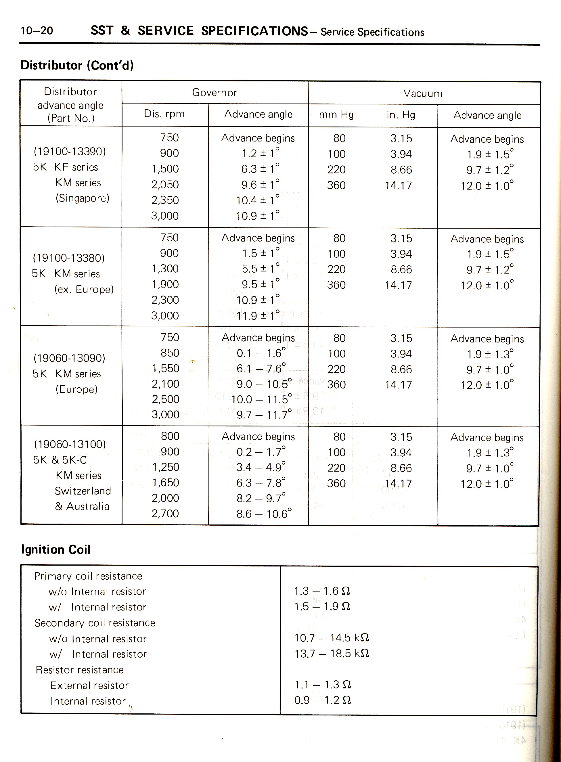

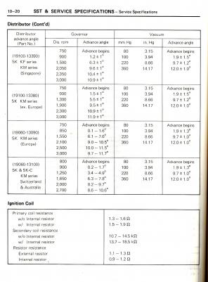

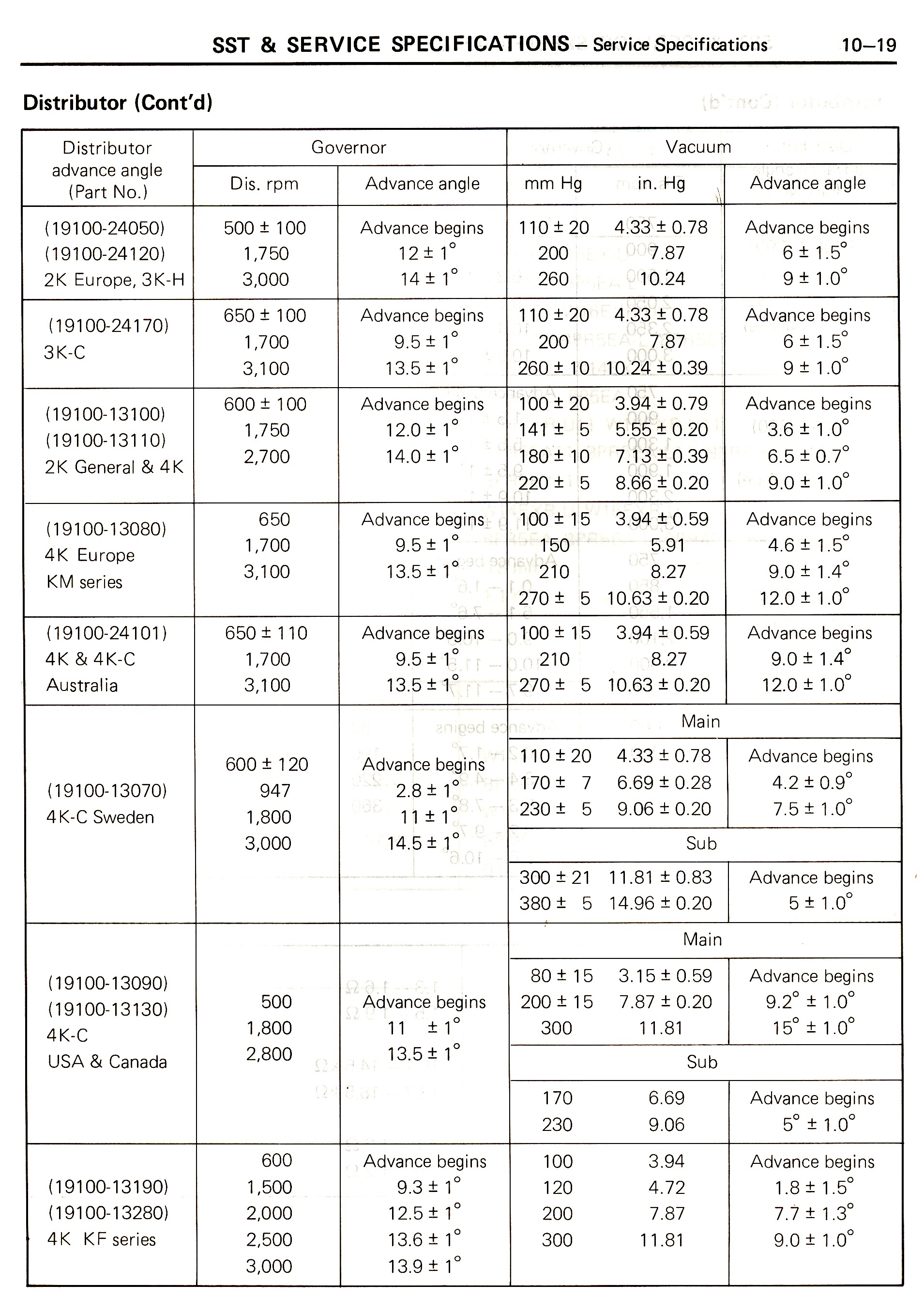

October 19, 200916 yr comment_383525 This might help.... Taken from the Toyota factory engine building manual for K motors. It is surprising what Toyota have printed in some of there manuals here and there. Cheers Cameron Report

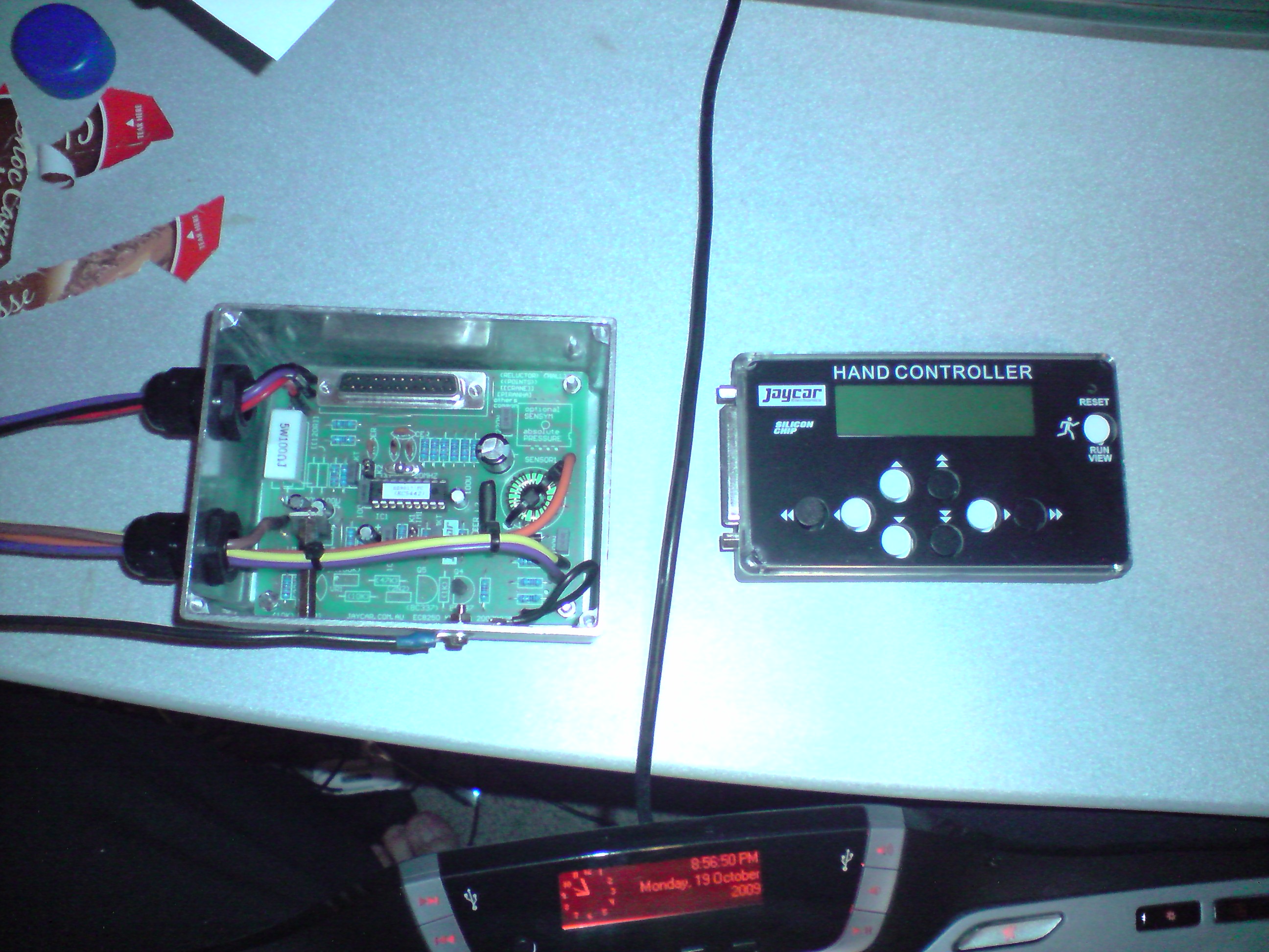

October 19, 200916 yr Author comment_383537 Hey guys, thanks again for your replies. i was going to write a whole lot more but have an eventful day with the head (of the motor :) ) So instead i uploaded a picture of the control system and the hand controller. Oh and is using a weber going to change anything with the vacuum advance?? Report
