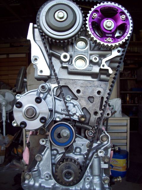

On the weekend I had the chance to put all of this together. I’ll let the pictures do the talking. Comparing the standard HG to the new Toda before assembling. Adjustable exhaust cam pulley with the standard VVT intake pulley to help out with the spooling up of the turbo. The cams have a bigger lift and a longer duration hehe. But wait there is more!

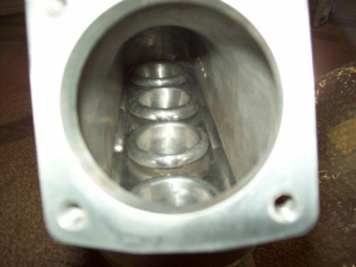

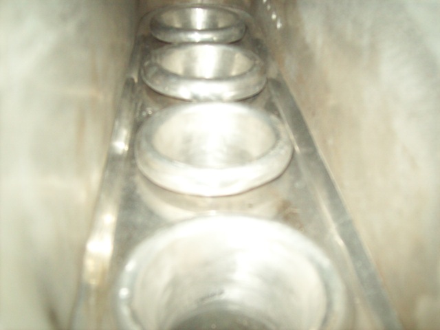

About 2 months back I sent the inlet manifold and head off to Sydney for a CNC port job. I also asked for; Oversize intake valves Oversize exhaust valves Throat oversize (behind the valves opened up to mach the bigger valves) Spring kit & titanium retainers Intake copper seats And to match port the inlet manifold to the head. Couple of pictures before and after. I got all of this back last week, stay tuned !

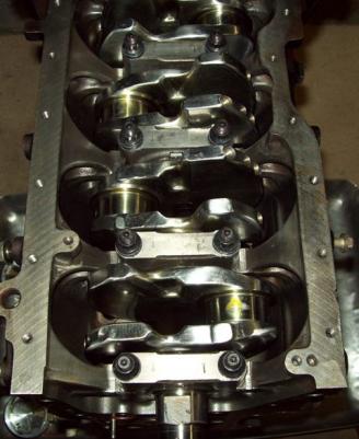

What compression ratio do I have, this is what I got up to on the weekend. I ran a tap down the threads of the mains to make sure the were clean and fitted the ARP Main studs Fitted the crank with assembly grease and torque down to specification. Measuring equipment for finding out the compression ratio. Soluble Oil was used for the measuring fluid I measure the piston dish using a syringe and a piece of plastic with some grease smeared around to seal the plastic to the piston. Dissembled rod and pistons laid out and inspected before assembling. Bolted the rods to the crank (ARP bolts) with assembly grease and torque down to specification. Next I turned the motor over by hand a few times to make sure nothing was fowling against anything. The main thing I was checking on was where I machined the block to fit the 4AGE oil squirters. Now that everything was OK I turned the block over to work out the swept volume of the piston. With all of these measurements and taking into consideration the thickness of the head gasket (and the head cc) I worked out the compression. Then I striped the block back to nothing. This afternoon I took the block to a local engineer to skim a little bit more of the top to give it a compression ratio that I am after for boost (hope to get this back on Wednesday). The head was sent to Rams head service for a CNC port and polish and I told Darren (from Rams) what I wanted the cc of the head to be. I'm hoping I will get the head back this week. And lastly I picked up the exhaust manifold plate (12mm) this afternoon that was drawn up on CAD. This is the start for the Turbo manifold. All for now
