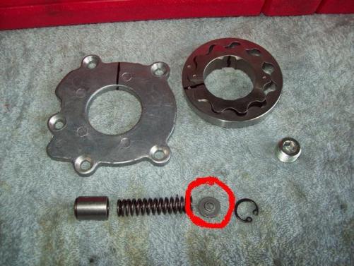

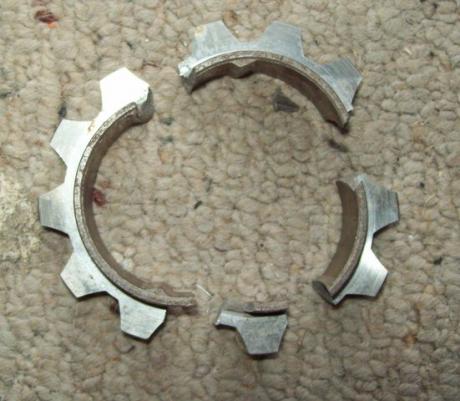

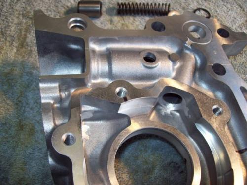

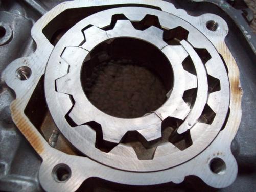

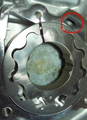

Hi all, On the weekend I made a thicker spring retainer (about 2.5mm) for the oil pump, this will up the oil pressure before the relief valve opens which will pump the oil up to the head where it is needed (from past experiences I should be seeing an oil pressure of about 60 – 70 psi). I also ported/chamfered the openings on the oil pump so it is less restrictive. Not the best pic to show how thick the spring retainer is I know this does not seem like much but in the past I have broken oil pumps with big revs but after this little trick I have had any more broken pump gears. Here is a picture of an oil pump that I broke about 4 years back.

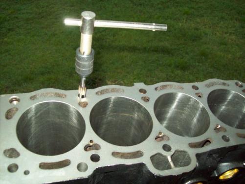

Found some time during the week to clean up the threads on the block before putting the studs in. Hope to do a little more over the weekend.

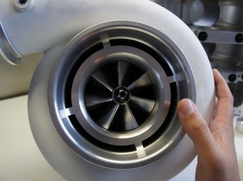

I was joking, that is some random huge ass turbo that I found on the net :lol: . That size turbo would not fit in my little engine bay. But the plan is for a turbo.

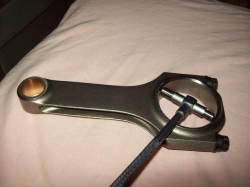

Spool rods! WTF (Wash your mouth out with soap! lol) No not spool these little numbers are a custom job and only weigh in at 430grams and are rated to 600hp+. And forget the “K” series try a “W” series gearbox. :yes:

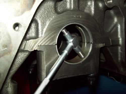

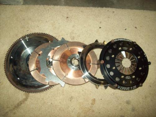

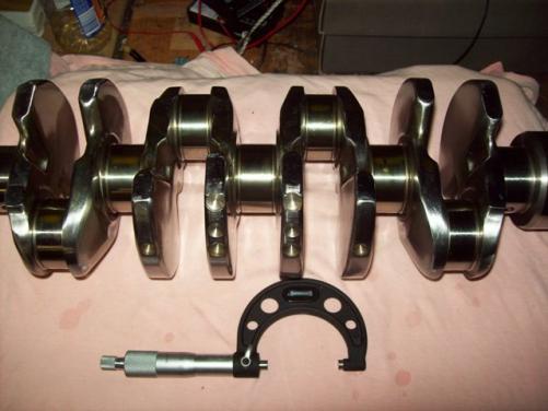

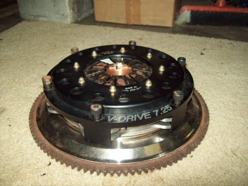

It’s been a little bit busy up here with the cyclones and floods and doing a bathroom renovation but on the weekend I got a chance to measure the clearances I asked the machine shop to machine the block to. Note I will use a plastigauge to check on the final clearances on assembly. We have had that much wet weather up here and the humidity has been through the roof I have a light coating of surface rust over my new clutch fingers and a little on my light weight custom billet flywheel (I have only had it for 2 months). Looks like I will have to get a move on and put it all together soon :devil:
