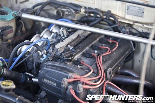

Has anyone converted the dizy on a BT/ST 20V to the front of the motor before? like this one...in the attachment if its easy, would it be a better option than running CAS and coil packs, for those on a budget? found this on http://speedhunters.com/archive/2010/11/03/car-spotlight-gt-gt-20v-ke70-corolla.aspx
