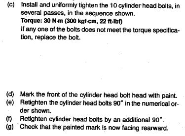

  14. hmmm so 30nm-55nm-64nm or should i just stick with the old 30nm +90° +90° going to be using the old head bolts this time round so only got 1 chance of getting it right( last thing i wanna do is snap the end of the bolt off in the block :jamie: plan is just to do a temp fix for now as the old cash flow is a bit on the light side and in 6 12 months rip out the engine again and do a full rebuild once the cash flow is a bit better ;)
  15. just didnt some more research on it last nite while rc was down i need to go out and get myself a 10m 3/8 longreach socket :jamie: any1 got 1 ta spare they wanna post me ;) oh and thinking bout it i think there 12 point not 16 like i said b4.. but either way the normal 6(hex)sockets are usless on it
  16. who was the pot smoking japman who decide to put 16point bolts on a 4age head... and then make it even harder to get out by puting them in such a narrow gap... :jamie: now i gotta go out and buy another 12mil thin walled socket just so i can get this bloody head off ;) anyway enough QQ'in any1 know the 3 stages of tightning up the head all i can find is this and it dosnt seem that good to me
