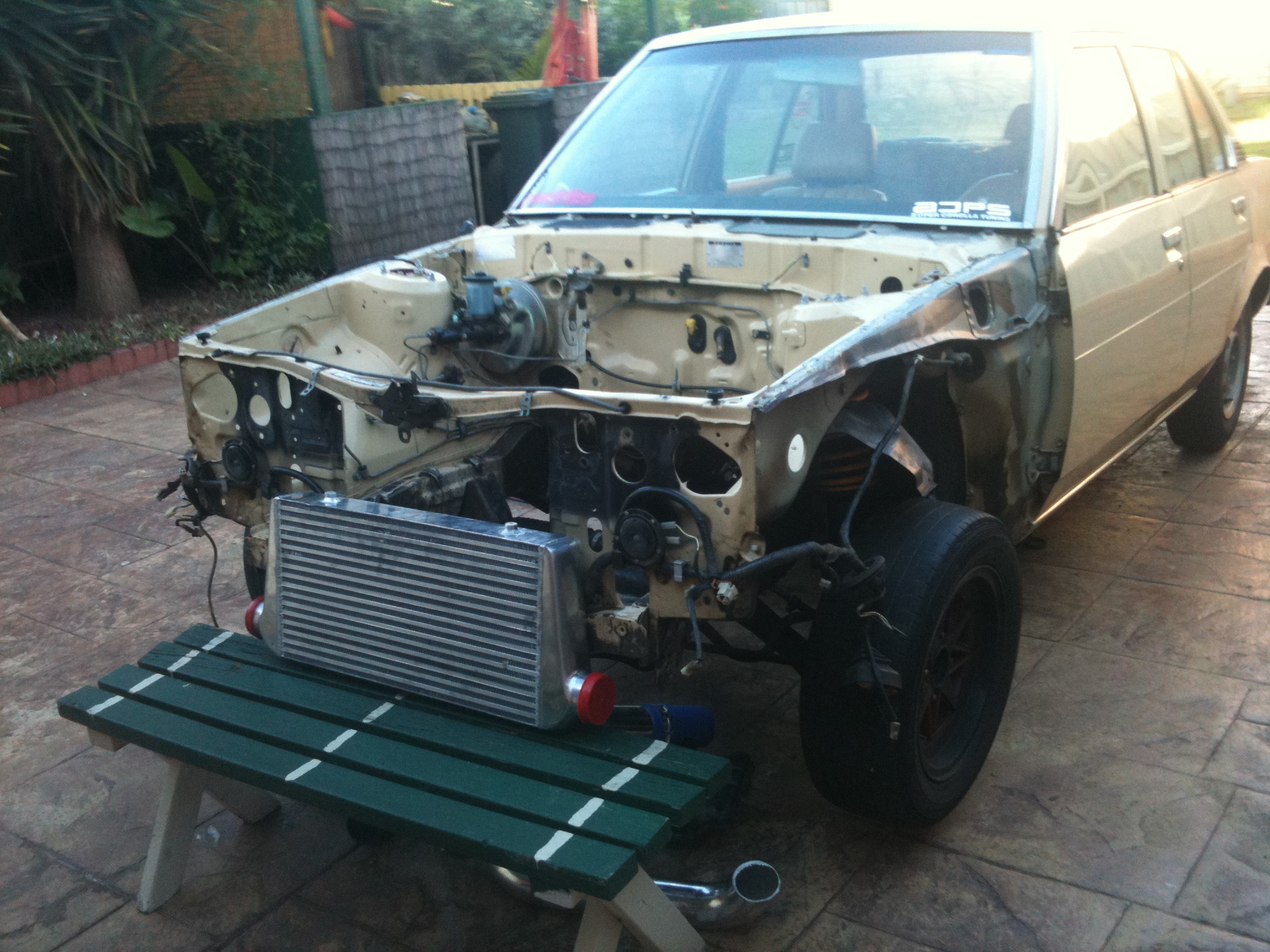

  7. hey all rolla fans, i hav a 1982 toyota corolla better knwn as a ke70, my plans with car hav changed alot over the past couples years owning it.... only after buying it did i know what people were using them for. At first i was goin for a cheap but powerful engine swap a ecotec 3.8 v6 manual was goin to power the little corolla. after doing research i saw alot of people were using 5k's and 4ages as quick and easy swap. i then bought my self a nice little bigport 4age with a t50. after a while of it sitting in the shed, i pulled it down and found it culd do with new pistons thats were i decided to go 7age with a little t25 for a little extra grunt. ive collected alot of little goodies for the build, and now going straight gas, no tunning issues or injectors problems to worry bout. the gas set up will be the simple gas research, dizzy will be converted back to vac... with the line from from the turbo into the gas converter to open it up under boost... and a retard unit to the dizzy to retard under boost, and advance under normal driving. few pictures :)

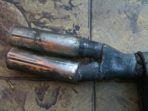

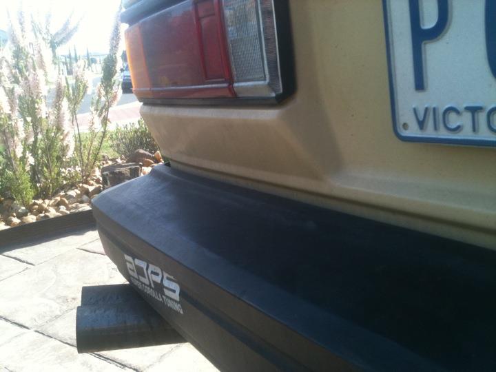

  15. looks good.., do cops giv u much trouble bout them ? had mine for aweek n got a defect for them they poped out about 4.5inchs but urs look much larger...

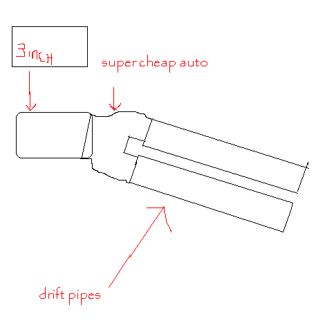

  16. why are u curvin them jus weld the adaptor on an angle, then put the drift pipes on

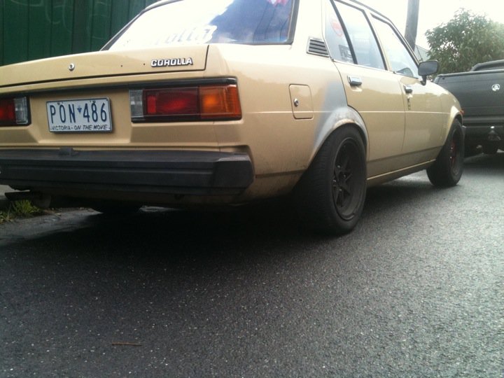

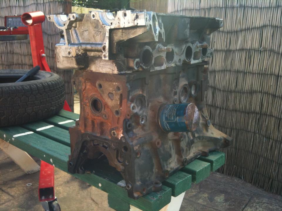

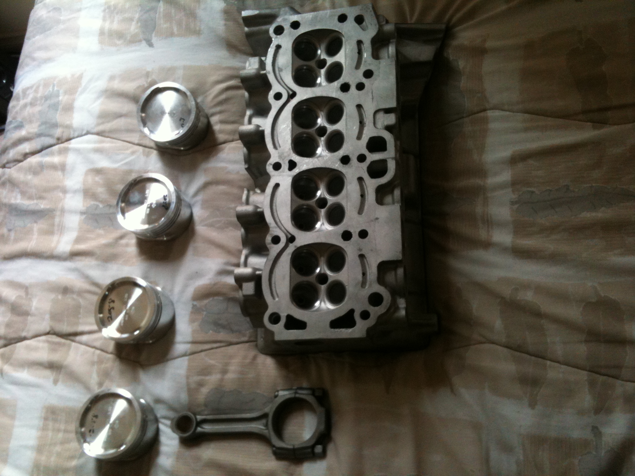

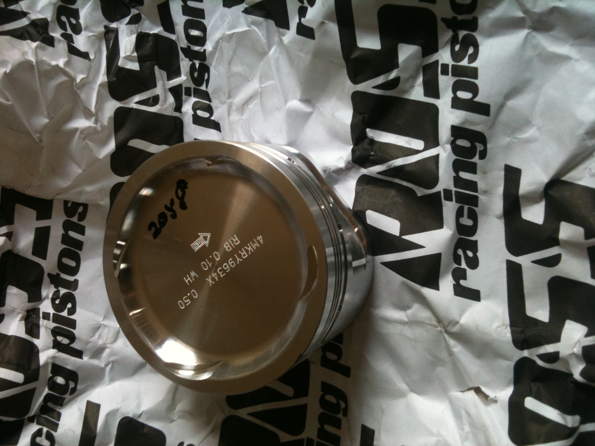

  22. cops in vic are pretty stupid, bein pulled ova countless times and not once did the coppers ask or suspect i had a locker, its not as bad has everyone makes it out to be... leaves trible tyre marks on the drive way, but can only hear it in sarvos.., chopped falcon in the back sprayed yellow got me thru 2 rwc ;) lol make em look good clean cuts... i used kings springs in front as i like a comfy ride still :) dats it after rwc 10.5cm full tank, was the lowest it wuld drop was pretty stiff still.. i used commies wagon shockers to fe2 type good luck
