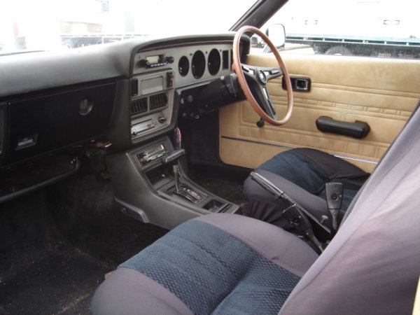

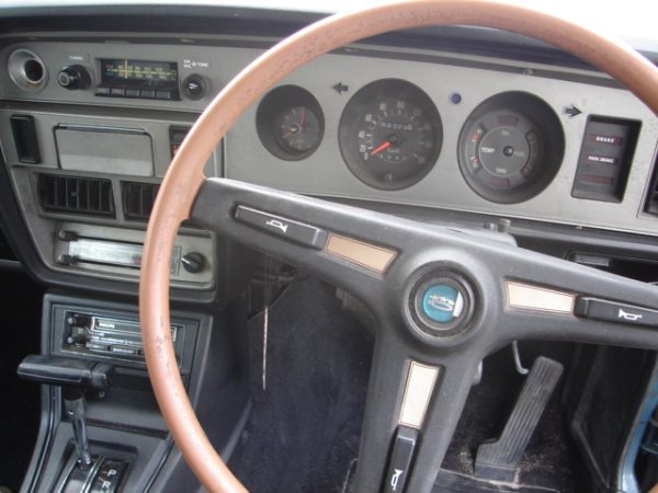

    Ok, some more pics for you all.   Dash is nearly all stripped out (going to total rewire everything as I am fussy at what I do)       Filling in the cracks in the dash pad       I used a

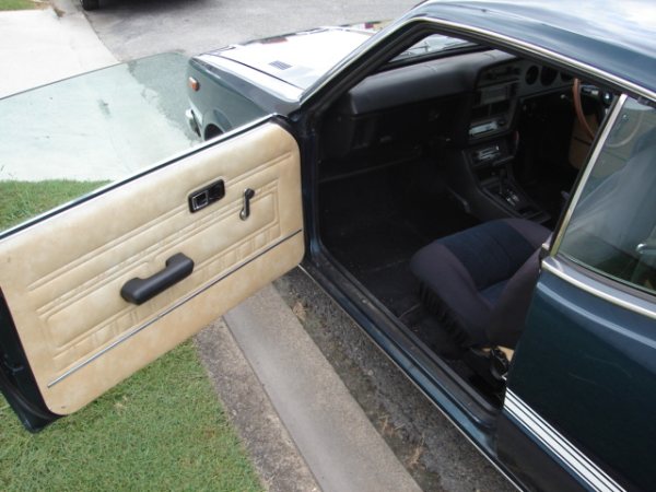

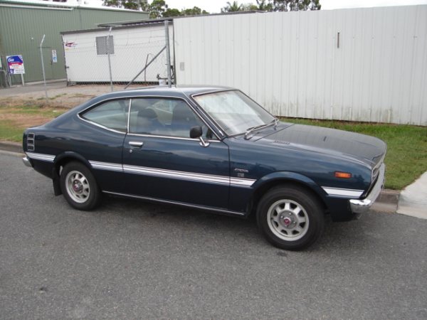

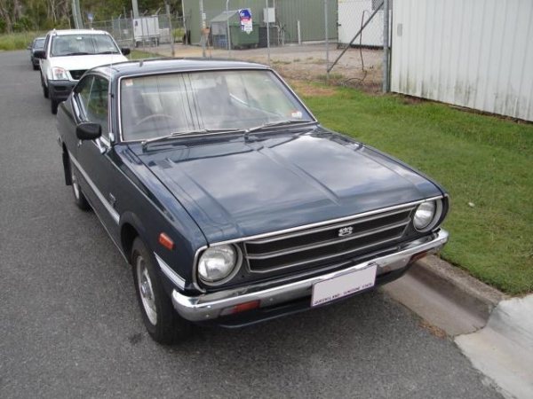

This story started 2 years back, as I was on the hunt for a clean KE35 (I even had mates in different cities looking for one).
A mate in Brissy found a one owner, very tidy KE35 with only 57 thousand on the clock in late January, but due to work commitments I was unable to pick it up until Easter.
Well they say a picture says a thousand words (so here are 9 000 words )

love the color, actually looks simliar to what i was thinking of painting my coupe
do you know what the colors called?
Looks great, keep the pics coming and let us know the plans for it
Sorry I do not have a clue as to what the colour is called as the old girl had it painted a few years back for her granddaughter but the car was not good enough for her.
As for plans, I’ve got big plans for it but for now it lives in the shed and comes out for a leisurely drive on the weekends if the weather is good.

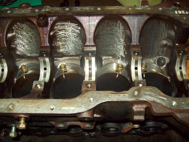

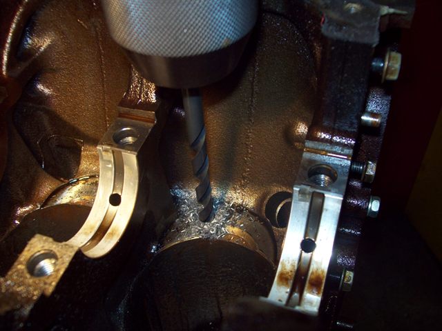

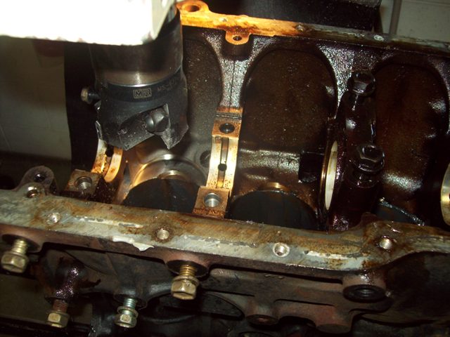

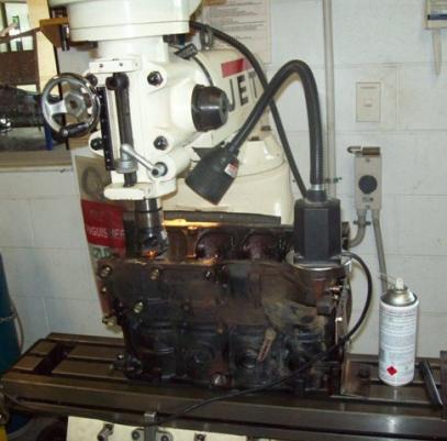

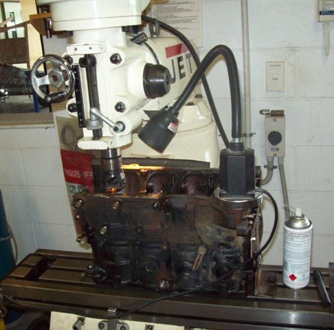

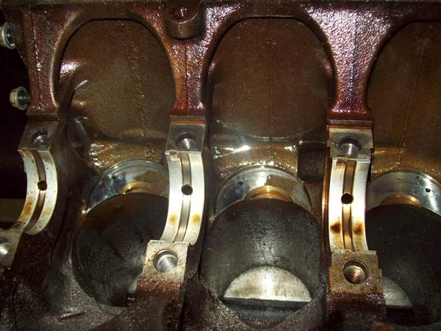

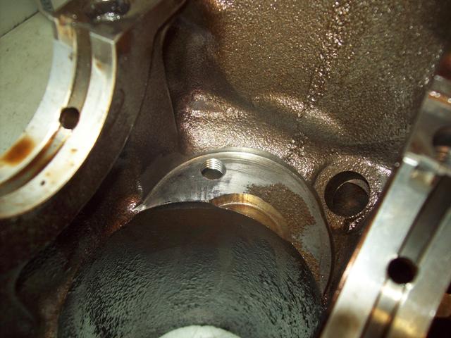

Today I machined the block to fit some oil squirters, using the milling machine.
Here are a couple of pictures.

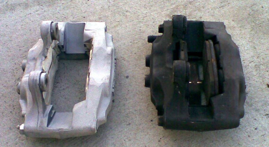

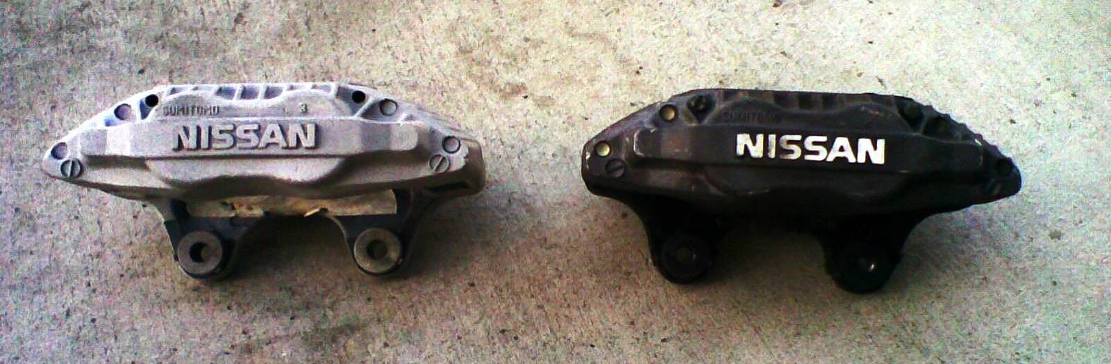

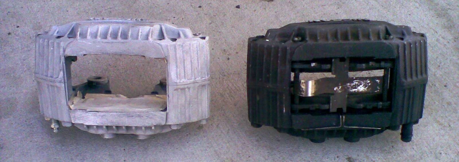

What model are these Skyline calipers off, as I got them from a “break up sale” and she does not have a clue and neither do I.
They are both cleaned up now. The one on the right was how I got them.
Just curious as to what they are off.
they look r32 ISH
they look r32 ISH
Hey its been a while,
But i do believe that they are R32 (was kind of hoping that they were R33's ) but i will work something out with them :)
