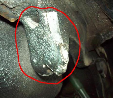

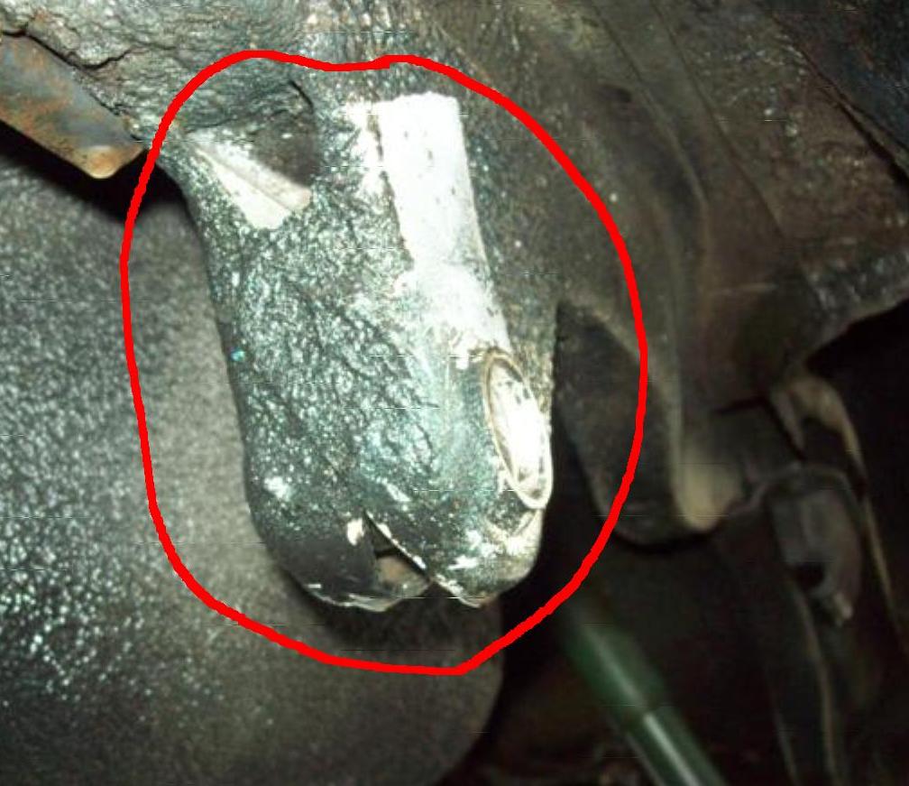

I was under the car today and I came across these tiny little spring hangers.
One day I do plan to run some power and I was wondering how these will hold up? ( I was thinking of just cutting them off and making some new ones out of 6mm plate)
I would like to hear if these little hangers will do the job ?

I never touched mine and it seems fine, seam weld the front xmember, mine started to unpick the spot welds
Well if yours can stand up to the :hmm: , I will leave mine.

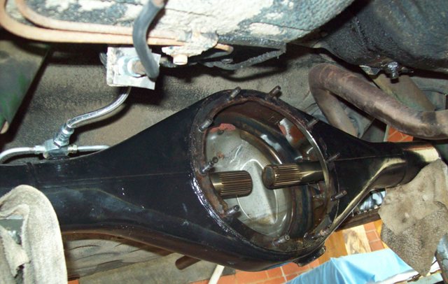

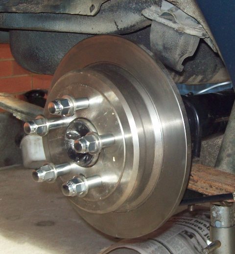

Here's some progress of the diff install.
Its a hilux diff with 300mm rota's and R31 Calipers to pull her up.

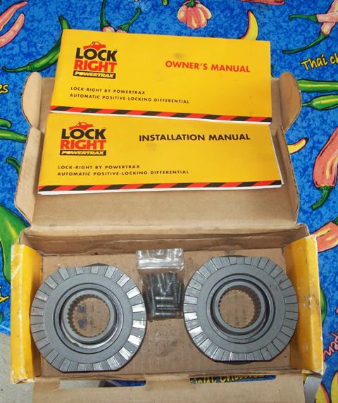

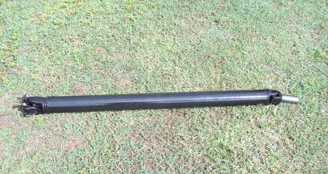

Yesterday I made up a tail~shaft to suit the HiLux diff and I installed the machanical locker.

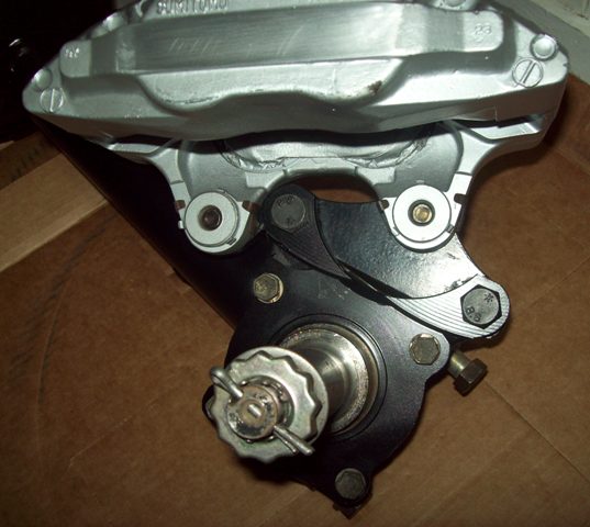

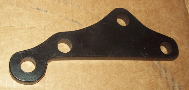

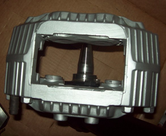

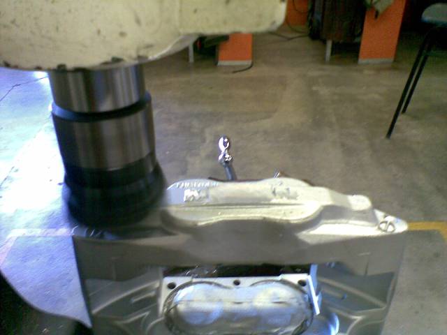

I milled off the "NISSAN" on the calipers.

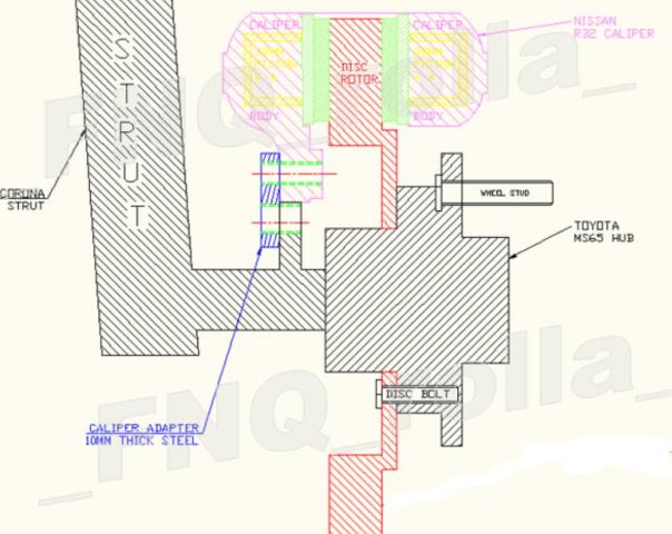

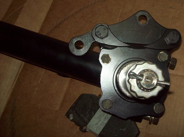

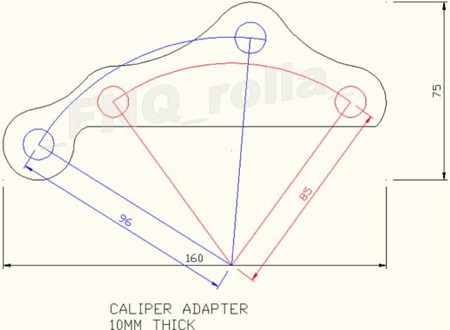

Did a little bit of CAD on the computer to see if things will fit.
Made same caliper adaptors at work on the CNC (sorry i forgot the camera)
Bolted it together to see how it looks (the rota will be bolted to the back of the hub which are on order)
Will post a picture when its all together with the rota and will let you know what parts were used.

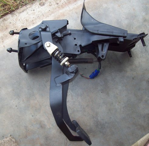

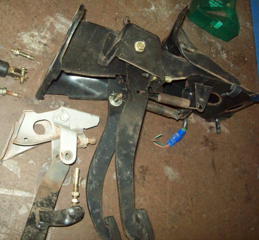

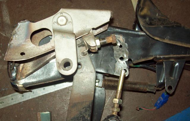

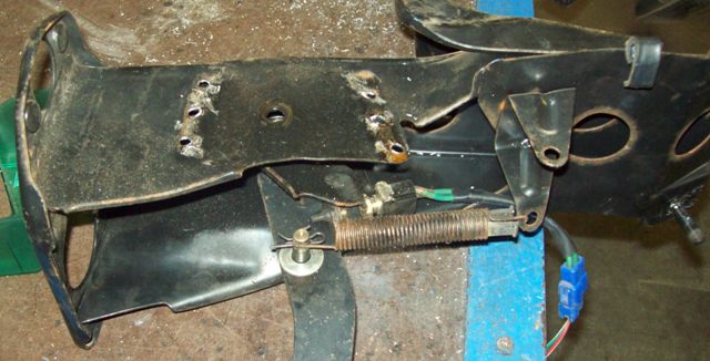

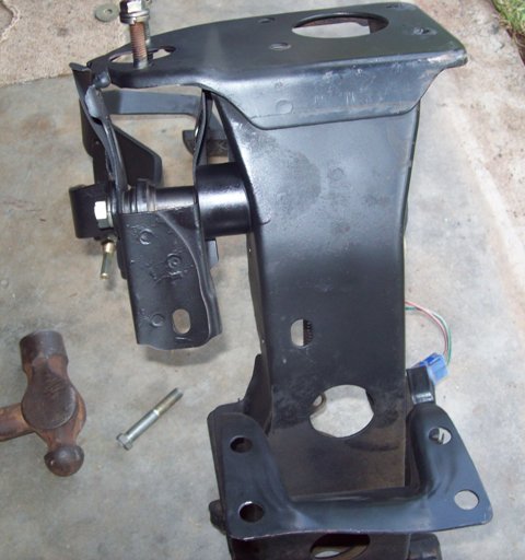

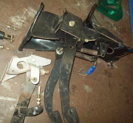

Today I put together a Hydro pedal box for the "Lady"
I had a hydro pedal set up from an AE92 and i thought that it would make an easy setup instead of the cable setup.post-10153-1278658369_thumb.jpg

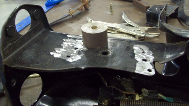

Reomval of the cable setup.

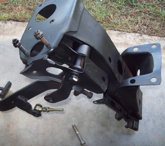

Turned up a spacer on the lathe.

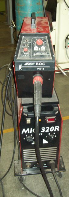

The little mig that was spare in the workshop.
Some welds to hold it it in place.
The finished produce with a little bit of paint Pic 1
Pic 2
Pic 3
Edited by _FNQ_rolla_
wats the springy looking thing?
The "spring looking thing" is the standard SX ~ AE92 clutch return spring which is adjustable
