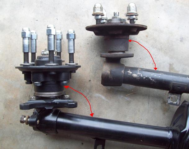

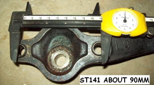

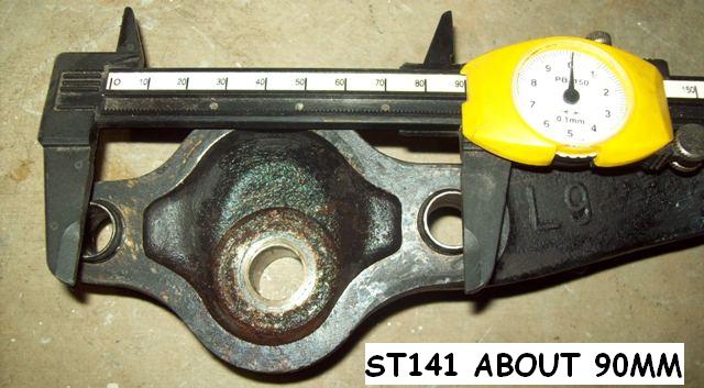

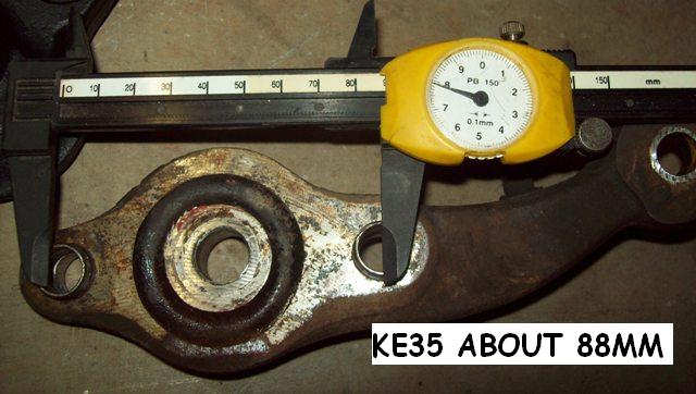

What people forget is the lower arm in all these earlier rwd toyotas are very similar in length. What changes between the models is how close the struts towers are together. So they made a strut/ steering armo combo that's gemotry suits that car.
I was feeling a little down about all the work, I was sure that I had done all of my research correctly.

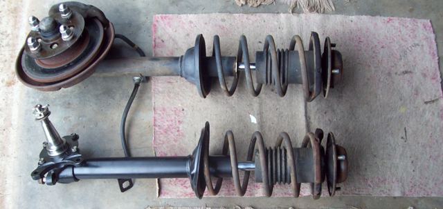

So if the angle between the strut and the stub axel is the same between the KE35 and the ST141 it should be correct.
The over all length of the two struts assembled is the same (KE35 top, ST141 bottom)

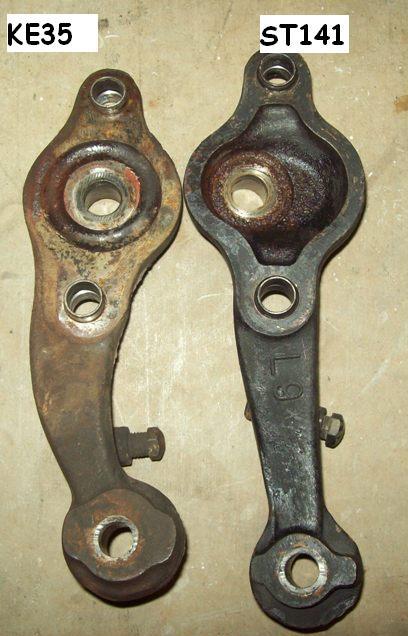

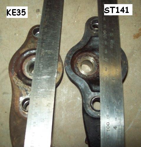

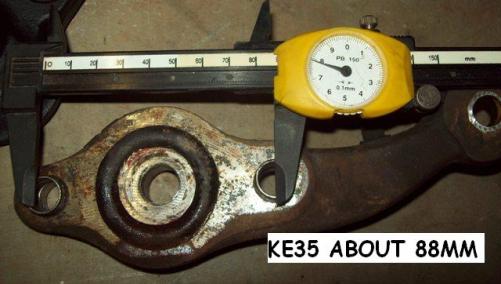

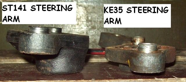

So lets have a look at the steering arms between the two as the pictures can say a lot more then I can type.
Look at the height difference and the angle that it sits the strut on .

I love the workmanship, the only drama you'll have is the struts have the wrong kinpin angle for a KE. ST141 and RA60 struts are the worst struts you can fit to a KE. Bad if you like corners, they change the scrub radius of the tyre and most people end up putting XT130 corona or AE86 struts once they realise they've ruined the front end geometry. I bet this car has epic positive camber at the moment. Sorry for being a bringer of bad news, but if you're putting a powerful engine in the car I assume you'll want to get the handling right.
This and a few other comments are totally untrue, ST141 Mx63 RA60 all fit very easily, geometry stays as per std and has the benifit of bigger bearings, instant brake upgrade and heavier strut and shock, contact me or FNQrolla for fitting info

If you bolt the ST141 steering arms onto your KE55 this combo will add a positive camber of about +4 (not what you are after)
