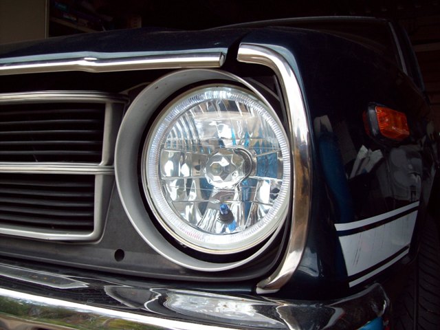

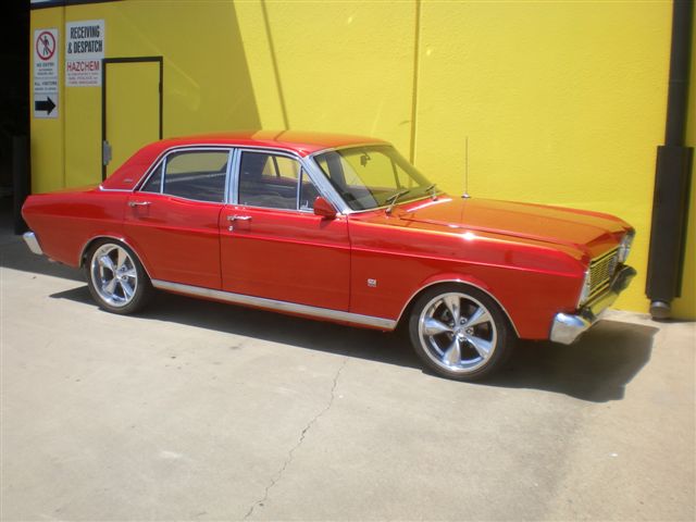

On the weekend a mate gave me a set of crystal headlights which he bought for his XT Falcon, but he did not like the look of them (saying they spoilt the look of the Falcon) and said there yours if you want.
Here is a picture of his Falcon.
Well needless to say the old bomb now has a new set of headlights (now I can see at night).
Here is a picture of my new headlights. :)

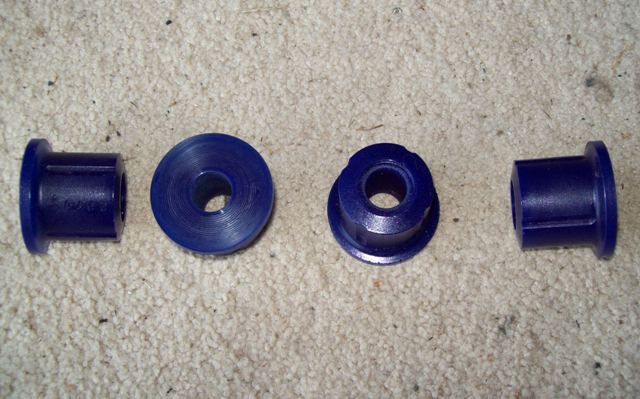

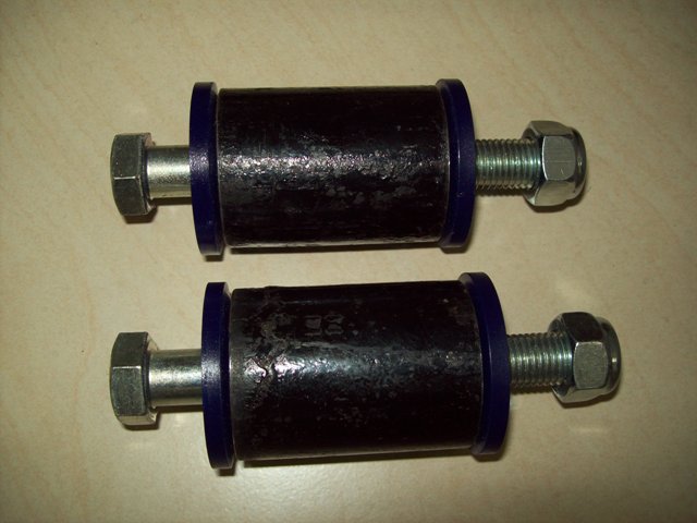

Started working on my engine mounts on the weekend. I started with a length of 40mm ID seamless pipe with 3mm wall thickness. I also found that a Landcruiser rear leaf spring bush fitted the pipe nicely. I then cut the pipe to a length of 75mm on the lathe and a little of the bush so it would all fit together nicely. Will bolt it all together with a couple of high tensile 10.9 grade bolts.
Landcruiser rear bush
Start of the engine mounts
Wow! there is some next level shizz going down up in FNQ. Great work on the engine mounts, once again your work is flawless.
I think the wheels spoil the falcon but hey, Still a nice car.
