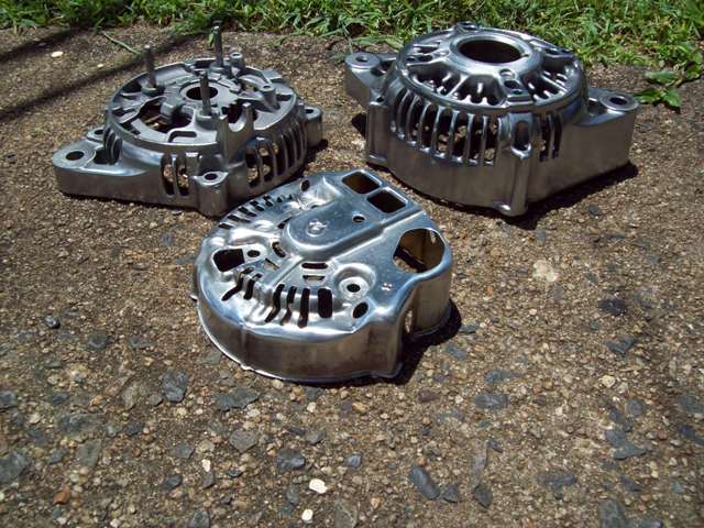

Did a little work on the alternator over the last week. Totally stripped, cleaned, polished sprayed with a clear with a gold pearl and refitted with new bearings.

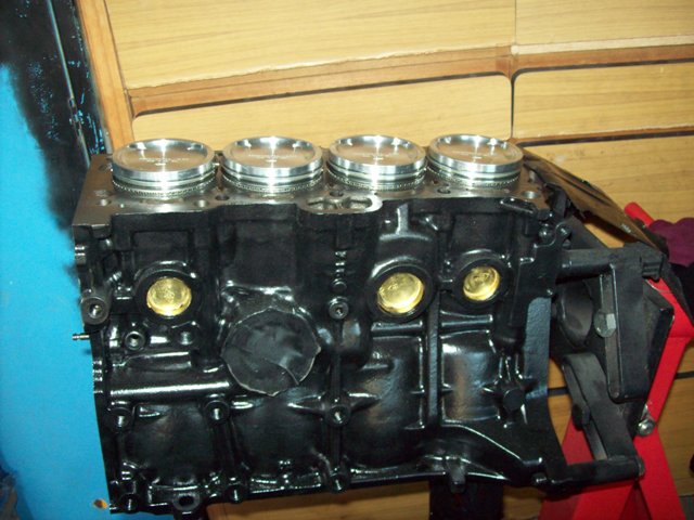

Also last week I sprayed the block in a gloss black and fitted new welsh plugs.

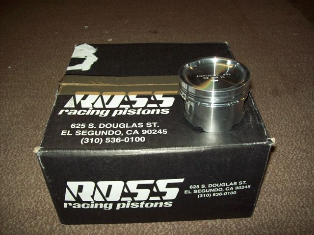

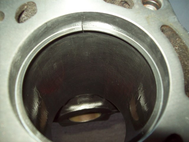

Piston for boost

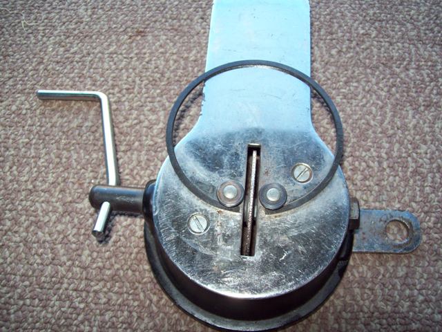

Setting the rings gaps to suit boost.

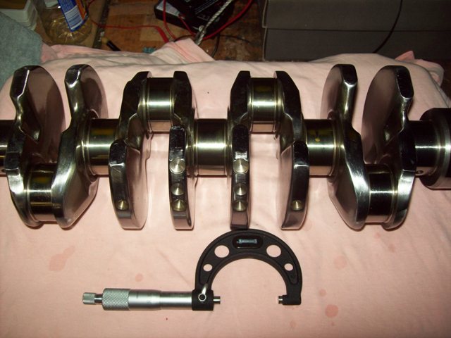

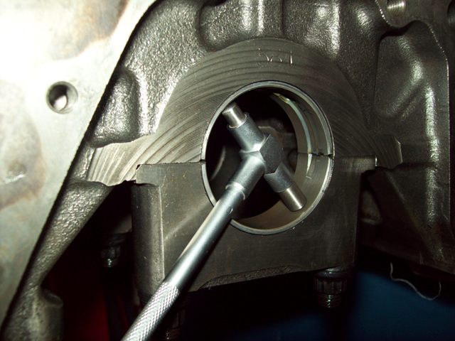

It’s been a little bit busy up here with the cyclones and floods and doing a bathroom renovation but on the weekend I got a chance to measure the clearances I asked the machine shop to machine the block to.
Note I will use a plastigauge to check on the final clearances on assembly.

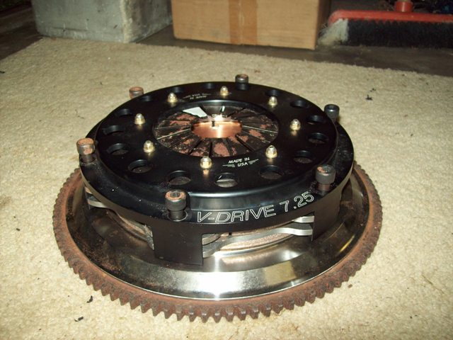

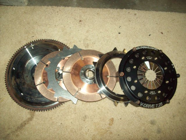

We have had that much wet weather up here and the humidity has been through the roof I have a light coating of surface rust over my new clutch fingers and a little on my light weight custom billet flywheel (I have only had it for 2 months).
Looks like I will have to get a move on and put it all together soon :devil:

Nice looking twin plate,
Had one on a road/race car years ago, great clutch but rattled like hell and drove me nuts.

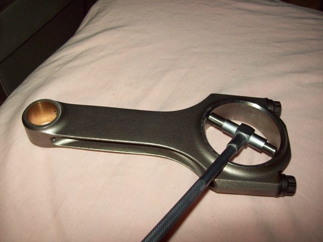

are those spool rods?
better start stocking up on K gearbox's with that clutch :hmm:
Spool rods! WTF (Wash your mouth out with soap! lol)
No not spool these little numbers are a custom job and only weigh in at 430grams and are rated to 600hp+.

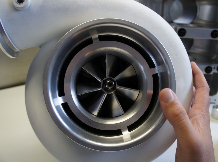

One of these things
NOT THAT BIG
One of these things
NOT THAT BIG
HOLY f@$k! WHAT IS THAT MONSTER!?
:o WTF?!?!?! You can't be serious :o
I was joking, that is some random huge ass turbo that I found on the net :lol: . That size turbo would not fit in my little engine bay.
But the plan is for a turbo.
