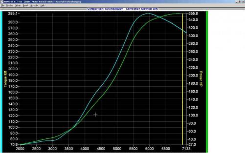

    Hi there, The motor only has done 350kms and I have already done an oil change so it was off to the rollers for a tune (I really did not like driving it with the base tune).   We only took the boos

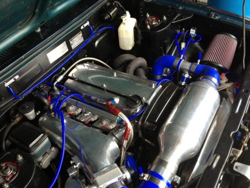

nice work mate, thought this was 4ag but now the custom rods make sense.
i don't know why more people don't go with the extra capacity. Oh yeh, and you work fast! i need to check this thread more often.

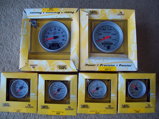

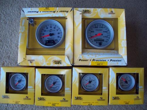

Last Thursday week my Gauges arrived from USA; Speedo (electric/metric), Tacho, Boost pressure, Oil pressure, Water temperature and a fuel gauge.

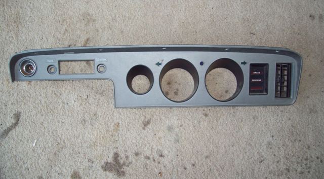

Will start installing the gauges in my spare dash/instrument panel next week if I can find the time.
New Autometer Gauges
Spare dash/instrument panel

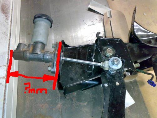

What hydraulic clutch have you used in your KEXX, as I think I will need something shorter then 100mm that will bolt up to the studs that stick through the firewall.

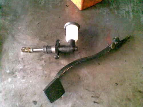

Something like below
Picture taken from “oh-what-a-nissan-feeling”
Picture taken from “78_7kRolla”
ae71 mc my friend.. i heaqr ta22 also fits. i know ae71 fits and works running it in my ke30

Do you know if the measurement is less then 100mm from the firewall to the end ….. like the picture below

In my measuring up I think I will only have 100mm (max) to spare

Have just read that the following also fits but does anyone know the measurements of these?
