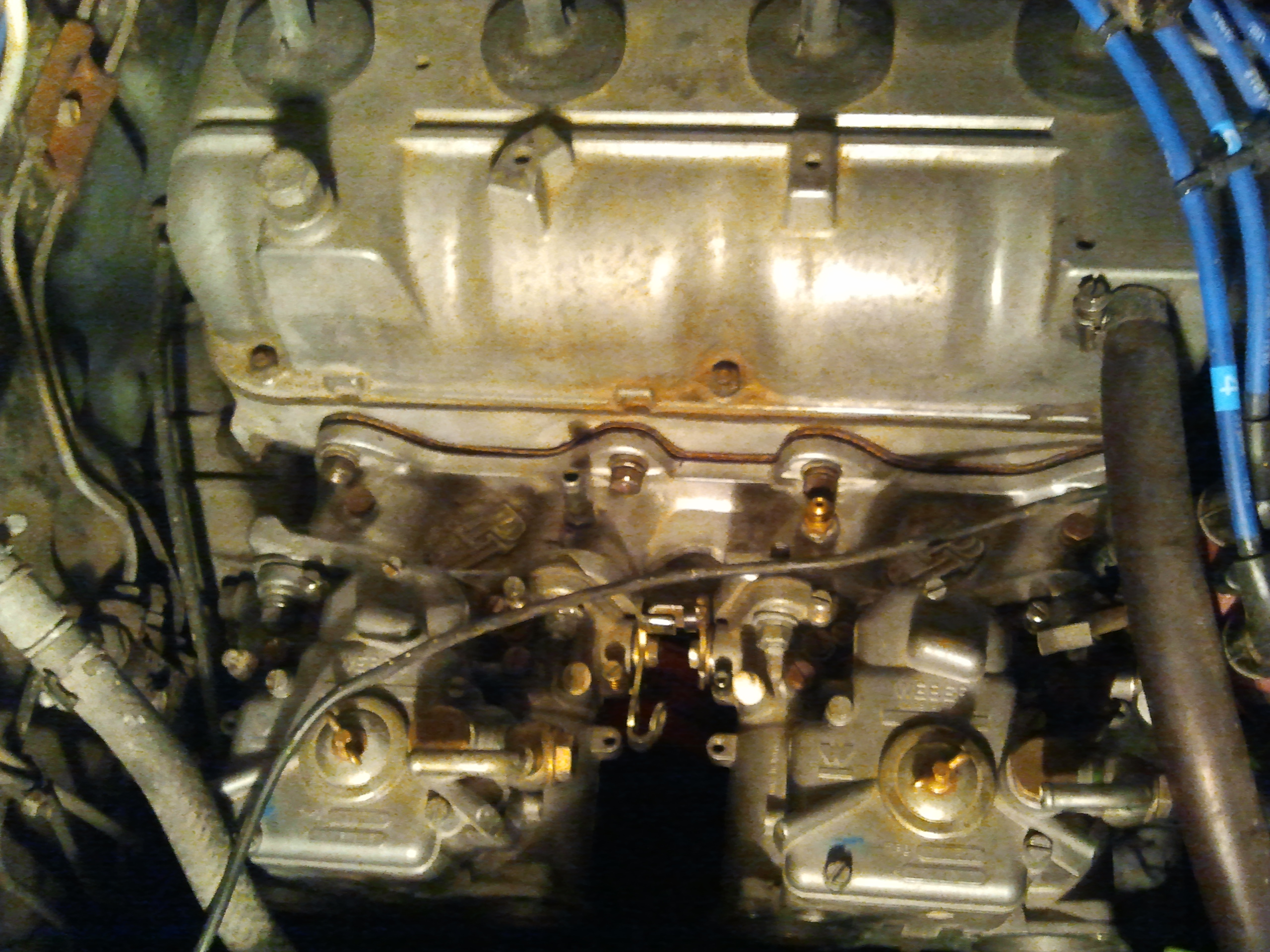

  4. problems: the carbs are set up to pull down on the linkage, is there a way to flip these or some how a reverse cable set up? inbetween the carbs i would push that linkage down towards the ground, it seems backwards, shouldn't it pull up? this is the current set up complete with zip tie

  6. yep, not there, this one has been modified. I'm just trying to think on how to hook it up, the cable will have to pull from the bottom. I'll post more pics tomoroww. :hmm:
  7. i found a dual side draft set up used for cheap, tips on the linkage would help with pics.
