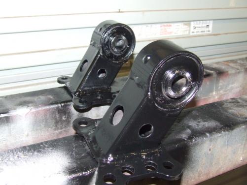

  5. Custom race engine mounts with Landcruiser suspension bushes. 50% lighter than standard and 100% tear apart proof.

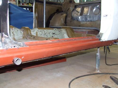

  7. Both sills are on and welded. Ill finish off the plates for the stand mounts when it gets flipped over for final touches and paint.

  9. New sill in place with stand mounts.
  10. Left sill on the mend.

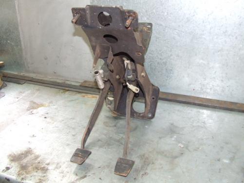

  17. Made a mount plate for the Tilton pedal box. The holes in the plate take some weight out and allow it to be welded to the body rail under the floor to reduce flex under hard pedal presure.
  18. Next job is engine mounts, This can be a pain to get right as nothing looks as bad as an motor thats not in straight.

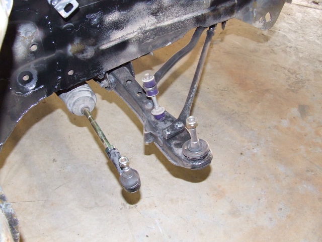

  19. Steering rack is in.

  24. Thanks Mick, I really am enjoying this build more than others over the past years. Not being held back by too many rules and regs helps I think. Front suspension is a combo of Corolla and Celica.
