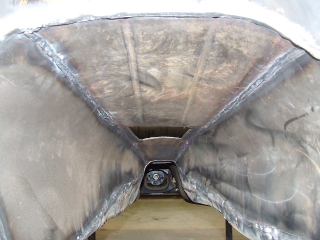

  7. Thanks Daniel. Hi Lucas. The main reason I went for the Magnum over a standard t56 was the option of 3 different gear lever positions. It has a great close ratio gear set and super fast gear changes. Trany tunnel is done.
  8. More progress on the new trans tunnel.

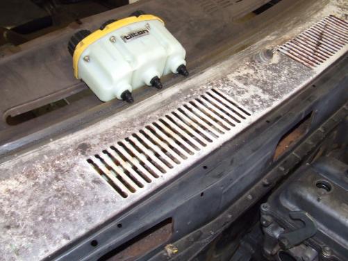

  9. Ive seen remote boosters in older cars without mechanical linkage. If its for a rally car, it still is a fair weight to carry. The main reason for mounting the reservoir there, it allows the feed hoses to the pedal box to drop straight down. Mounting it lower in the engine bay creates clearance issues with the exhaust manifold, roll cage, throttle cable and steering coloum and the 3 hoses have to go through two 90 degree bends in the fire wall. There is a small weight issue but it seemed to be the lesser of two evils. Toyota had there reservoirs mounted in the same place in the group b car.
  10. Found a spot for the Tilton res. Keeps the fluid away from the exhaust and allows easy fitting of brake hoses to the pedal box.
  11. We will see you there. Bit more on the new trans tunnel.

  16. Engine mounts are tacked in position and started on a new trans tunnel for the gear box.
