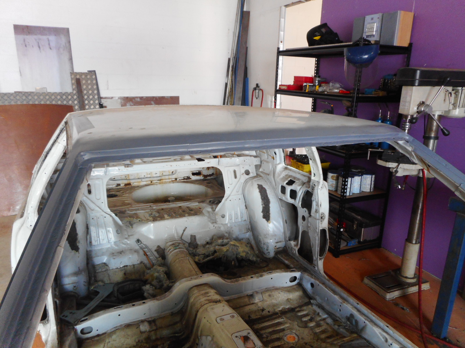

  3. Thanks, Its really taken some time to get back to work. Got to remove some unwanted brackets today, just a bit of soft porn for Chris Scott when he has a look.

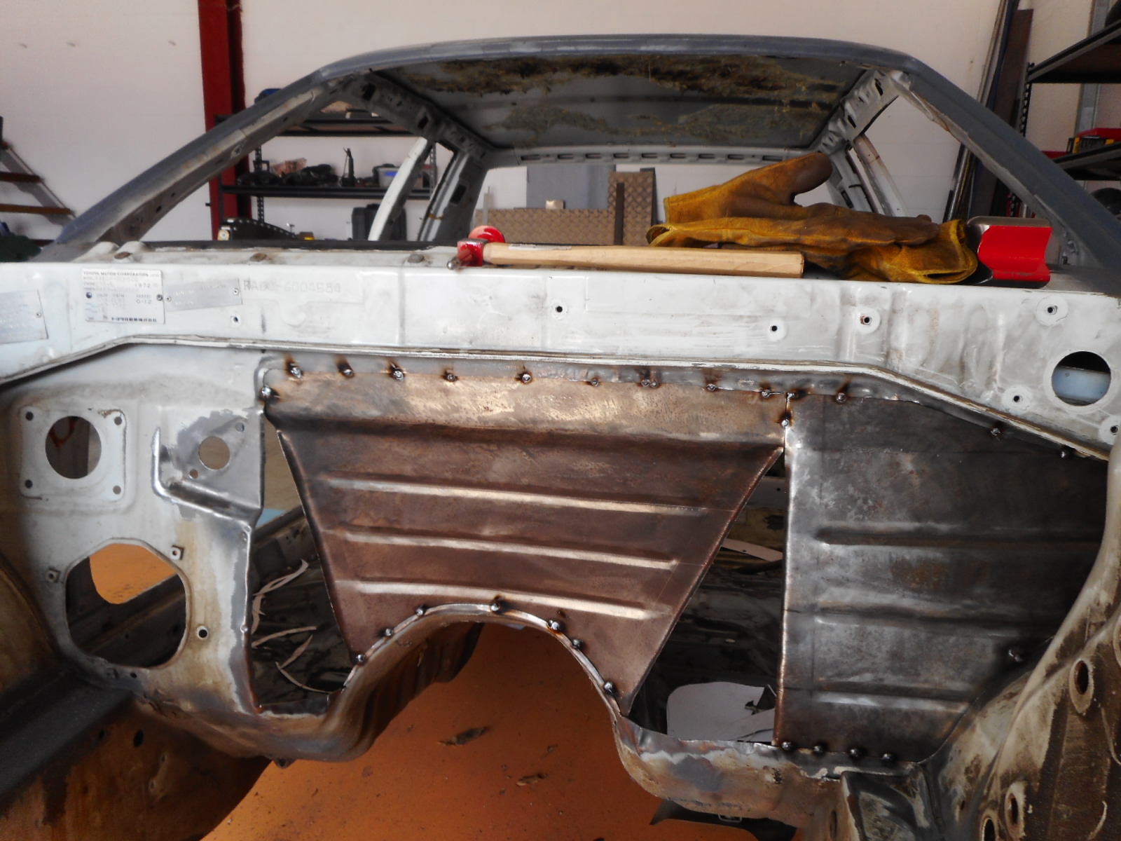

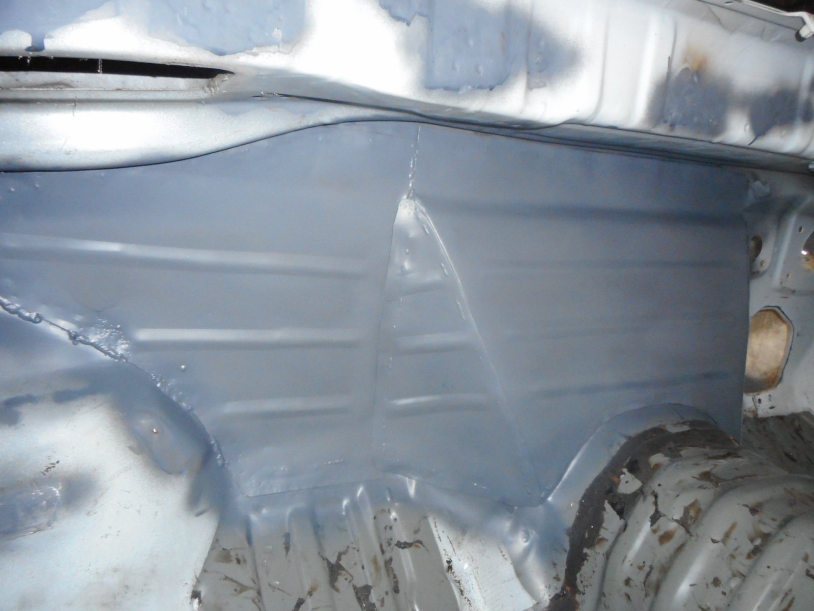

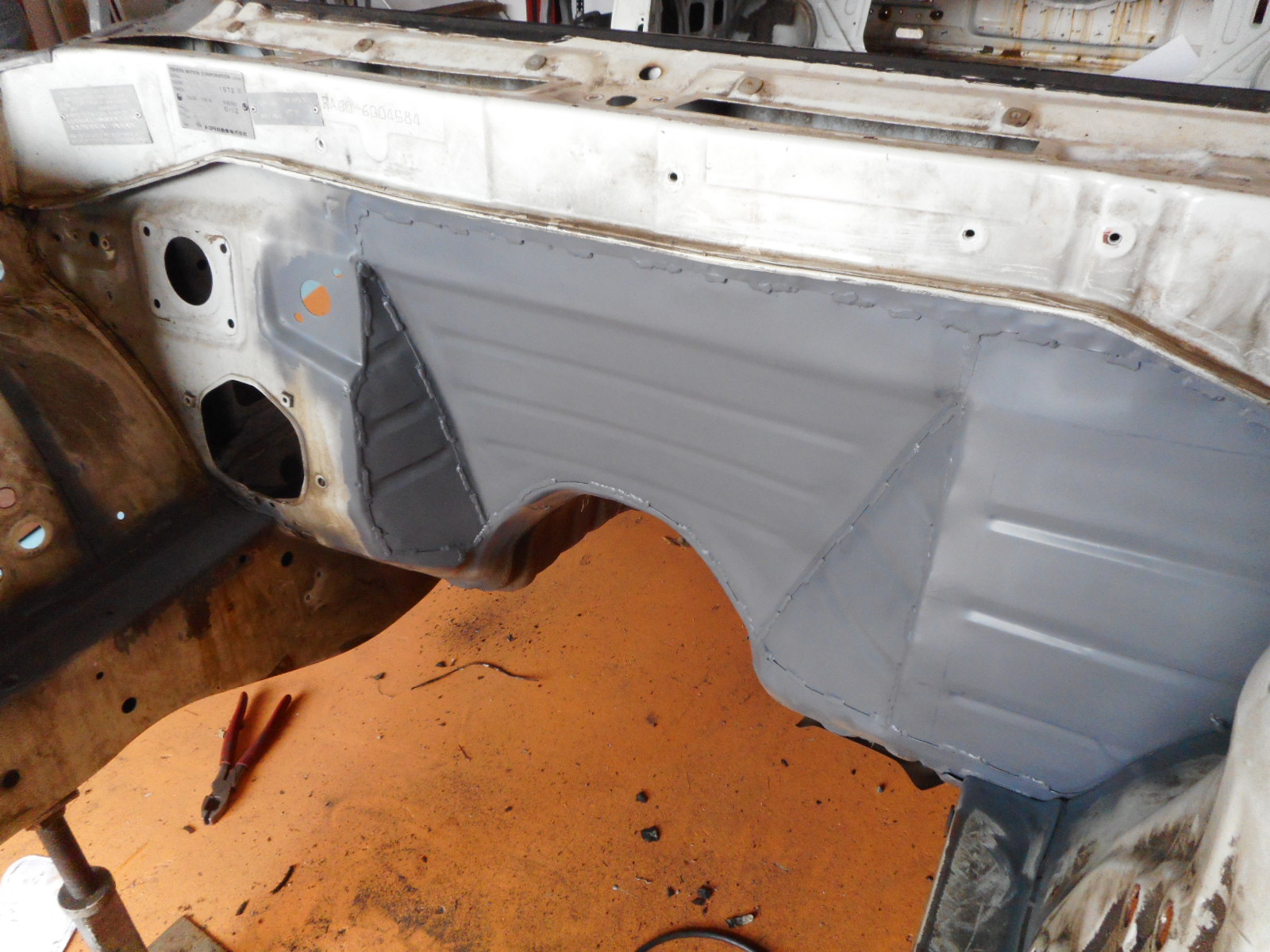

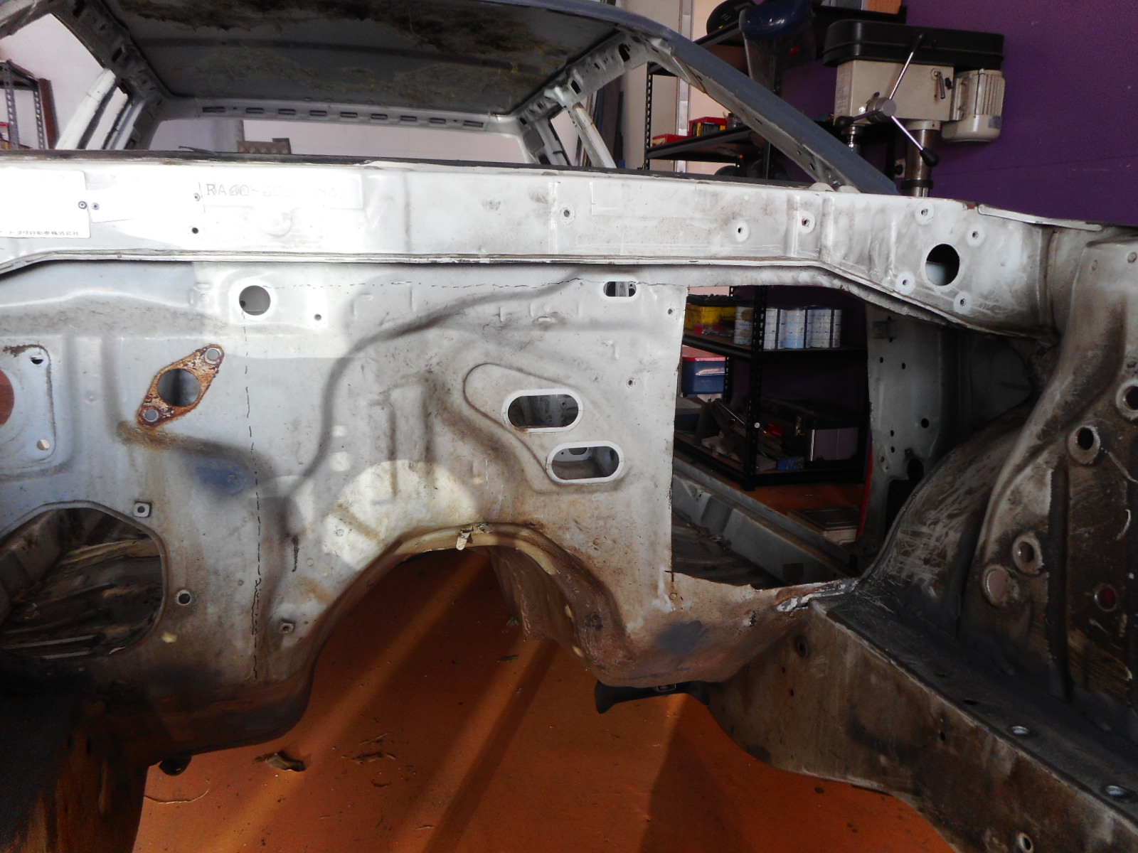

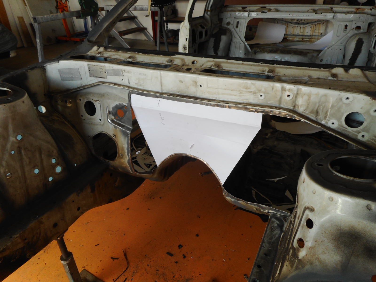

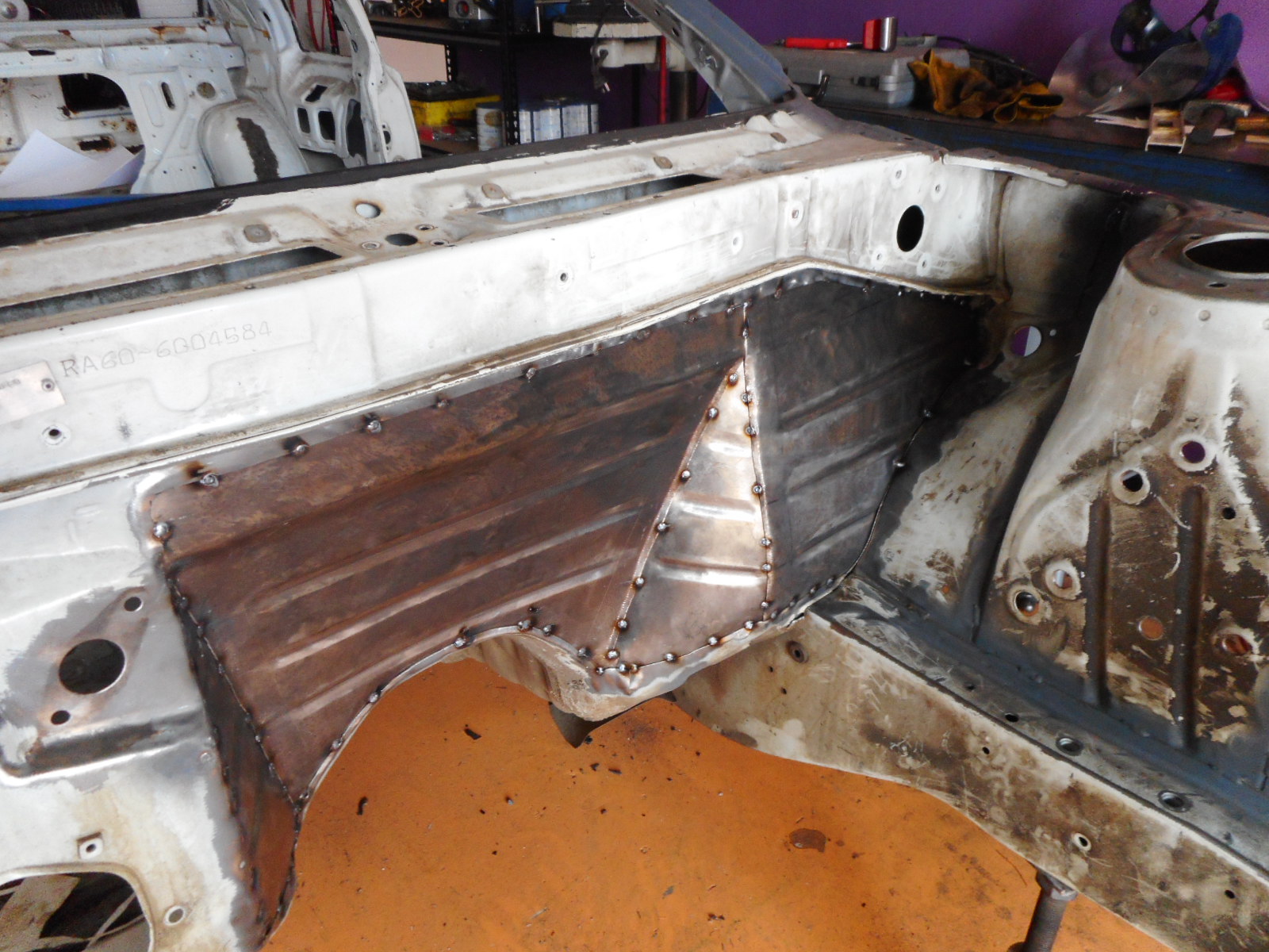

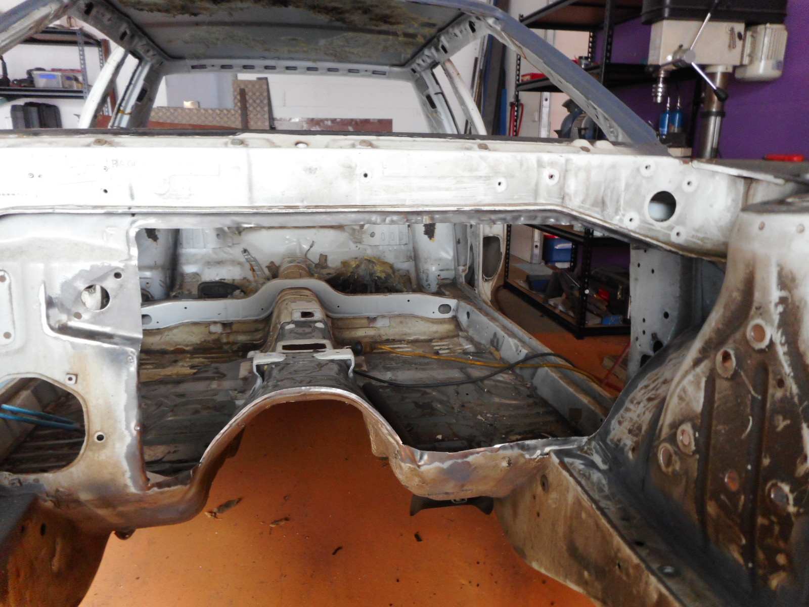

  4. Its been a while again, with moving and other stuff. Got the Group B fire wall done today.

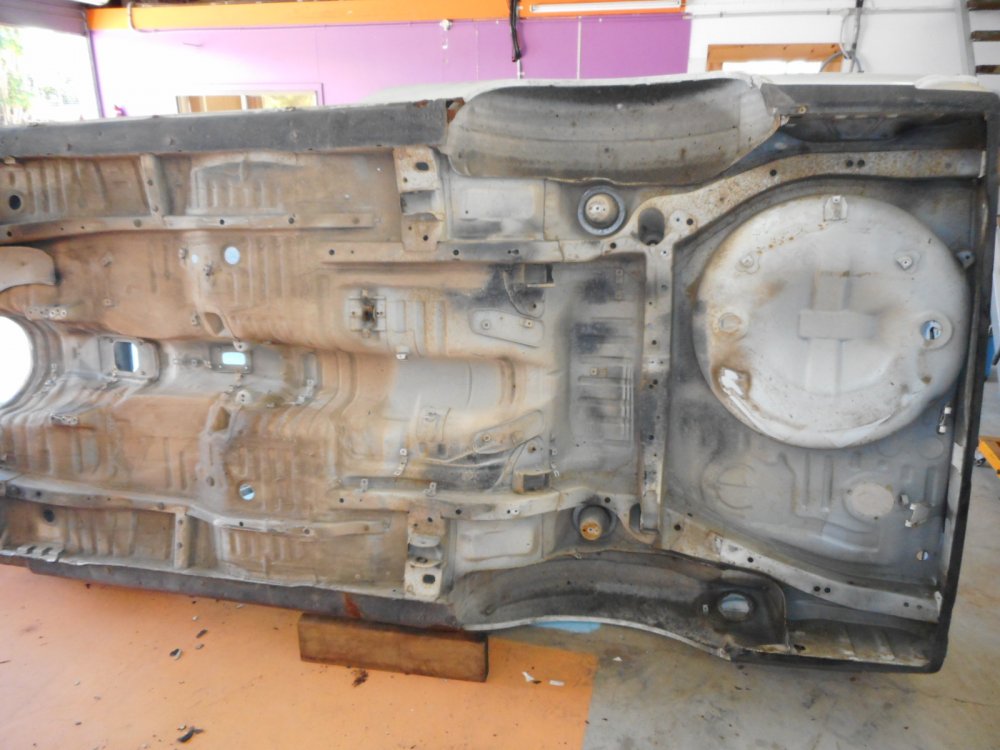

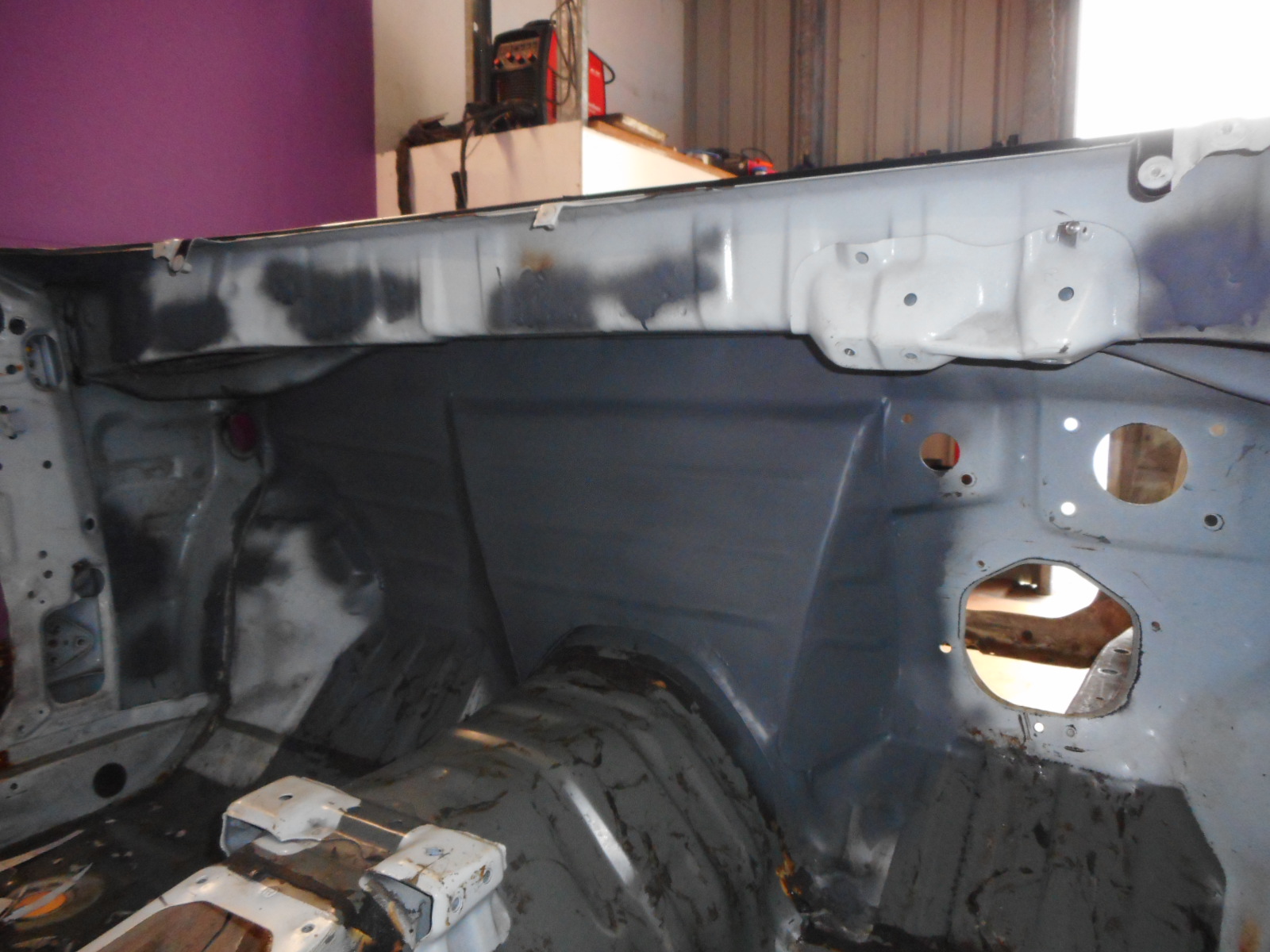

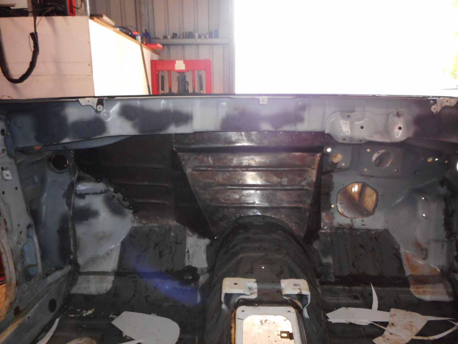

  5. Hey Rob. Ive never had any trouble with the floor after removing the x member. Its really only there to bolt the standard seats to. No real need to compensate I think, although this car will have a flat floor with a chassis rail as per the group b car. Removing all the captivated nuts to reduce weight. The holes will be covered with foil tape before paint.

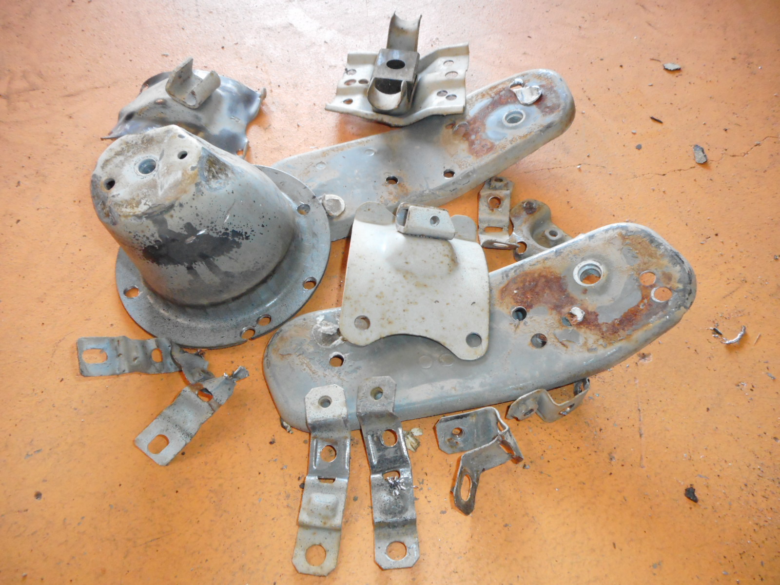

  6. Its been a while. Now the GT4 Celica 165 is all but ready for this years QRC and a bunch of other projects are coming to an end, I find myself revisiting this project. Chris Scott has been here for a day already cutting stuff out.

  11. Thanks, I can't wait to get started chopping this thing, work is just crazy busy at the moment.
  12. We rallied a 22re for a few years and did a lot of performance work on the engine with land cruiser pistons to up the bore and comp. A big cam and microtech ecu as well as the usual head and manifold work. Its a very strong motor and we had no problems, but the long stroke limited it to 6500rpm usable power. It only made 120bhp @ the wheels but had massive torque. Ive seen the 4lt quad cam v8 fit these Celicas very nicely. The Torsen LSD from a GT4 rear diff will fit your 65 centre.

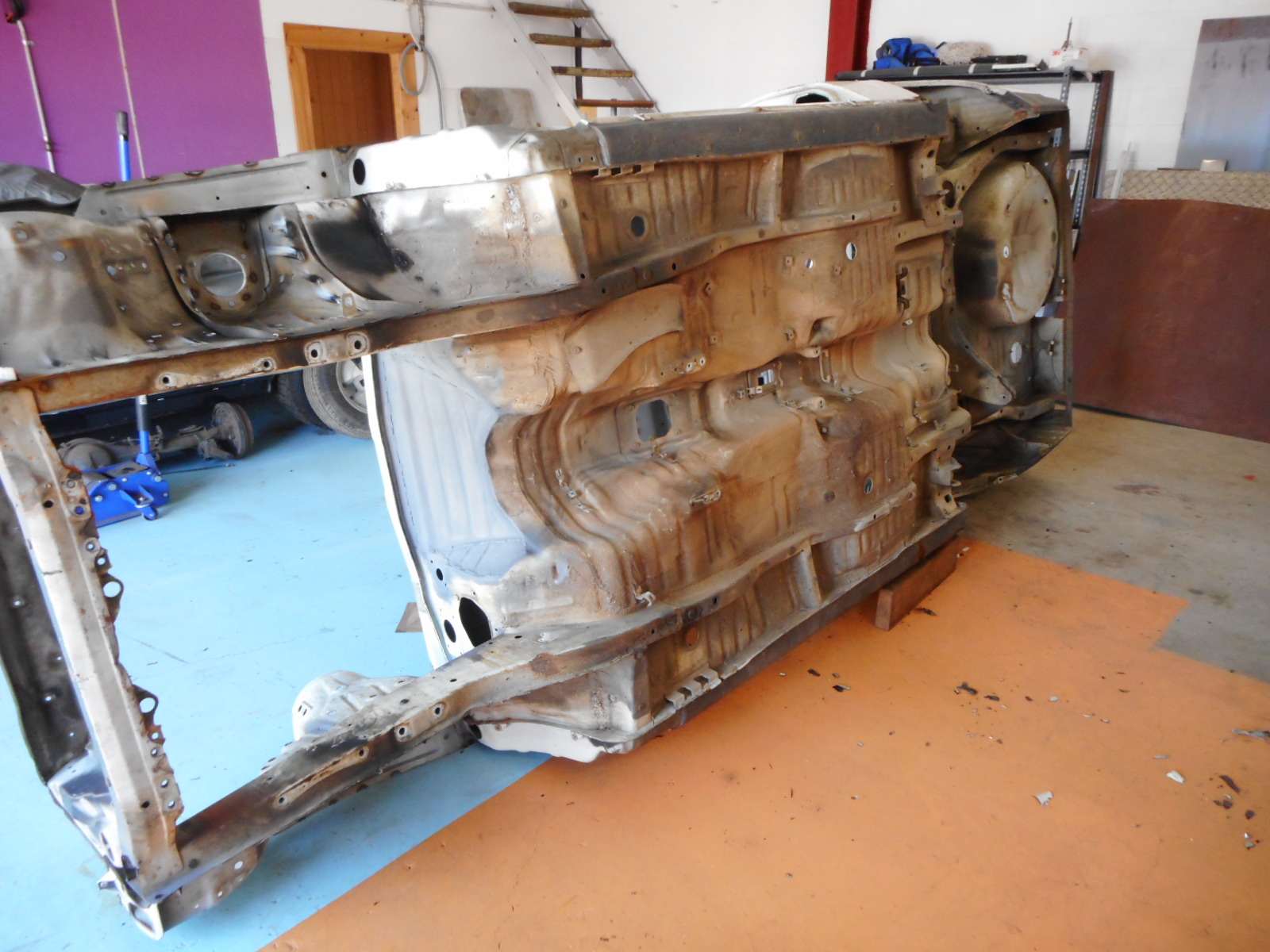

  13. Finally back on the group b project. Body is all but striped and ready for some repairs and mods.
