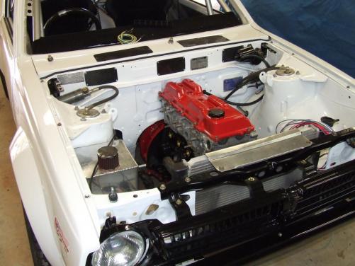

  14. They did an awesome job on the head Keith. Fellow call Brad at Express Engineering here in Toowoomba. Could'nt afford to get the performance seat cut Chris, had to settle for the standard 3 angle for now. I have got the reversion edges on the manifolds though. If the head has to come apart again at any time, Ill get it done then. There is a few tricks in this motor, so we,ll see how to goes. Which is your hero car littleredspirit? The TA64 or Tony's KE70 Head on and cams all dialed in.
  15. Head is back from the machine shop.
  16. Wow, I don't think they looked that good when it was new. Looks great and final assembly is always the best part.

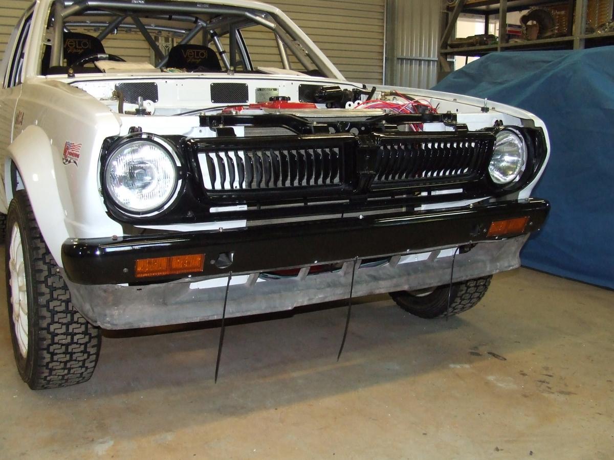

  18. Front and rear bumpers fitted.
  19. Cheers Simon. The first event will be a shake down at a place called Hirstglen about 40min from Toowoomba. Then the first proper rally maybe Boarder Ranges if all goes well. Holes in fan blades, now theres a thought. ;) Got a coat of black on the bumpers.
  20. Fitted the thermo fan. can't remember where I got it or what its off. Years ago we used those crappy multi blade fans from Repsons and every time we had a hard landing the blades would break off. Just not enough space in there for standard Commodore fan.
  21. Front Bumper mount painted and fitted.
  22. Hey Stuart, thanks again. Hoping to have it done in a month or so. You know how these things go. Even when its finished, then comes the paper work and dyno tuning and then a few small events to iron out the bugs and get the car and myself up to speed again. Plan is a full 2015 2wd rally master series. There are 2 events near the Vic boarder.Johns River and Mini Dula I think but they change from year to year. The first Rallymaster event we did was in Victoria near Daysbrough called the Seemore Stages. They might include it again. The forestry roads there were the best Ive ever driven. Boot and rear bumper in primer.
  23. Thanks Bret. Made the rear bumper mounts and test fitted the rear bumper.
