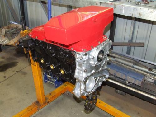

  8. Bottom half of the engine fitted. Still waiting for the head from the machine shop.

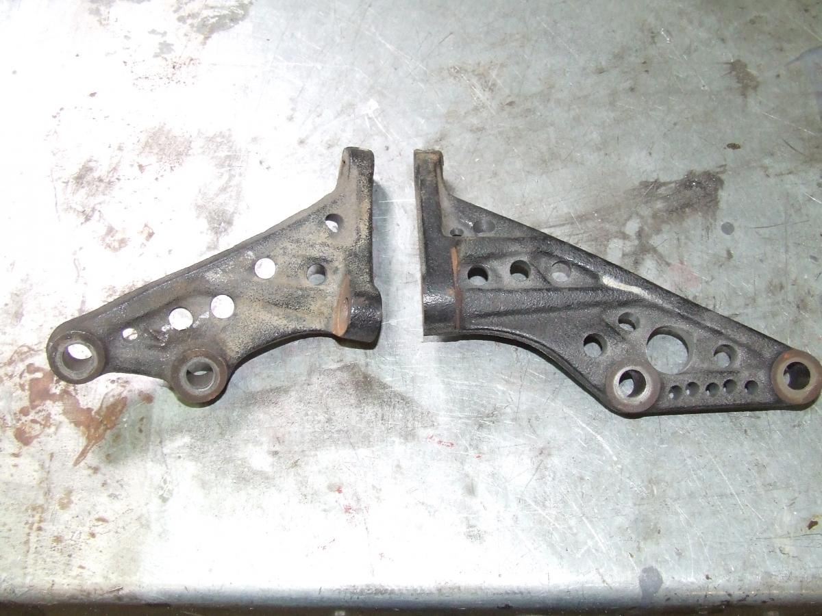

  9. Lightening the gearbox braces.

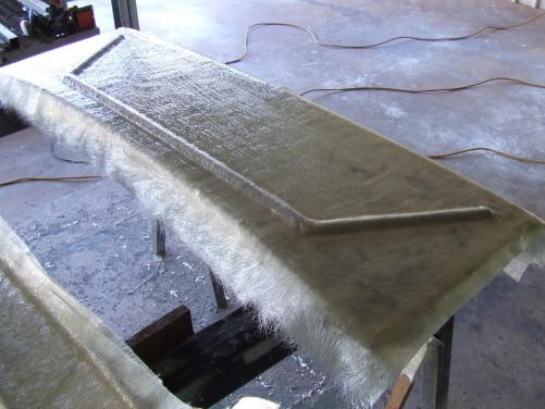

  10. Hi Mika. I havent had any problems yet with them coming loose. It really is a pain when they do as I found out with my first bonnet I made about 5 years ago. I rough up both surfaces and use windscreen sealer, Its almost impossible to pull apart when dry, but I put in a pop rivet as well to be sure. Boot skins glued together. Weights in at 3.5kgs. The steel boot is 7kgs.

  16. Boot skins in the molds.

  19. Molds ready to lay up inner and outer boot skins.
