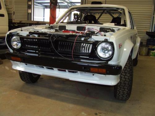

looks like it might be a battle of the Rolla Rally Cars next year. Took a few photos with the bonnet and mud flaps fitted.

Not much happening at the moment Stephen. The head is waiting for some more machine work and then the cams have to be re shimmed. The car is all but finished. Just the sump guard mounts to make after its dynoed and a foot brace for the nav. Hirstglen has been canceled this weekend due to the weather so Iam not missing anything. Before we stopped the last dyno, we pulled a few bedding in runs with a very basic tune and soft timing to 5000rpm and it was showing 125bhp with a very straight torque curve. It looks good to make close to 200bhp. Its going to be a slow few weeks waiting on other people, but Ill take some photos of something on the weekend. Hows the new 70 coming along?
I will have to make a custom air intake/filter system in the future, but for now the socks will have to do. The dyno tuner will tune it with the socks and then do a run with them off to see just how restrictive they are. Some people have said they will stop more dust than a K@N which I believe as my old engines always seemed to have a fine dust in the intake with the K@N filter. The flat panel filter is the best for performance if its paper or oiled foam.
Thanks Stuart. It went to the dyno on Friday,"had the video cam ready" but the first development bug has shown its head already. After some mid range tuning, we dropped the running in oil before the full power runs and noticed a little to much metal in the oil. Pulled off the tappet cover and found that the cams are so big they are just wiping the edges of the buckets and slowly grinding away. Got the head back off for some more CNC work to bore out the bucket slides for over size buckets. The joy of race motors. "How to make a small fortune in motorsport?" "Start with a big fortune"

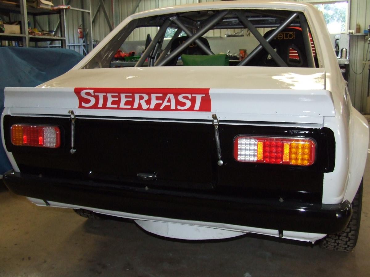

Thanks Snot, and your welcome. ;) Wont be at the WRC this year Rob. Plan is 2 small shake down events at our Hirstglen track in August and September. Then 2 proper rallies October and November here in QLD. Need to iron out any bugs before investing the dollars to go south for the Rally Master next year. No mater how well we build these cars, there is always some problem to sort out that only shows its head during an event. Rear window is in.
