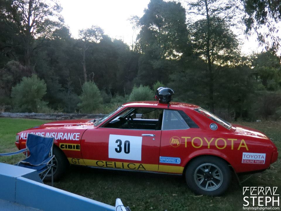

hi all thought i might do a build thread on me and my dads 1977 ra23 rally car.
the specs:
  • 18rg 2 liter twin cam running hi comp pistons with bathurst cams out of the 1981 chickadee ra40 , and twin 45mm webers
  • w50 gearbox
  • 4.88 liteace diff which is locked
  • brakes are hilux calipers with 4 pot Hilux calipers, stock drums on the back
we brought it at the start of 2013 as a tarmac racing car so nice and low and couldnt get it on the trailer, we set to work on turning it into a rally car :) post-17093-0-18790200-1362462538_thumb.jpg
We set about fixing the interior first like moving gauges and making them nice and neat not just cable tied to things :/ we also fixed the dash pad up as it was all cracked.
The next step was fixing the little things we needed on the rally like heater , demister and radiator fan
Then we set up spare wheel carrier , co-driver seat, co-driver panel ,interior lights ,reversing light and terratrip.post-17093-0-30464100-1362463295_thumb.jpg
then the most important thing for any rally car stickers :)
i made them up myself .
Then we ordered some stiffer springs to give her more ground clearance , and stole a stiffer front sway bar out of our parts ra40
it was time to take her out on the first outing post-17093-0-55357700-1362463418_thumb.jpg thanks to my mate craig for the photo , it was only an autocross but it was a good chance for dad to get a feel for the car before we took it out on our first ever rally :)
on the rally it was good fun we damaged the car a little but nothing to bad and placed 9th outright post-17093-0-41095200-1362463614_thumb.jpg
