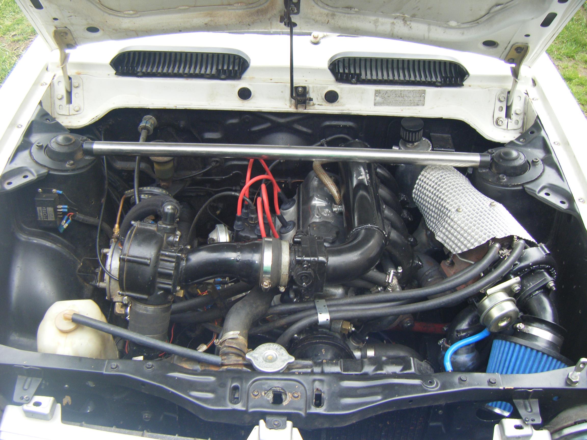

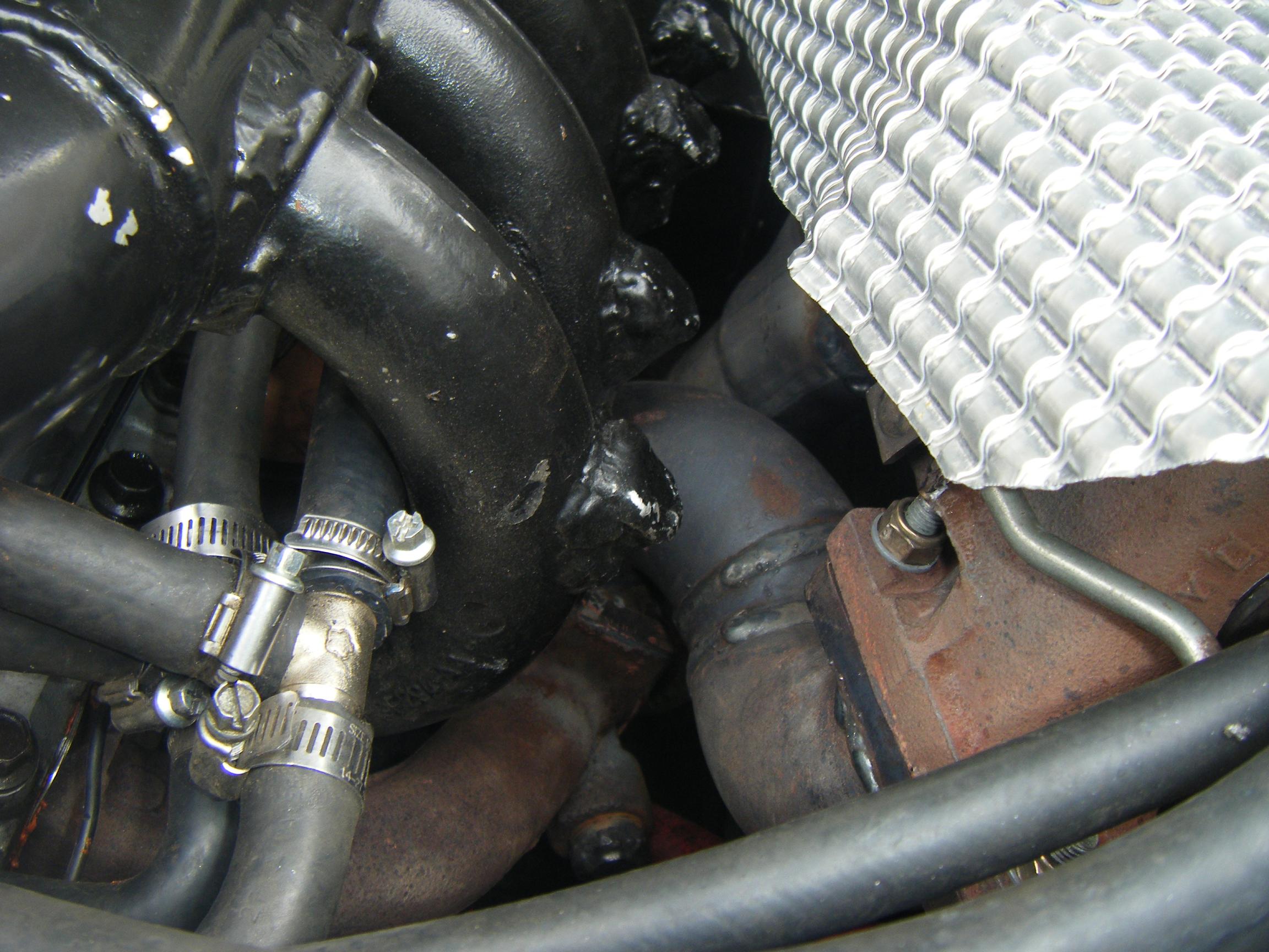

  10. Nah no pics of exhaust mani out of the car but it is a std ke70 manifold with the "j" coming from the hot box section, yeah its a t28 and i want a t25 because the lag is getting annoying, the oil feed is on top i just spun the core around. its been ALOT of work but i was worth it, i've had it upto 16psi at 7500 rpm and it flew. i was originally going to leave it EFI but fuel prices suck and i love gas because its so easy and runs very well with boost all you need to do is run the balance line from the converter to the mixer and as soon as boost hits it opens up the converter and pumps more gas in.
  11. ahh thats how its done cheers TAZ
  12. The time has finally come, my lil rolla now has a snail hangin off the side and is running straight gas (because I'm a tight arse) and goes pretty damn well but not without its fair share of problems. i have pics if someone is willing to host them cheers.
  13. well spotted TAZ, that was originally an sr20det mani and the ports matched pretty much perfectly, i know this because it used to be a mates, a top mount would be much better because the starter gets very close to the ex housing from memory
