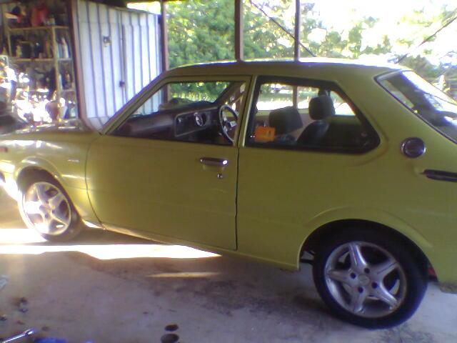

hey well these are the rims that were on the laser i used to fang around in. They are 15 x 6, but have the offset of a wrong wheel drive. The rims sit nicely on the back (could sit 10mm out from the body), but hit the strut on the front (surprise surprise). At the mo' i've got the 15s on the back, with 13" hotwires on the front. I know you can get spacers so you can fit these rims, but i know it chews up some of the thread on your studs ( = weaker ). I was thinking of putting in longer studs to suit, but I think Mr. Policey has spacers in his little black book under the ILLEGAL section. Should i abandon all hope of my beast cruisin round with these rims? Check the foto out so you can see why i like. Cheers, Dyzza
