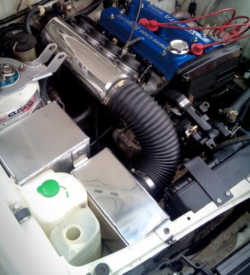

    Finally got the catch can and air filter box in, Dad has done a spot on job welding them up, the same can't be said about my brackets :lolcry:, after the weekend they'll come back out and get a clean up more, but I'm stoked with how they look, fitting nice and snug around the overflow and washer bottles. I can't wait for Sunday, will hopefully have a video up of the motorkhana next week.

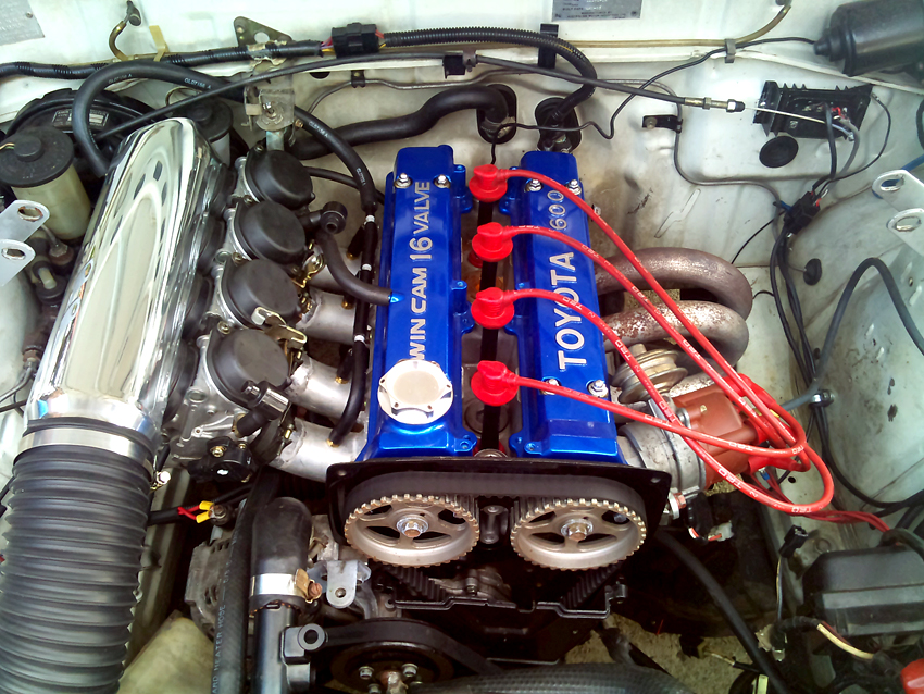

    Getting hooked up with some 15x7.5 long champs. Not sure if I prefer the rewinds or the XR4s. Also a picture of the engine in its current state, I'll post up a daylight video of it running, really happy with how it's going so far, once we've finished the air filter box and the rest of the intake, we can fit some bigger jets, get it tuned and it should be running miiiiiint. :dance:
