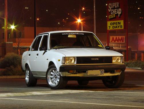

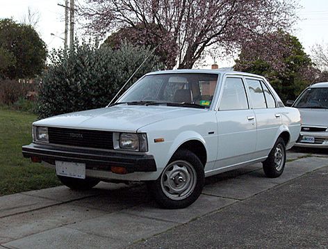

Before: Stock KE70 SE, clean as hell.

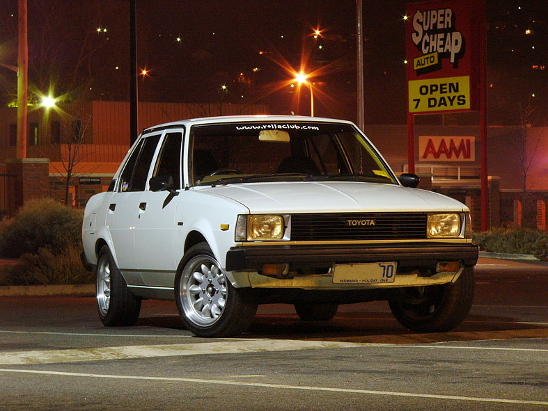

Now
Not much has been "completed" on it since, but heres a few things that have happened... gone over 100,000km on the clock, a few dents in the panels thanks to carparks and a blown headgasket.

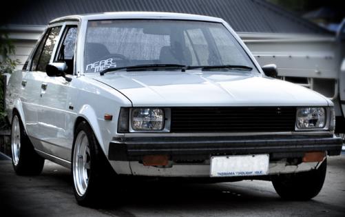

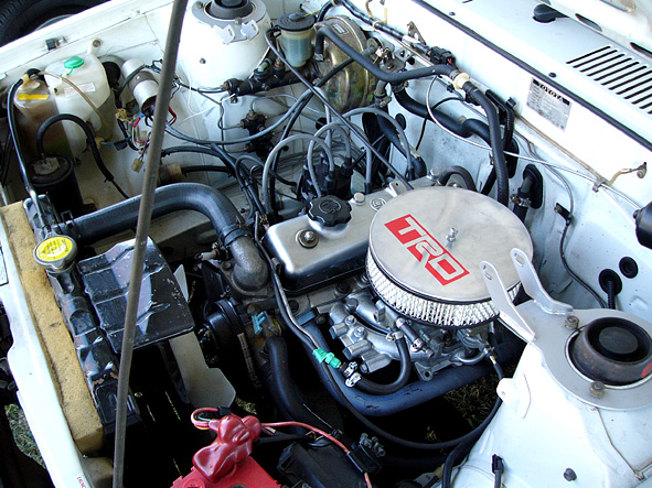

Recent photo of it.. needs lowering.

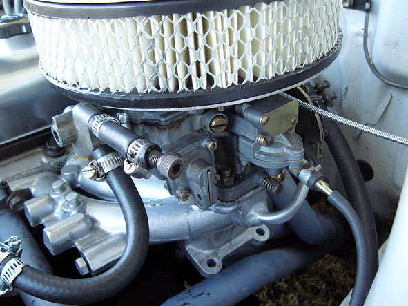

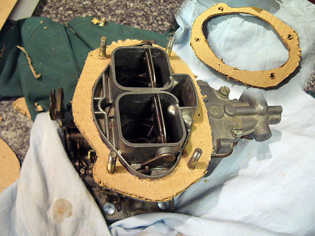

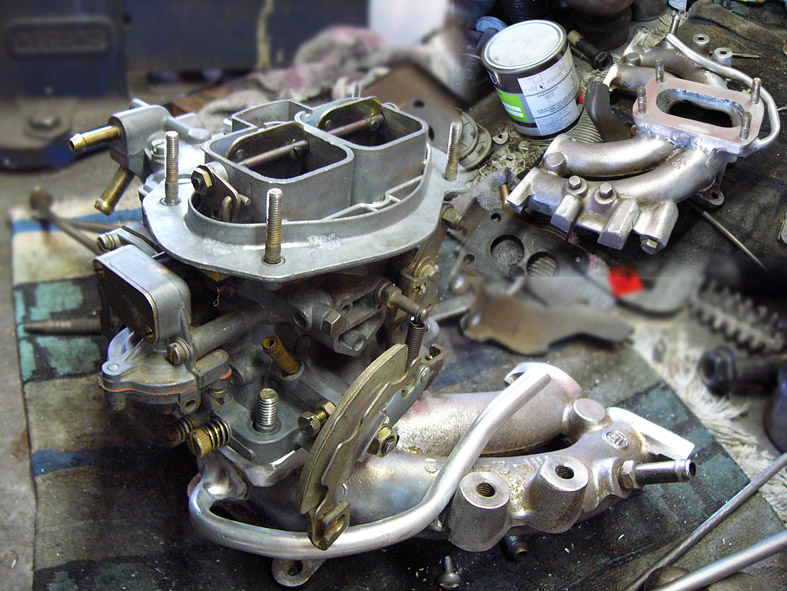

Photo of the Weber and the manifold that was done by my old man, using a 3K inlet manifold I had sitting around he modified it so the Weber would bolt on. Still got a few things to do with it though.

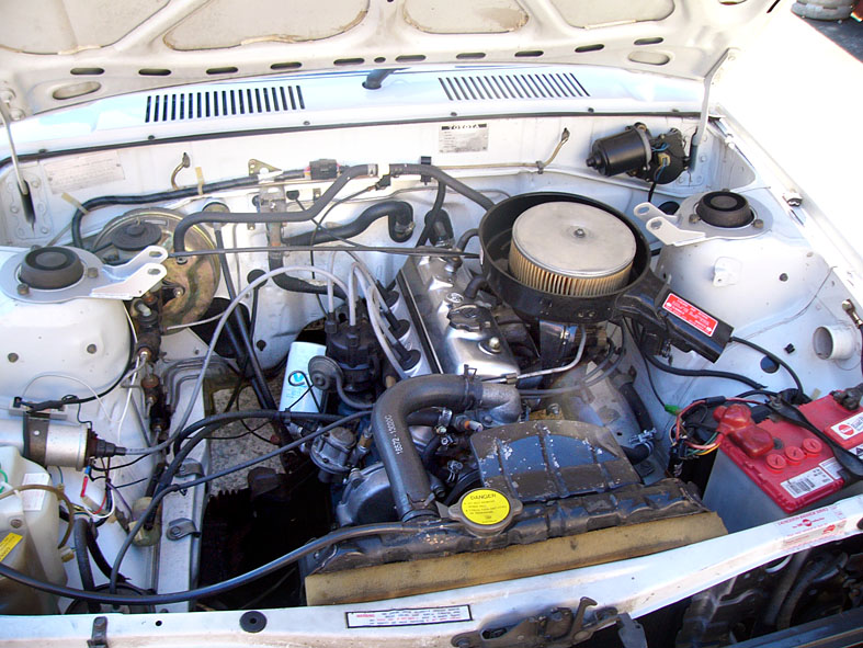

Random engine bay shot.

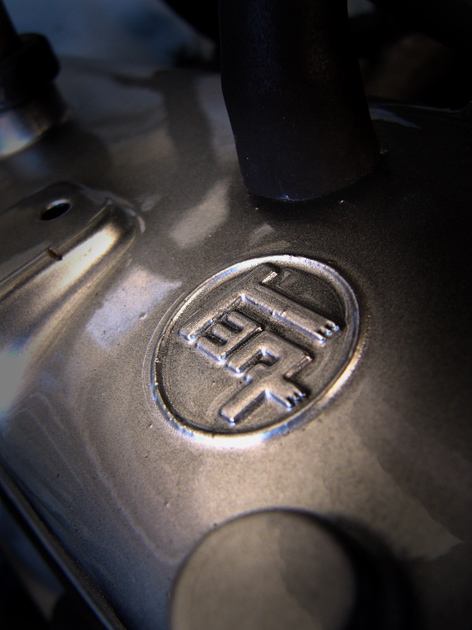

The night before I was to put the head back on the car after getting new gaskets, etc. My Dad decided to give the rocker cover a new clean look, giving it a rush job in shadow chrome, I reckon it looks great. :P
Picture of the template I made up tonight to help make the airfilter assembly.

Looking real good. Like the rockercover.

what type of webber is that?? an how much do they sell for second hand??

the carby is a 32/36 weber down draught which u can get from ford 2l pinto motors or they go for around $80 on ebay plus an adaptor plate to suit a 4k.

Yeah, what James said is right, except I nabbed mine off a Fiat.

Weber is on!
The old man and I finished bolting it up just before I got to work tonight, had to change the choke cable as it was too small and modify the bracket for the throttle cable but its all together!
The Weber itself is in good condition and works great!
