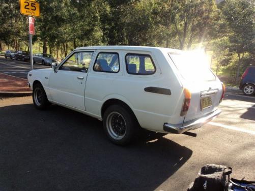

This is my new baby. He's a 1975 ke36 got around 380,000ks on the clock and isn't coming along too bad. Has a 4k with a k40 manual and fairly standard driveline. Put a new battery, the firehawks and hotwires on it as well as changing the locked diff to a standard borgy last weekend. It's history past 12 months ago is a bit sketchy, all we've been able to figure past that is the remnants of signwriting from a panelbeater's in Toowoomba on the doors. Plans at the moment is to put new bearings, sump gasket, rocker gasket in it and whack it all back together - it was developing a nice knock and had some oil pressure issues prior so we pulled it apart to have a look. Check out the photos. Also on the to do list for this weekend is to install the head unit for the stereo and route some wires past the seats so I can chuck my speakers in it when I get back to Wollongong, and putting another heatercore in it as this one leaks like crazy. Discovered some not very nice rust in it on and around the chassis rail recently, so that's also pretty high on the priority list. So, meh, that's enough blabbing for tonight. Adios!
After almost 12 months of being rolla-less, I finally have a new one in my hot little hands :D Name: Kylie Car: 1975 ke36 Windowless panelvan Motor & Driveline: 4k with ? k's. 4 Speed box. Came with a locked 3.9 (we think) diff, changed to 4.1 borgy yesterday with matching tailshaft. Suspension & Brakes: It's apparently had alot of bushes replaced, the monroe shockies in the back look relatively new. Stock as a rock rear leafs. Stock brakes apart from swapping to girlock calipers for the front yesterday to fit hotwires to car. Wheels & Tyres: 14" Hotwires. Not sure of offset. Firehawk rubbers - nicked these off the ke55 :) Interior: Bit of this, bit of that. Original brown seats and vinyl covering over gearbox tunnel. Really annoying black carpets in footwells (not held down by anything). Black roof lining, dash and door trims. Back of car has brown house carpet and has been painted black. Body: Has been resprayed white by a previous owner. Metallic blue paint coming through in a couple of spots. A little rusty, as can be expected for an almost 400,000km old car, but surprisingly not too bad. Other:
