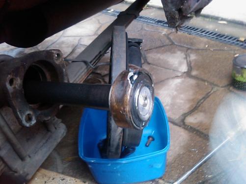

  6. Got a leak and want to figure out the gearbox I'm might have, i have an ae82 4age in my ke55 i think and I'm guessing its the t50 but want to know where i can check, and also I want to find out where the cable or whatever is for the reverse lights as they do not work. i cannot find a cable on gearbox and need them working for the blue slip uhh

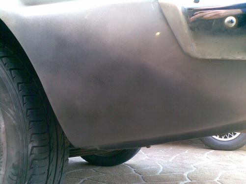

  7. got my rear guards plated, failed blue slip as the car has no chasis, the body is apart of the frame :hmm: or some blah blah, found out something new i guess, hence no bog on that or any of the door :/ but cheering only cost me 400 when it was a bit more work then he expected :happy: and got pipe free with it too which was a bonus, ripped out the carpet for the bloke to fix up some of the tears from when the previous guy broke tailshaft n left tears :S not major but blue picked up on it. once thats done I'm puttin on the new doors and goin for check again. where a hell of alot of rx3's n capella's nxt door to the place too but :worship: the bloke owns himself a ke35 and I'm looking for a bonnet for him to if anyone knows in sydney area if possible

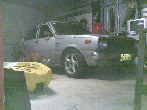

  11. yeh the wheel was gone yep, snapped axle clean haha, had to get a new axle and fix the brakes. Well I needed engineers cert which is done, took out the blocks out n tidy'd up most of the wires..loved it low :fuzz: all I need to do is put it the falcon airbox I'm getting in make a custom centre console at wrk :? some, too easy but i just never remember before wrk. Plus I still have to wait to get the papers for the engineers cert for the blueslip, i can't get pinkslip, i have to get it checked to see if its driveable which it is, good for what it is, i rekon i just need to adjust the gearbox height and yeh bleh had to drill n tap n use slide hammer to get it out, glad my dad had them cause my wrk didnt n i was 1st yr this is her now in the garage playing the hardstyles when I'm bored was keen on buying a silvia or 180sx turbo for a daily but its too close now, n I'm keen on a respray n rims, then putting blocks back in

  14. Thought I might chuck her up, I had her for over a year now. Got her with the 4age, slight adjustments were made :) but meh Had lost of fun a bit too much i say quickly fixed up But she's been pretty sweet since then, been planning to do things lately but trying to get rego again is the main problem right now
