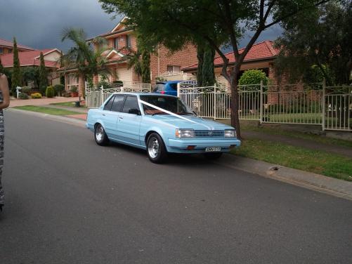

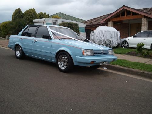

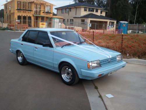

  3. hi all had this 70 for a little while now saved it from a wreckers thats was going to either scrap it or put it up for wreck Started off as a stocka and ended up to this, any opinions how how to make this thing look better just throw them up BODY: nice and stock fresh coat of paint with an orange pin strip to break it up SUSPENSION:all stock except for a few ajps and-ons like camber tops,strut brace,and a nice fat front stabaliser! RUNNING GEAR :drove it around for about a year with the standard 4k than had it removed to make way for the new 5k the 5k was fully striped down after sitting in the shed for 5 years and had a full overhaul ,was ment to be a quik overhaul with a mild cam but blew out to be fully worked runs a knife edged crank, 4AGE pistons, 3k bigport head wich was heavily modified (enlarged valves heavier valve spings ported etc etc)changed to solid lifter set up, big cam twin 40mm side draughts with extracors and a 2 1/2 inch exaust with a dumpy on the ass runs a stock k50 with new clutch with standard diff ROLLING ON:14" steelies wich i had widend and chromed to siut a ke30 i had a few years back but looks tuff on the 70! (IF ANYONE KNOWS WHAT CAR THESE ARE OFF OR WHERE I CAN GET ANOTHER SET FROM GIVE ME A YELL!)
