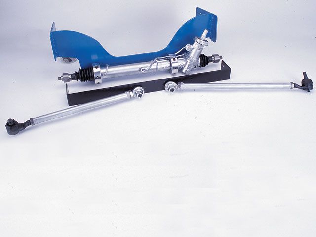

Hello guys, The reason I am here is that my car is in the garage and i have stripped my steering box and drag link and the front x member is off. Yes I am installing a rack and pinion. I have found an expert welder who is ready to fabricate. I know and we all know that we don't have a donor rack the size we want as the width is too small. But I am going to build a center pull rack and pinion with a wider rack like as follows. but to do so I need some exact measurements within the next 2 to 3 days. Measurements A = Distance between LCA inner pivot points = 492.4mm (Credit parrot) B = Distance between tie rod inner pivot points = 410mm (Credit parrot) C = LCA length = 320mm (Credit parrot) D = Perpendicular distance between LCA inner pivot center and tie rod pivot -------- ?? E = Vertical difference in height between inner LCA pivot and inner tie rod pivot = 6mm (Inner tie rod pivot is higher) (Credit Rob KE25) Looking forward to input from all the experts here. Thanks Other info Front Track Width (Wheel Mounting Face to Wheel Mounting Face): 1270mm (Credit styler) Rear Track Width (Wheel Mounting Face to Wheel Mounting Face): 1295mm (Credit styler)
Hi there, What are the options that we have to upgrade a KE20/25 front suspension. 1. Which crossmembers can we use, KE30 or KE70 or KP61?? 2. What are the shortest LCAs that can be used on a KE20?? Are there any shorter than KE70?? I am busy designing a rack & pinion setup for my car. I have installed a starlet rack in but as it is wider therefore bumpsteer issues Temporary fix - Drop the car as much as possible - Less movement less bumpsteer. Currently drives excellent on flat roads with small bumps. . Out of all the crossmembers I have seen, the ke30 looks the easiest swap. My current track width is R LCA + L LCA + Inter LCA distance = 320mm + 320mm + 493mm = 1133mm If I use a KE30 crossmember with KE70 LCAs 300+300+520 = 1120mm (1.3 cm Narrower) OR If I use a KE30 crossmember with KE30 LCAs 310+310+520 = 1140mm (0.7 cm wider) Would any of these be a better start in rack and pinion conversion??
