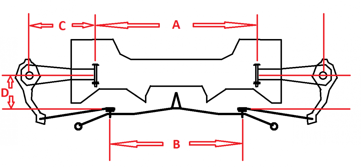

Yes I am installing a rack and pinion. I have found an expert welder who is ready to fabricate. I know and we all know that we don't have a donor rack the size we want as the width is too small. But I am going to build a center pull rack and pinion with a wider rack like as follows.
but to do so I need some exact measurements within the next 2 to 3 days.
Measurements
A = Distance between LCA inner pivot points = 492.4mm (Credit parrot)
B = Distance between tie rod inner pivot points = 410mm (Credit parrot)
C = LCA length = 320mm (Credit parrot)
D = Perpendicular distance between LCA inner pivot center and tie rod pivot -------- ??

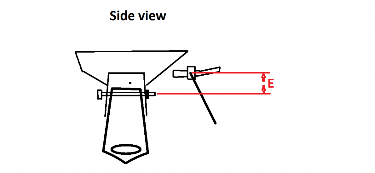

E = Vertical difference in height between inner LCA pivot and inner tie rod pivot = 6mm (Inner tie rod pivot is higher) (Credit Rob KE25)
Looking forward to input from all the experts here.
Thanks

Yeah that's quite a detailed note but it involves a lot of donor parts and not just the rack, and most of the measurements he mentioned are not of the original ke20 steering geometry. With the current idea that I have the only thing needed to be done is the rack fabrication (Not difficult at all), welding it on the x member and getting the steering linked to the rack and presto!! all geometry intact with rack and pinion accuracy! No changes what so ever to the X member mount/location, LCA inner pivots, no camber issues and using same tie rods/steering arms.

Yup have gone through that but its not the original KE20 geometry, its heavily modified. My aim is to maintain the measurements as close or even exact to the original as possible. So that's why I need confirmed measurements off of the original setup.

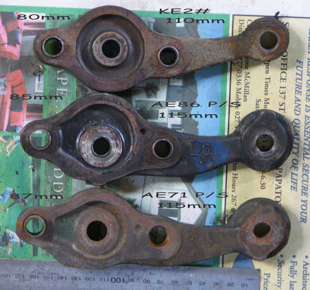

D = Perpendicular distance between LCA inner pivot center and tire rod pivot -------- ??
110mm (If this distance is equal to eye to eye distance on the KE20 steering arm) ??
D = 110mm ( Is this Correct?? )
