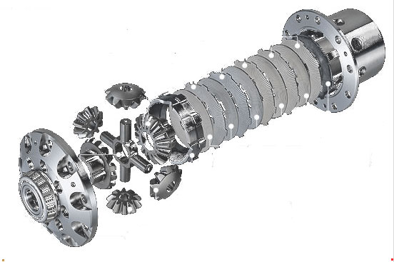

altezzaclub Posted August 26, 2011 Report Share Posted August 26, 2011 could this possibly slip when you don't want it to for example mid slide? Probably... if the inside wheel picks up over a hump it will have less traction and be easier to spin, which will release the locking pressure on the spiders on that side and allow it to spin. But would you notice? It will still be much better than an open diff. "All" we need is someone to machine the top hat in the picture and source or machine the clutch plates so they fit a KE70 BorgWarner. Completely impossible?? Quote Link to comment Share on other sites More sharing options...
